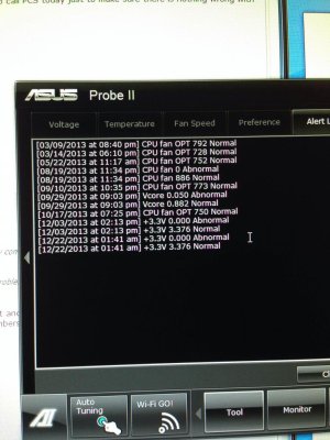

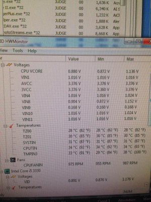

The freezing occured again yesterday and Asus AI suite probe shows a red warning +3.3v, i then check the recording and found it had some abnormalities. Also the mouse seemed to look funny etc. Also when i clicked shut down (im sure i did) the computer turned off...sort of...the screen when off i heard the HDDs turn off but the fans motherboard gpu were still on as shown in the picture this has only happened once and hasnt happened again so i may have pressed the wrong button.
Temps and volts seemed to be ok when i used to check them. But upon checking this yesterday, all does not seem well.

I have attached all the pics I have when the freezing occured yesterday at about 1.40am which is when the +3.3v 0.000v error is shown.

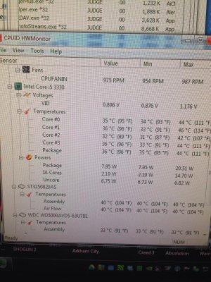

1. Asus monitoring hates everything around itself, so any kind of monitoring program (CPUID HWMonitor, MSI Afterburner, etc.) will make it go crazy, in your case its volts, in mine its temps...
2. photo_3.jpg (4 of 9) shows ur pc could use some cleaning, dust is potentially electrically conductive -> stuff may happen (remember to hold fans with hand to prevent spinning)
3. make sure the fans are easily spinning and not causing any problems
4. electrical noise may also come from Power Supply Unit (?)
5. quick memtest (start -> search -> mdsched) (?)

With regards to dust the dust on the intake is always like that but the computer was gutted and cleaned maybe a couple weeks before this.
I will do a mem test now but got a feeling its definately MB, PSU or GPU
If it is the power supply i have a few years warranty left on it so thats not too bad but ill have to get a spare if it is that. will get the voltmeter out tomorrow and check the +3.3v rail

You say the Asus software told you the +3.3v was bad? Thats the 3.3v rail on the PSU. PSU may be the cause of all this.
yeah maybe, i i will check it with a voltmeter...

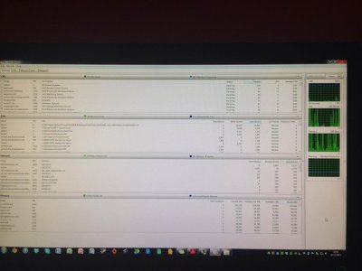

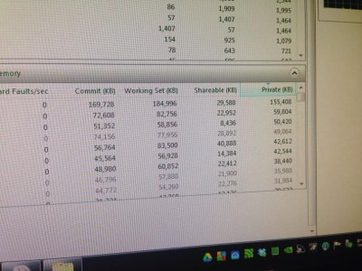

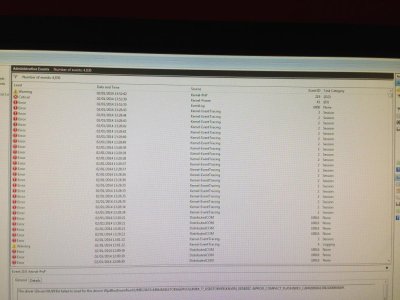

ok just an update on this freezing bollucks. I have not been able to locate my dads voltmeter ill have another look for it today. But my computer literally just froze again but this time the screen stopped and then went white. I was listening to music via itunes and had 3 tabs open on chrome :S i took a quick video which i will post and i have a screen shot of event viewer please help!
this is the video of the crash. if you turn up your speakers u can hear what it does the sound and how the sound changes after a while and also the screenshot of the event viewer.

will do, the video i posted showed a white screen, thats the first time thats happened usually its just on the normal screen. A friend suggested a problem with the USB bus???? i have a 1tb hdd portable always plugged into the computer via USB 3.0 port.
Would unplug it to see if that cures the problem but i doubt that is the case. Could also be a bad cable but then again thats rare as well.
