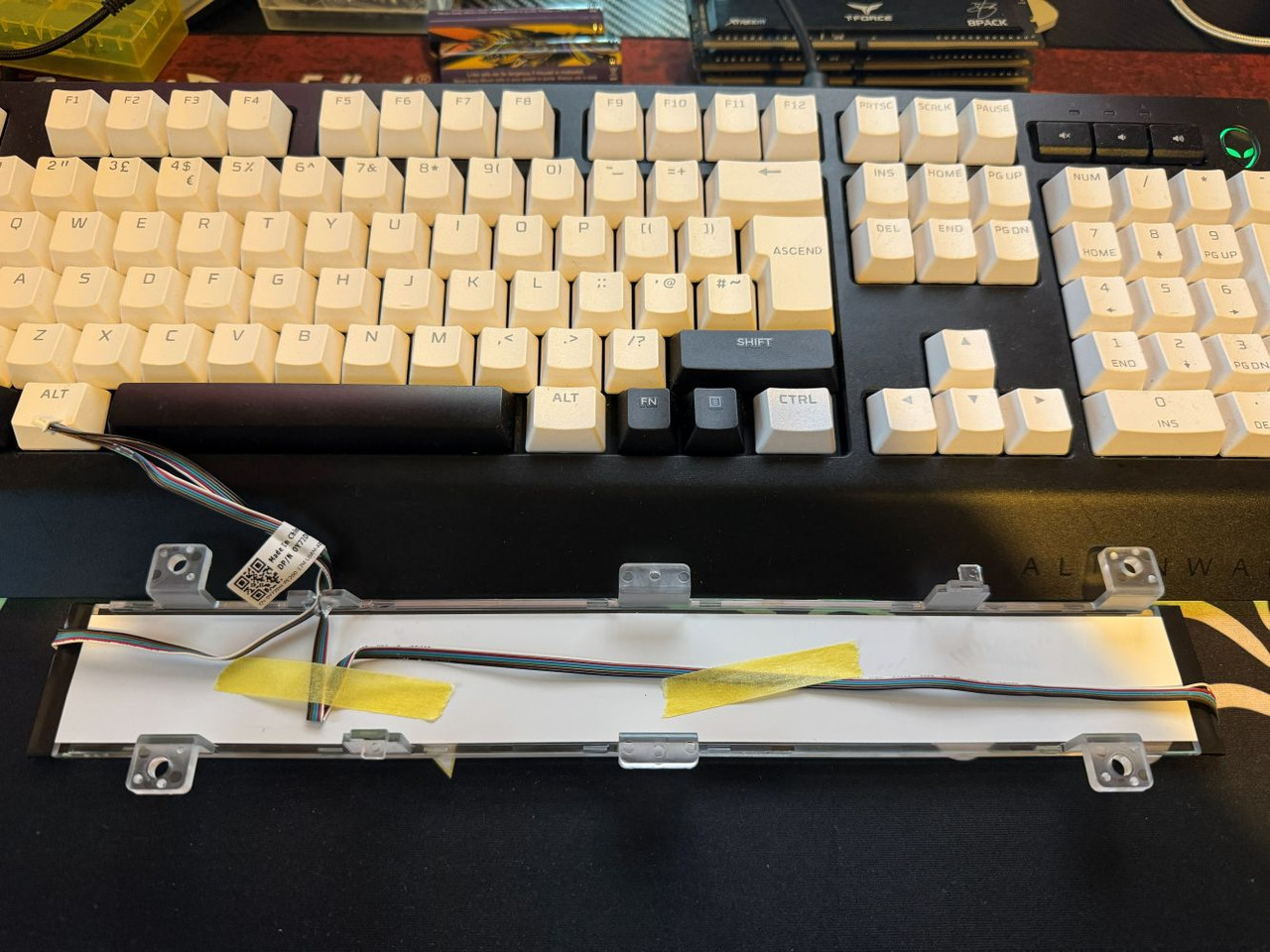

That is it there. To me? that looks like some sort of light panel. And, I reckon the milky white part is just a cover. I reckon I can mod that and put two RGB strips under it. Well, if I don't blow it up first lol.

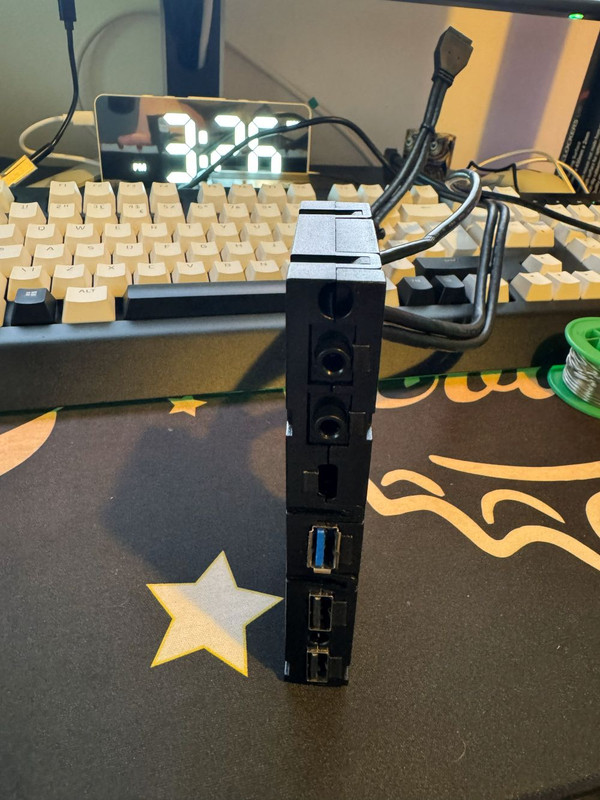

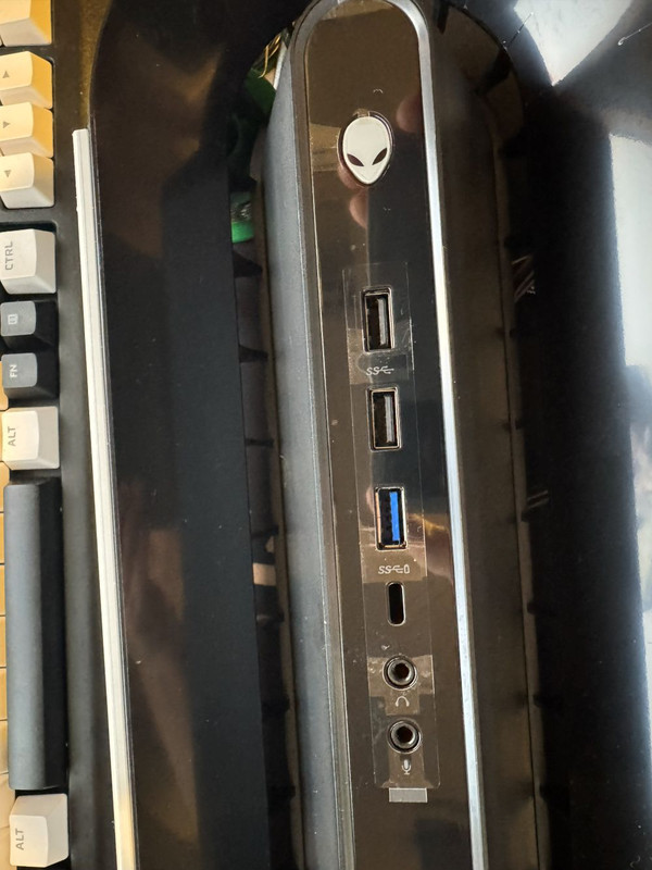

OK. So the front panel is not standard.
The black one is (it is USB 2) the blue one is not. So I ordered this.
And will graft in these for the 3.0
Or these.

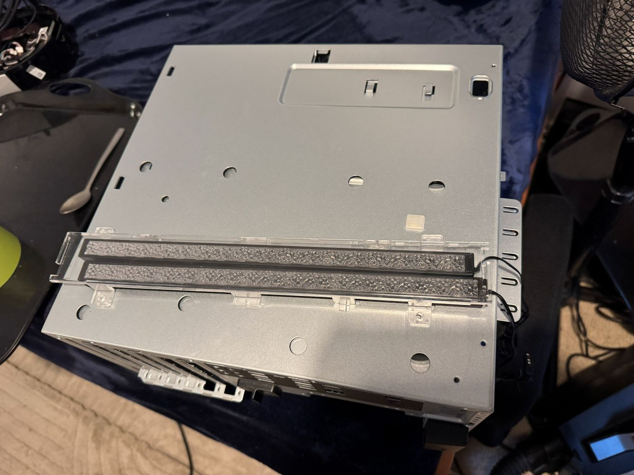

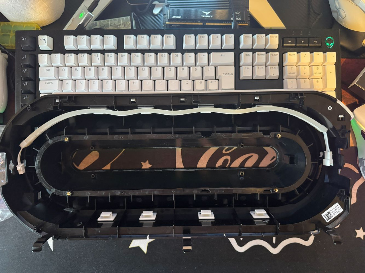

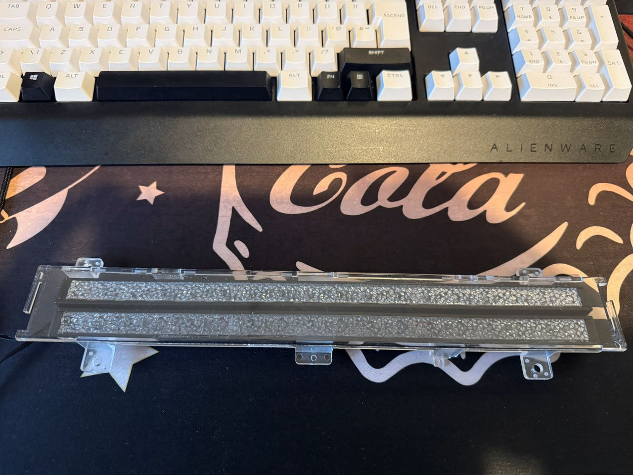

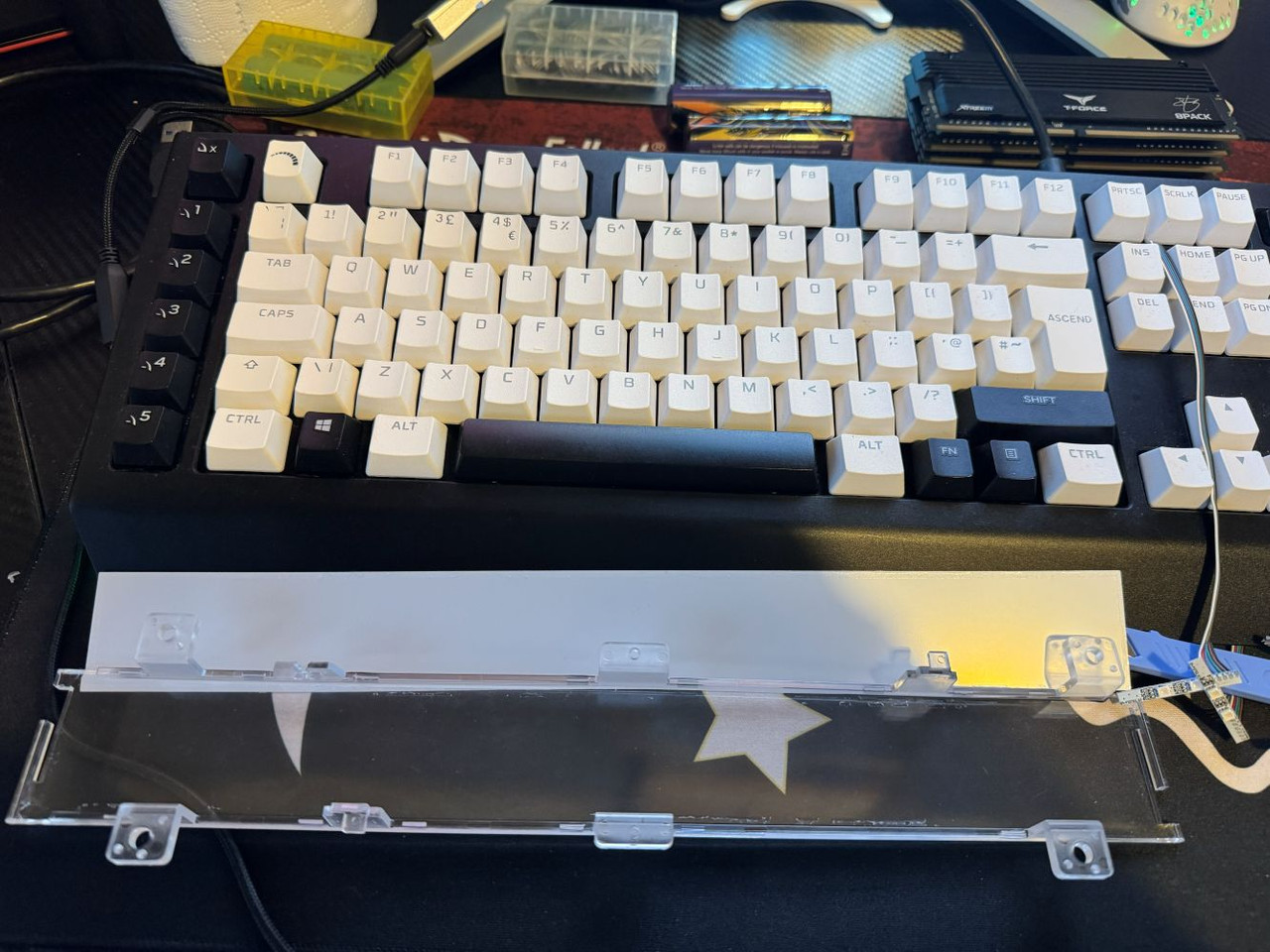

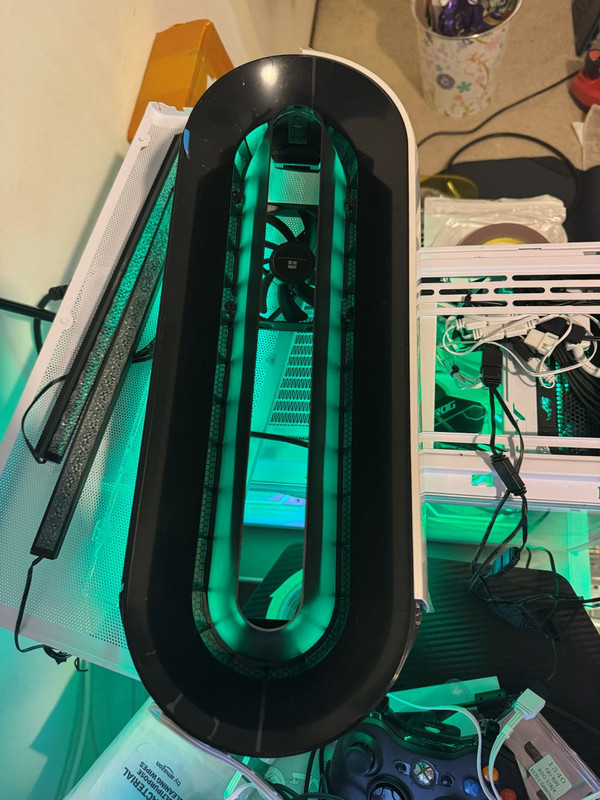

OK so another discovery. The front RGB uses light pipes.
Edit. The panel for the ALIENWARE text also uses those "tron lights" as Alienware call them. It is in the service manual.
Now this took some head scratching. It seems they share the same working principle as Lian Li Strimer V1. IE plastic tubes with a single LED projecting along each one.
So I am going to have to make my own. The black boxes can be 3d printed by a friend of mine, I will then fit these.

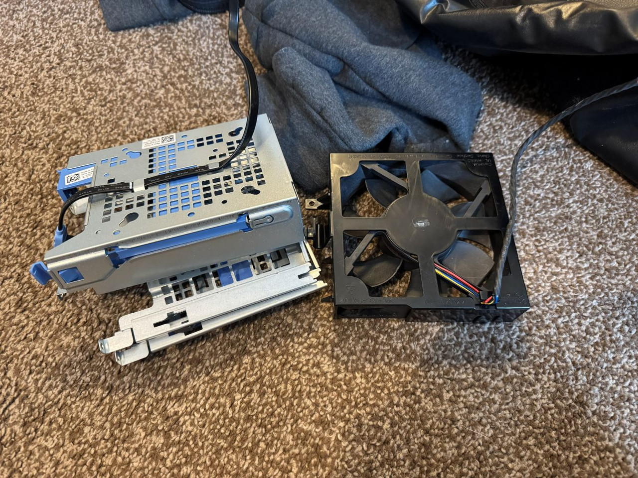

It did catch me off guard though. Like, two of them are wired together and have a RGB connector. I couldn't make head nor tail of it then I realised they must have come with one of the AIOs I bought (probably the one recently I put in the 5090 build) and they do indeed have RGB. Tiny weeny bits.
So the bottom two are the RGB ones. They are all identical, though. Basically I read (I think it was Der8auer who said it) that they are exactly the same as EK Vardar fans. Made in the same place and everything. I then have another one which will be fitted to the side panel where the GPU vent is, and a reverse flow RGB fan for the AIO which will be the pull fan and be visible through the roof vents. The two RGB ones are going to be the intakes in the front, and there is already one of the plain non RGB ones fitted to the cooler (I did that earlier).
So yeah, these fans are pretty butch so I don't see them having problems bringing in air.

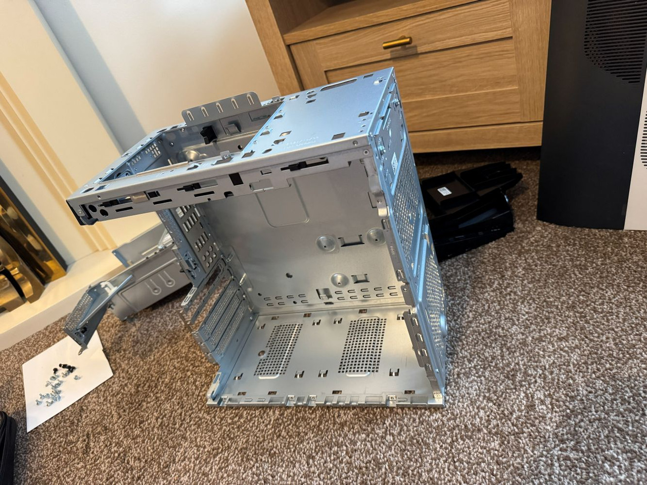

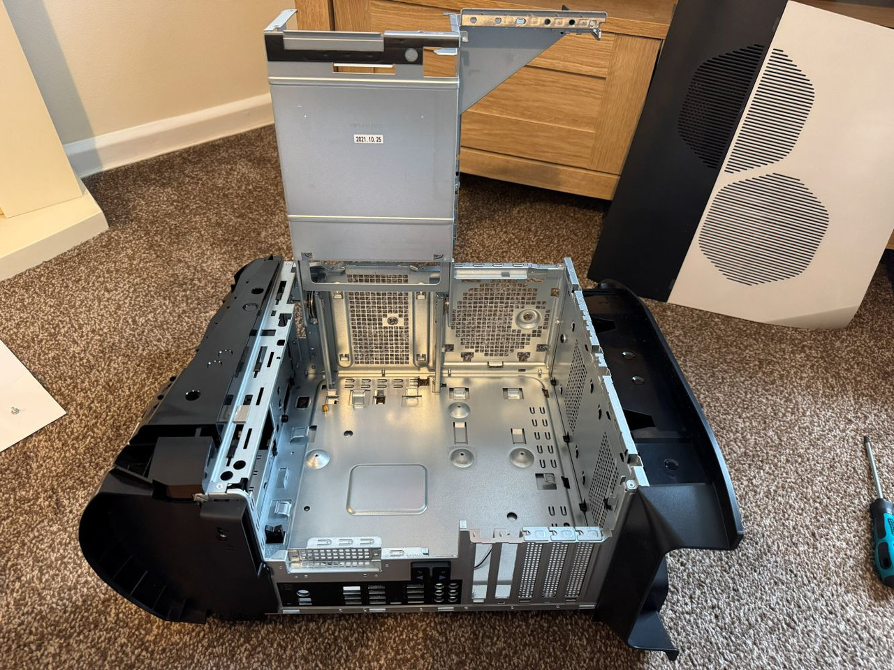

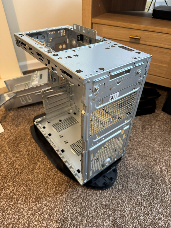

I also need to get a bit rough with the case. As it sits the GPU won't even fit. There is well over an inch of space inside the plastic nose cone though, so I am going to remove the metal in that area. Will make it far better for cooling, too. Again I have an idea for cooling potential, but better just to do it and show it in pics rather than going on about it.

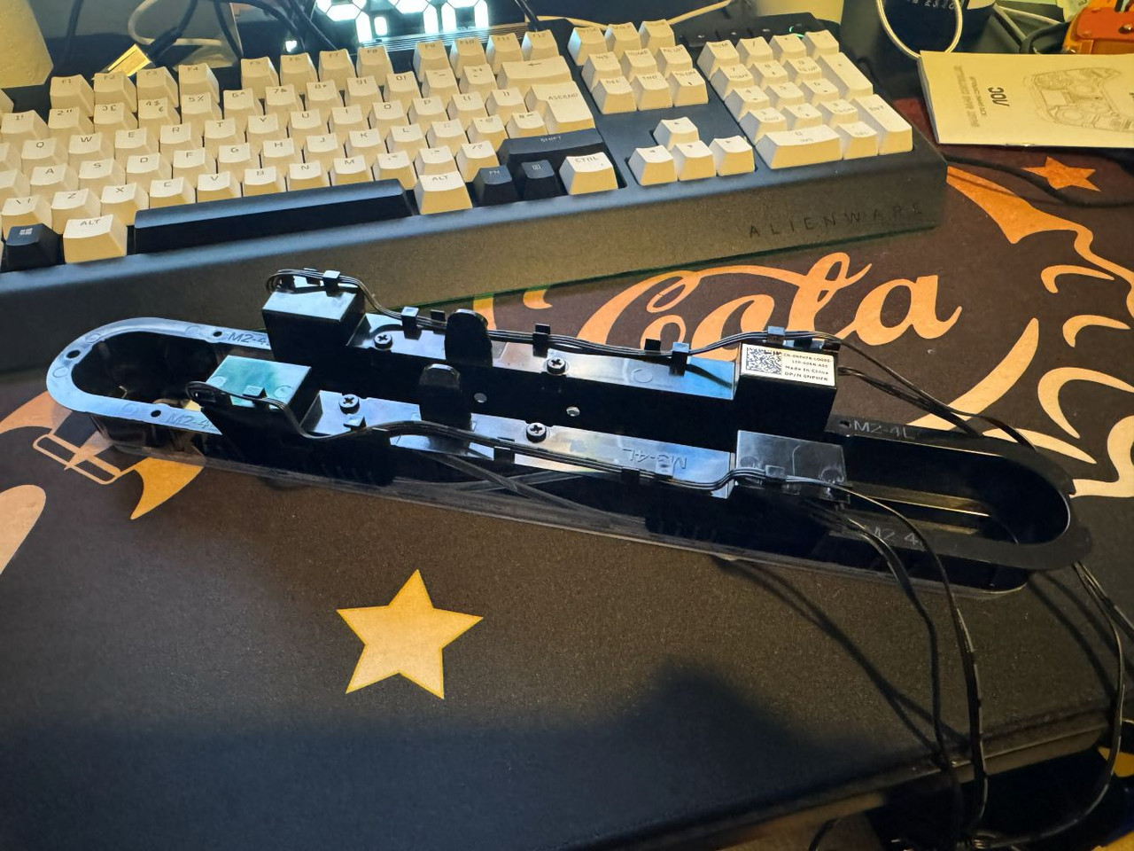

And then this. This will be the harness for the front light tube LEDs.
And the last of it.
OK this is the contact frame.

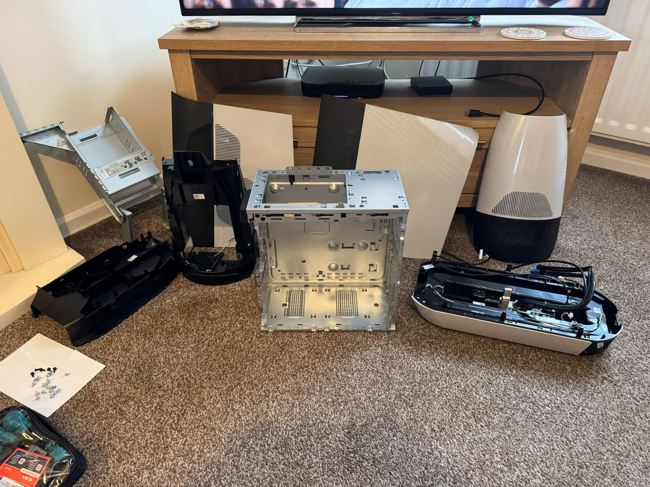

And then various states of undress.
Before.

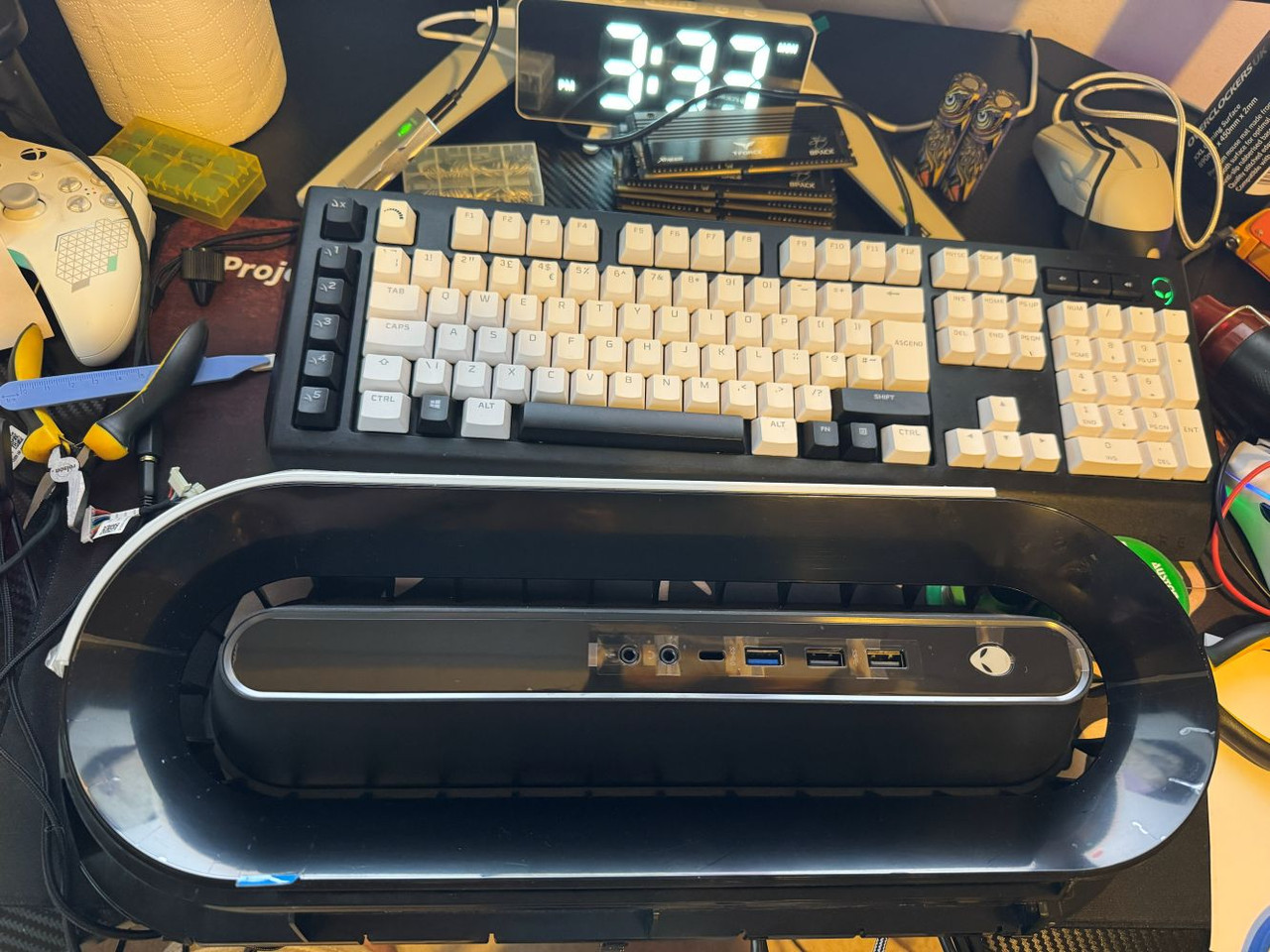

Marking and cutting tomorrow. It is amazing how tiny the actual shell is.
*cut snip peel rip*. Wait wut?
lmao. Tight buggers !!! And t'other end.
Et violin.

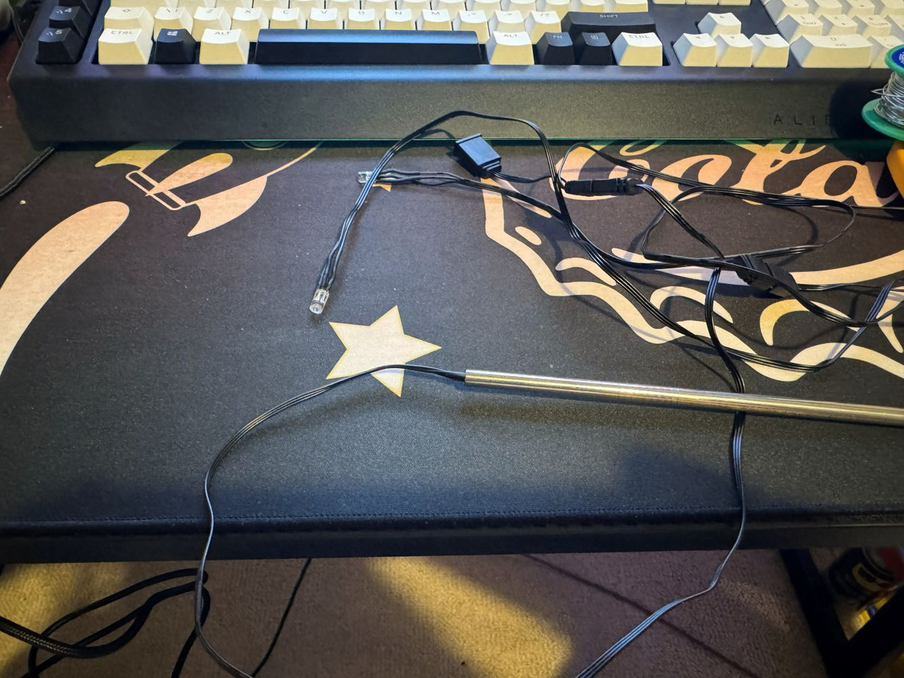

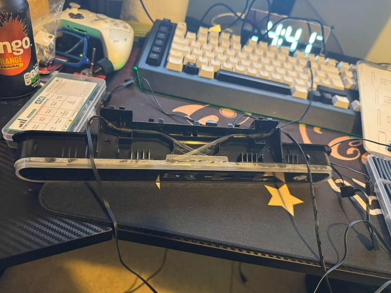

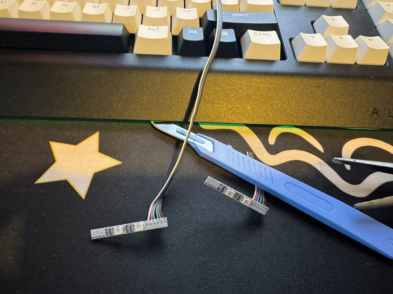

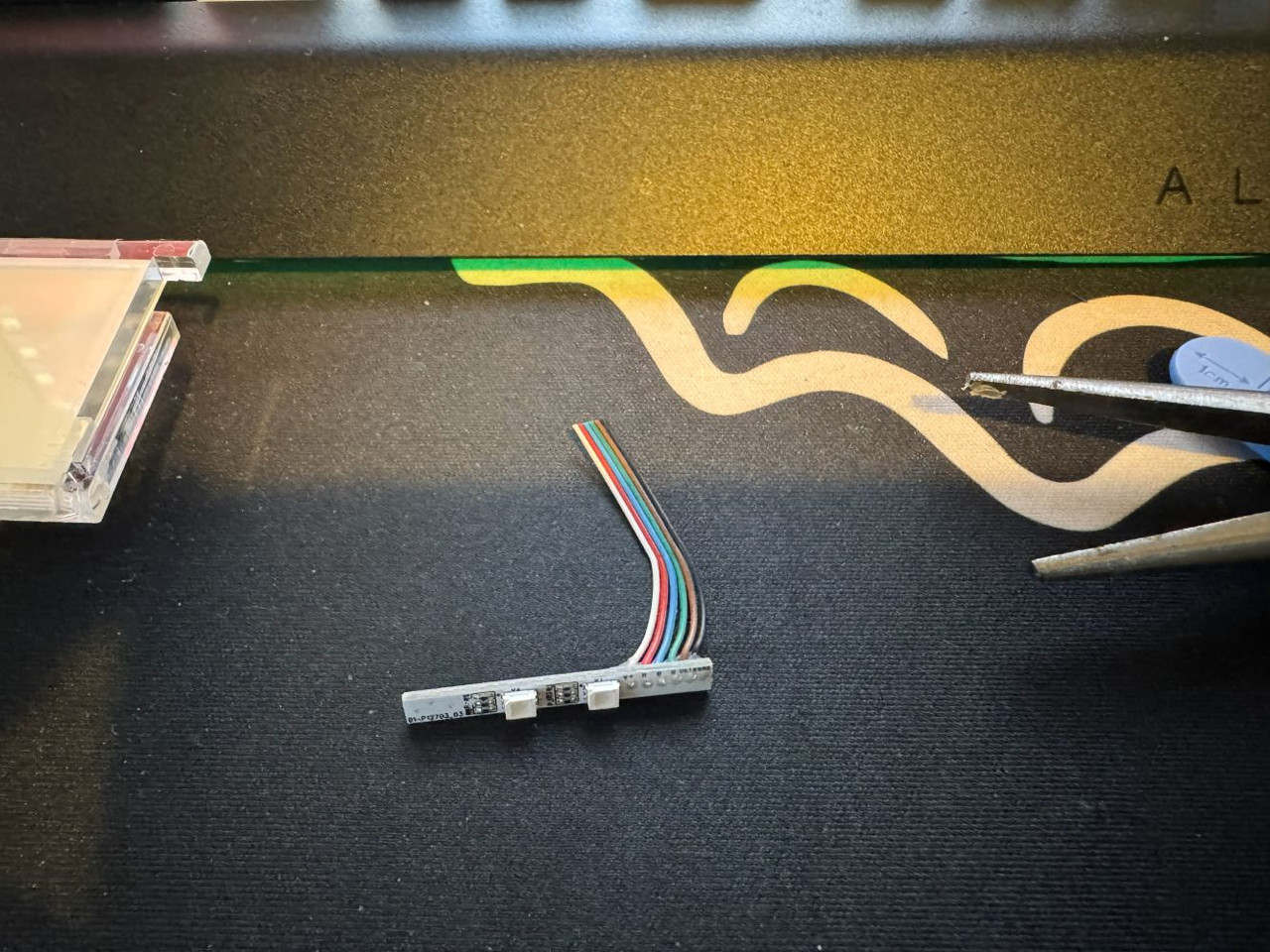

If you look very carefully you can see a pinout. It is indeed 12v non addressable boo. So we will fix that !
OK so there may be a part two to today, we will see. First up I made sure the RGB things I bought would fit. They would not, then I peeled off the useless magnets. Then they fit.
Test on the case. I will glue them to the chassis.
OK so that is mostly done. I won't know if I need to diffuse them until I test them. So then it was onto the front.

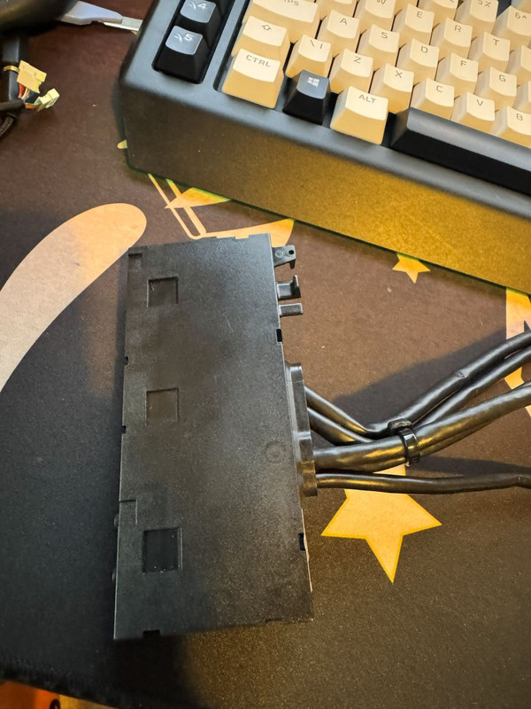

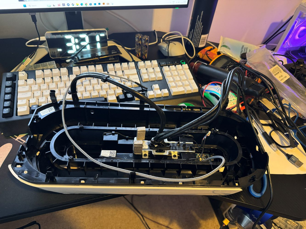

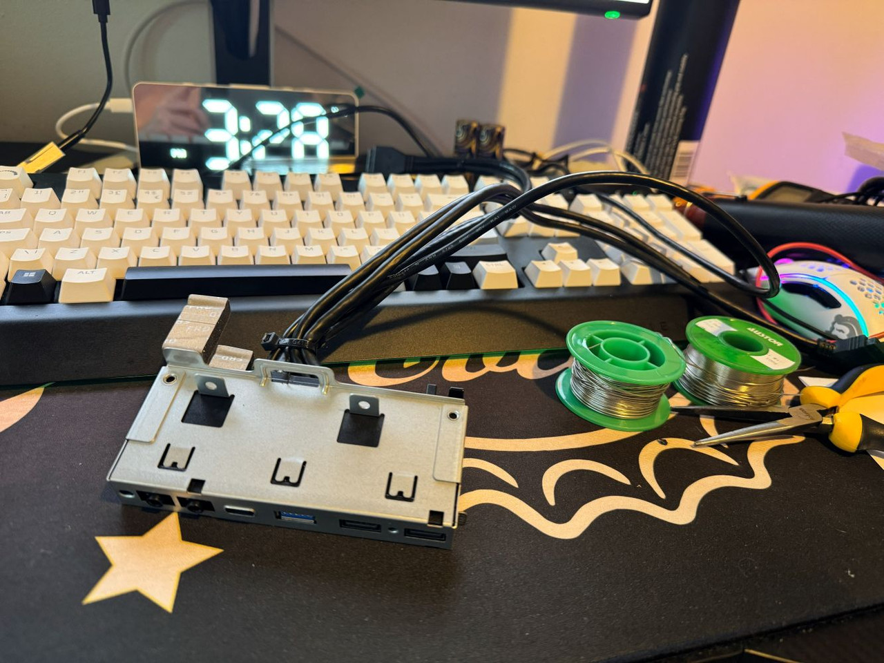

I soldered in a power button cable (you will see it later) then took apart the IO part. I then carved down a socket to fit, and.
Another job done then.
I then put it all back together for now. Mostly as getting to the tron lights involves picks etc. It's not easy.
Lines up beautifully. I didn't even have to glue it into the box.
So here is the new power switch cable. I soldered it onto the switch itself. GOD it was fiddly and I could not see what I was doing but I got there eventually.
OK solder, bugger two up, do them again etc etc. One looks dim because Starry Night.

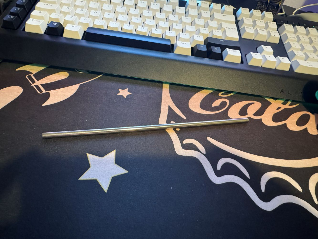

So what was this terribly clever idea I had? well, yesterday when I was making a coffee I noticed these things. Asked mum what they were and after showing her one she said "Stainless steel straws..... That I never used".
And what would you know, if you shove the LED in (nice push fit)
You get your joiner come light boxes free, with just some cutting.

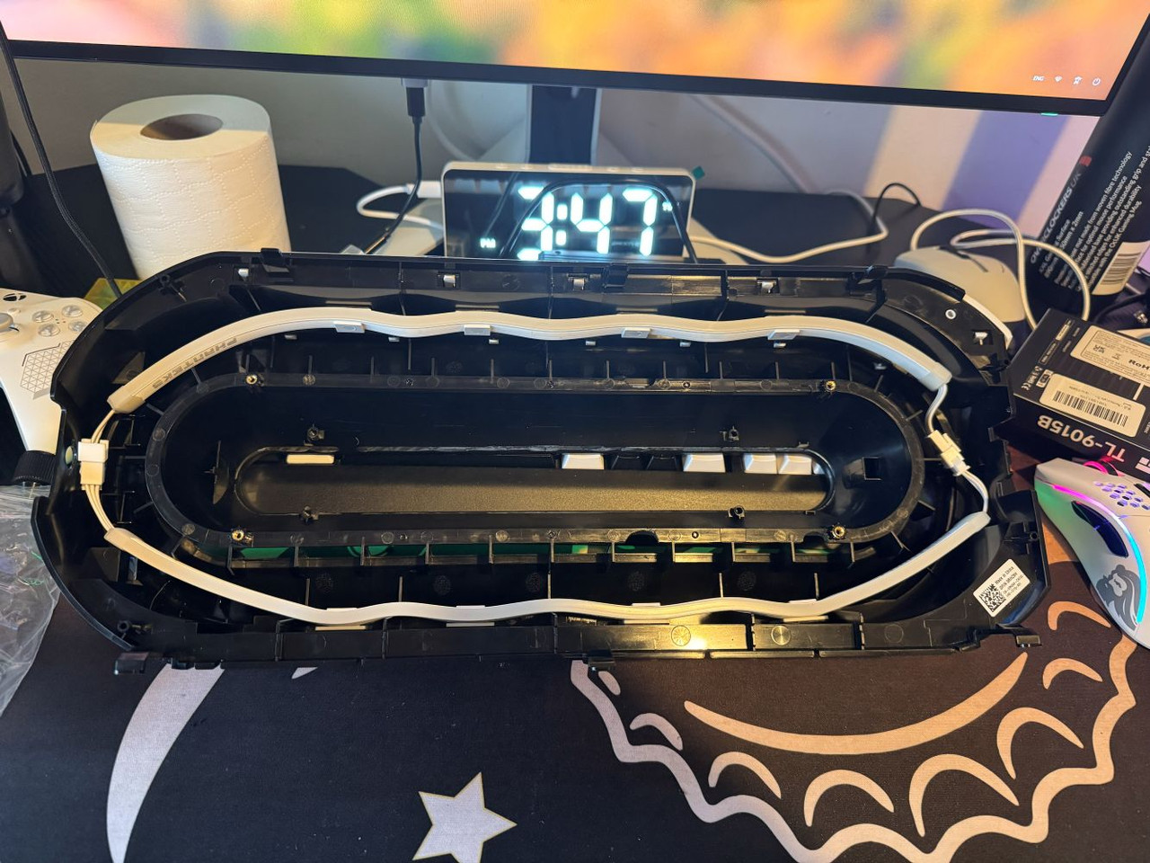

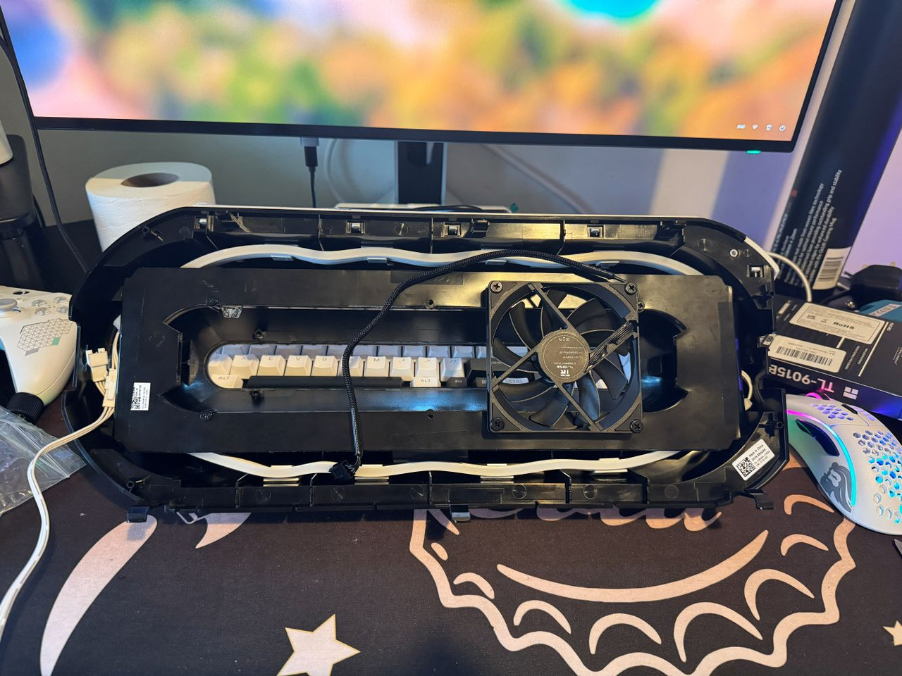

OK so for today's "Round One" I began sorting the front in a final form. First up was fitting the neon holders and neons.
And then the modded honeycomb panel.
It's a 92mm fan. Not quite enough room in there for a 120. I also realised I have no chance of getting the PLED wired. It is micro tiny like 2mm. So I bought some wired ones. White, as I wanted.

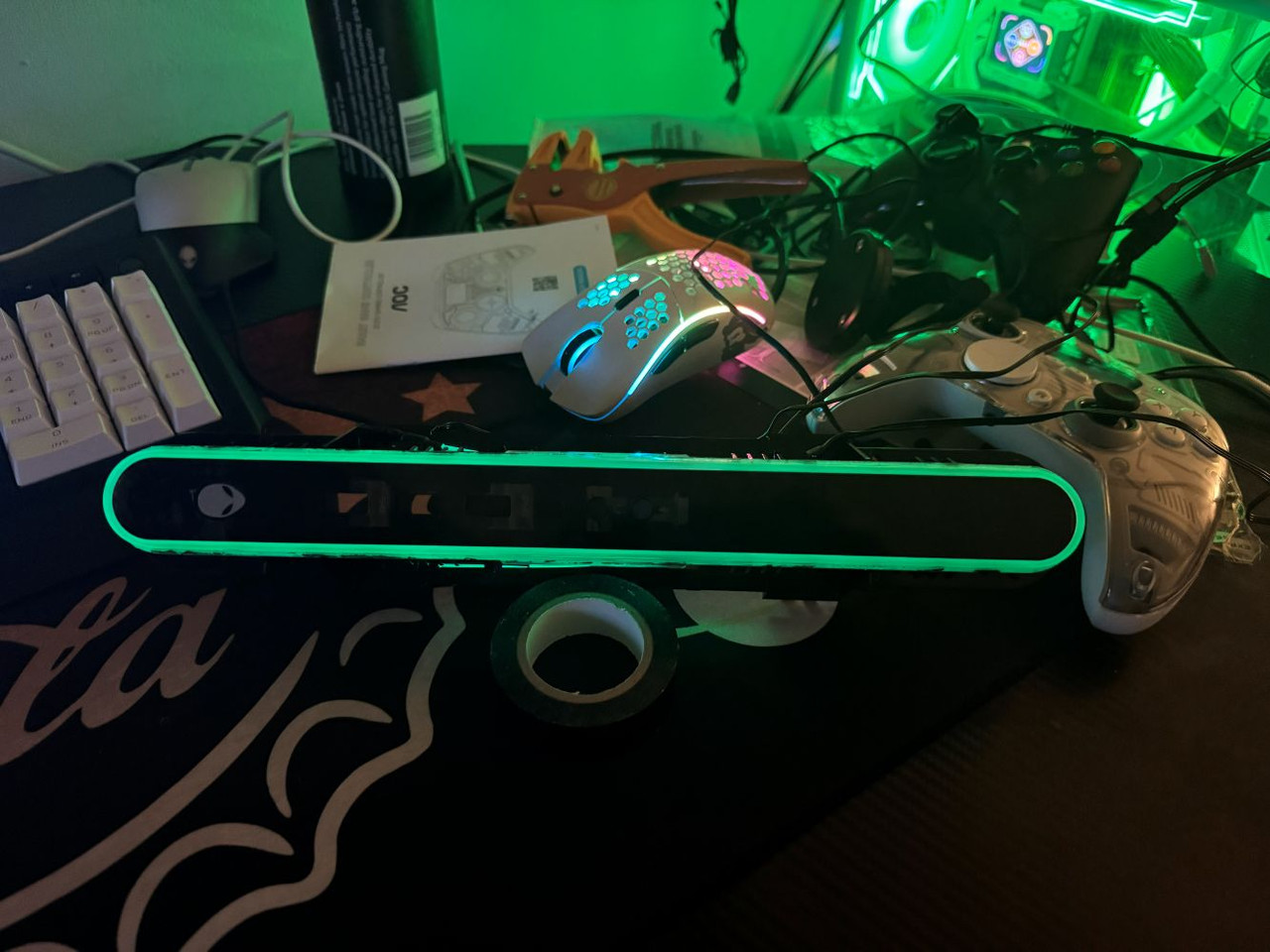

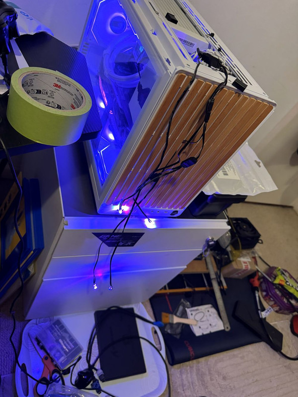

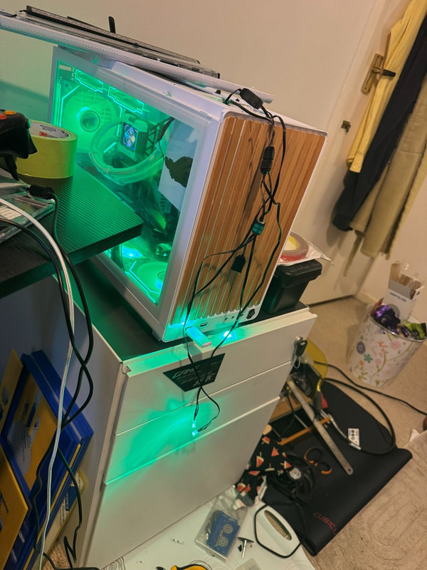

OK so more work done. First a last solid colour test on the LEDs before they are permanent.
Reet, in you go.
I then tested the neons.
Before finally....
Stoked. Whilst it has been a real pee-er that is deffo rewarding. No one has gotten those working with after market hardware before.

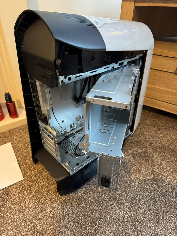

OK mega update !
I got it down around 7pm last night. Put it back into one piece.
Fit the PSU
Fit motherboard and cooler.

Mount top intake fan.
Just a quick note here. The 92mm fan has to come out. The GPU is bigger than it says it is. It does fit, but not with the fan, and it comes out of the front of the metal as I suspected it would.
