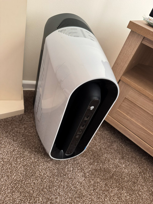

So after the triad triangular case for the first time in 10 years I started using other cases. I have never, though, owned one of the new Aurora cases. Well, until now. The white one for me is absolutely gorgeous. Just recently I got quite bored of the PC at mum's (this one)
It is a bit "clinic like". So, as we do I was on Ebay last night and found a Aurora chassis BNIB. Only it was in the USA, so by the time I get it I will be out about £135. I don't think that is too bad though tbh. This is it here. I will actually like not being distracted by the light show as I game.
Now look, I know it is subjective but I have never seen an Alienware case design I do not like. Apart from the new ones that look like any other PC.
Any way, given how "nice" Dell had been for many years I figured this would be a simple case swap. Seems I was completely wrong ! The first thing I realised is that the IO shield is not removable.
Which is kinda Apple like but look we can deal with that. They even left us a nice template to cut out. However, this was when I started to notice oddities. First up there are two USB 3 connectors.
OK not a problem I can get around that by using this.
Then, however, I spotted this.
And was like "WTF is that?". I soon got my answer when I downloaded a pic of the board that comes in the case.
See it? LED con. You'll never guess what? no one has decoded that block into a pinout. Nobody. In fact, when users have a board failure (which is very common on the boards Alienware did not fit any VRM coolers to) they naturally swap out of this case not back in. Hence the irony. Some complete wally wants to swap stuff INTO this case, not out.

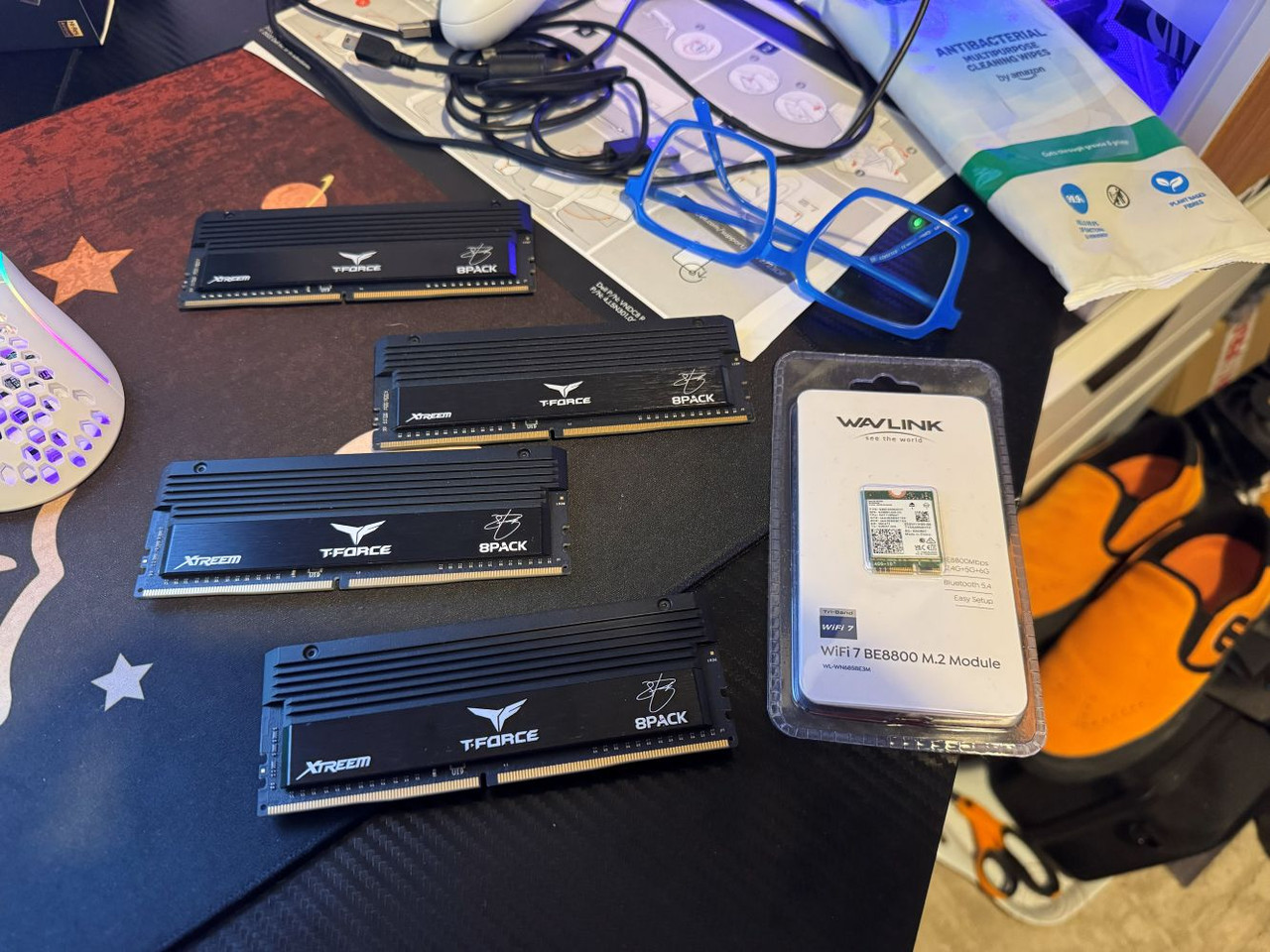

I will also be using my 4x8gb kits of 8 pack DDR4. Mostly as one set is DDR4 4000 with tight timings and the other set is 4133. I had these running for about two years at 4000 in my 12700K machine and they worked flawlessly.

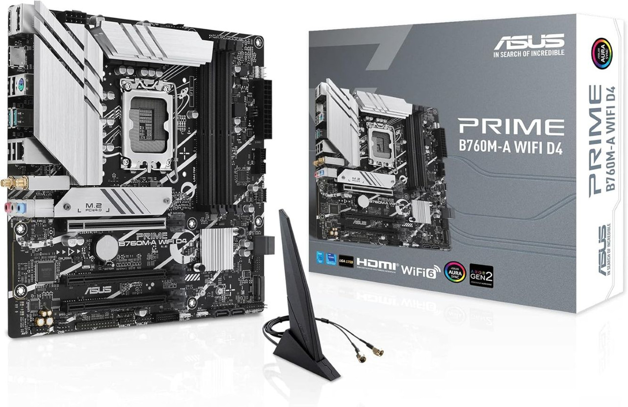

Just recently I bought a brand new 14600KF that was going to go in my 5090 build. However, I changed direction and went for the 245k to save some power. As such I have a brand new in box 14600KF. Whilst the 5700X3D is great for gaming it lacks for design etc. I would imagine it is the clock speed. I do have an almost new B760 Strix ITX but it is DDR5 and yeah. Not happening.
So, I hunted down this.
It's not just cores. I need more sockets etc. In a PC that will be mostly for productivity I miss having slots etc. So the obligatory..
And sorted. Am going to try my 8 pack DDR4 4000 4x8 and see how that works.
