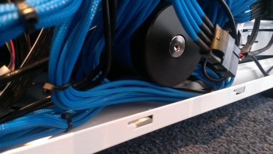

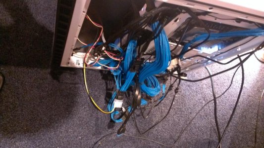

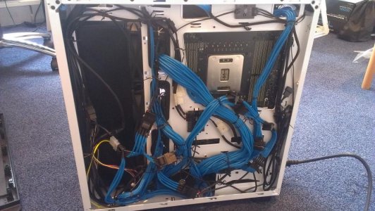

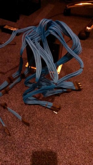

Putting in the cables was a pain, due to the complete lack of space for them. They go either side of the pump/res, pushed right up against it. I spent half a day or so just trying to get the cables tidy and neat enough so I could get the back panel on. Getting the back panel on was a tough one alright! A small down point for this case is the space behind the MB panel and the back door panel isn't too much (plus when you factor in the sound proofing foam on the door, there really isn't much space).
The cables that needed to fit in!
What the back first looked like when all the cables were initially installed.
My cable management...

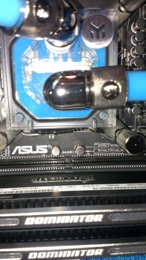

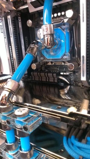

The CPU block seems to be the place for air bubbles to collect. I've been rotating the case for a couple days now to try and shift them, but more just collect there. One day I might get the CPU clear of air :P

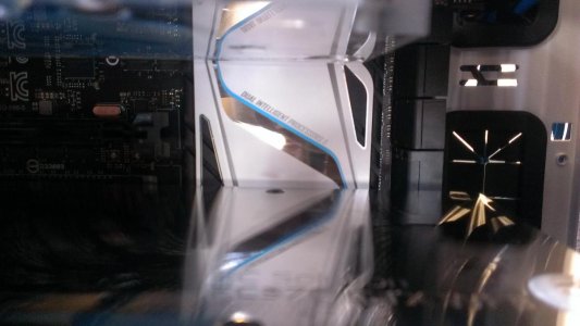

The picture makes the CPU look 'over lit'. It isn't, that's just the picture.

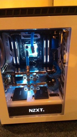

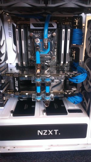

Overall build without window panel on.

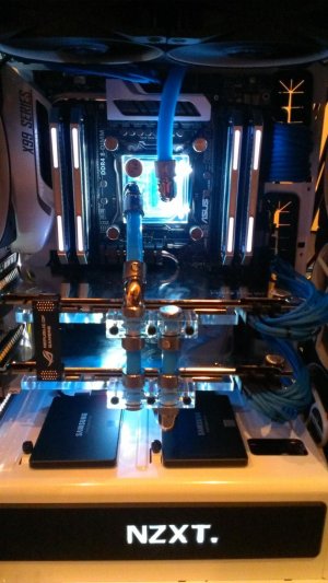

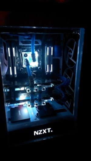

Arty snap :) Shame I can't actually see the GPU block design from my desk seat :(

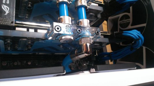

SLI connections. The clear plexi GPU terminals were worth it.

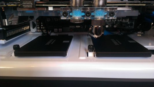

The 2 Samsung 850 EVOs in RAID 0... how long before I replace them with NVME drives?!?

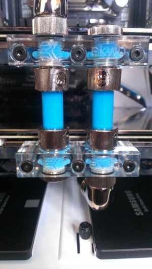

Connections between the two rads. I really like the EK badges on the plugs.

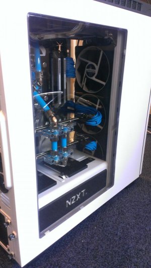

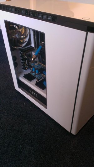

Some angles from the outside with all the case panels on.

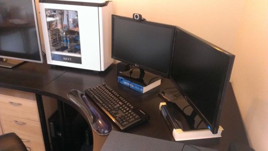

The current desk setup... Going to get a 1440 gsync monitor to run with my existing 1080p ones. Still need to get a multi-monitor mounting arm.
