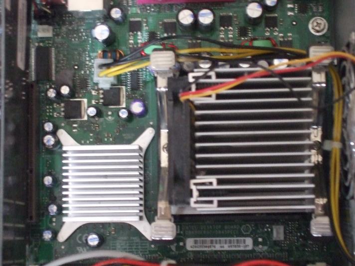

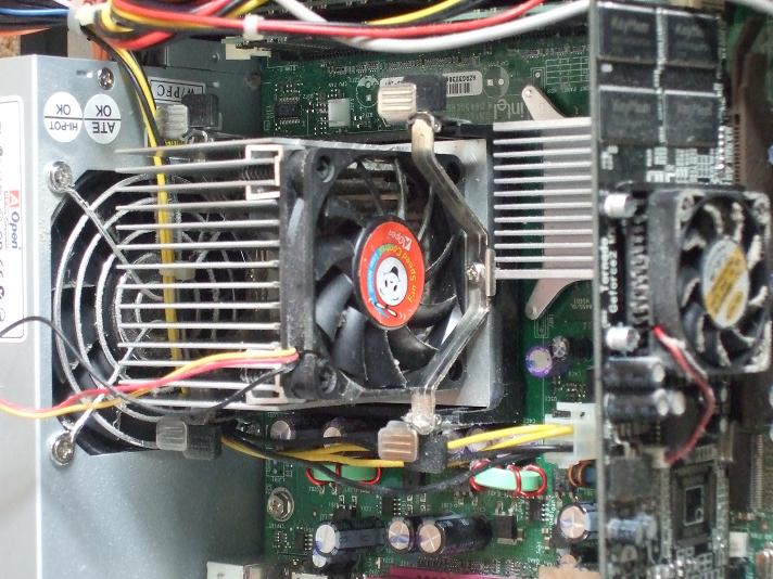

Hi,
Good idea! Here are a couple of pics,
They show the heatsink straight on, and one from the side to show the air flow. I guess what i'm looking for is a heatsink like this, but with more effiecient fin design so it can house a 60x60x25mm fan rather than the super-slim 60x60x10mm I have at the moment?
The heatsink (including fan) dimensions are about 65x65x65mm
