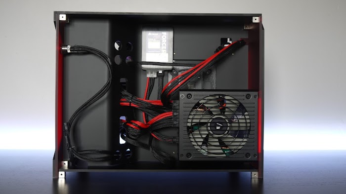

This is how most people fit drives, if you want something special and have plans on paper or CAD the guys at Parvum Systems will build you what you want.

A picture speaks a thousand words. I am looking into getting a M-atx case for my next build. I really like the look of the case and love in the inlays. I ask them about maybe custom holes as there is plenty of space back there. I thinking of getting triple 2.5 inch mounts.
Thanks for the picture

Just remember that the PSU occupies a lot more of the rear section than you think it does. Not just that it sits 12mm off the ground but also you need room for cables. The standard HDD mount hangs down 17mm from the inside of the roof panel so that big open space above the PSU quicky gets eaten into. It's still big enough to get 3x 2.5's in no problem but if you (or you ask parvum to) come up with a solution it will take a little time and thought to get it super neat. I stuck my SSD to the back of the motherboard tray just because it made cabling nice and it looked really clean.
That gives you a better impression of what room is left. That's as little cables as you can physically get away with too.
JR
Thanks for pics.
