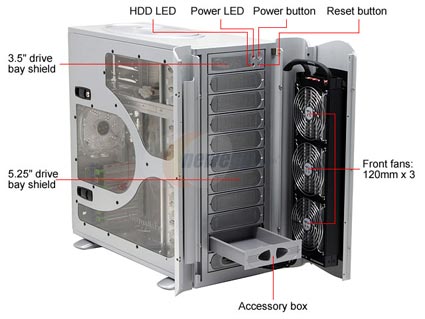

Case at the moment is
Thermaltake Kandalf Silver:
How good is that case for cooling? Is there a front mounted 120mm fan? I see there's only one exhaust on the back, might be worth looking into improving the airflow. Can you tell us what the temps are like with the side off?

Temps are exactly the same mate, the case is really open, infact I heard it's 60% opened with hole and vents. This is the front

OK, well the short of it is, you've got a decent heatsink, I'm assuming you have the notua fan still, which is great, so the weak point, assuming the heatsink is mounted correctly with not too much thermal paste (?), would be your case airflow. In the OP you mention you only have one fan installed in the case, I assume this is the rear exhaust. You should put one or two front fans in, and possibly a top or side if available.
I decided to take control of my case cooling (P182SE), so I ripped out the Antec fans and bought a second hand Zalman ZM-MFC1+ and four Yate Loon D12SL-12 fans.
Airflow is better, the case can be quieter when I want it too. I'd start with one or two more 120mm case fans and see how your temps improve.
