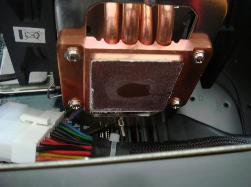

My 940 oc @ 3.3ghz (it's summer and I don't want to be a spotty kid due to sauna temps) was sitting at 48c idle. After looking around I concluded this is a bit pants. Stock AMD coolers do 42-45 on this CPU idle without an overclock so I would say the Noctua wasn't performing any better than a stock cooler. Not good, especially as it had two fans on. It was only when I took the Noctua off that I realised what had happened.
Look at the CPU.
WTF? When I turned the cooler over I noticed this.
I don't even remember having white thermal paste. Then it dawned on me. A few months ago I did a job for some one and they had brought an OEM CPU. They gave me the CPU, HSF and some crap thermal compound. I use this stuff
So in my haste to get my Noctua on I must have used the wrong stuff. I can't believe I didn't realise. My CPU had burned a clean hole in the cheap thermal grease :o

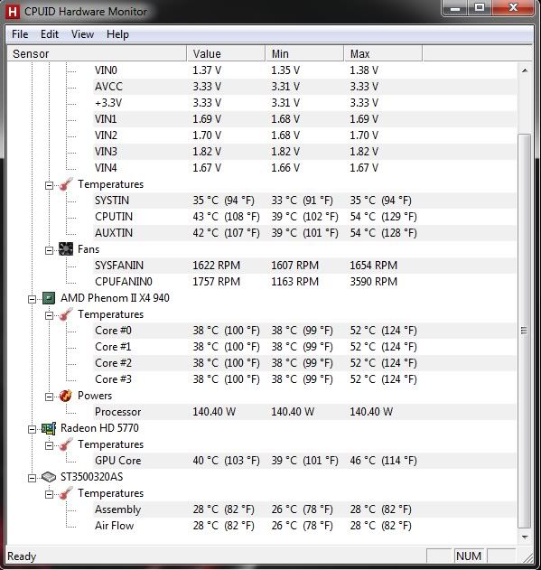

After putting a nice dollop on the CPU and reseating the Noctua I now get this.
Which is still not uber but is 10c lower than before. When I run Prime95 I hit 51 at max which I am impressed with. Fair play I guess. Not the best cooler on the planet but still does a decent job. Gotta say though, it was chuffing brilliant on my E4500 C2D. Stable OC to 2.9ghz and idled at 35c. But, there were two less cores to contend with.

Mine was auto setting 1.35 and hitting 1.38 before so I set it to 1.32 and it's now about as it should be. Temps haven't changed though. Prime hits 53c now (PC has been on for a couple of hours) as a max temp and it's idling between 40 and 42.
