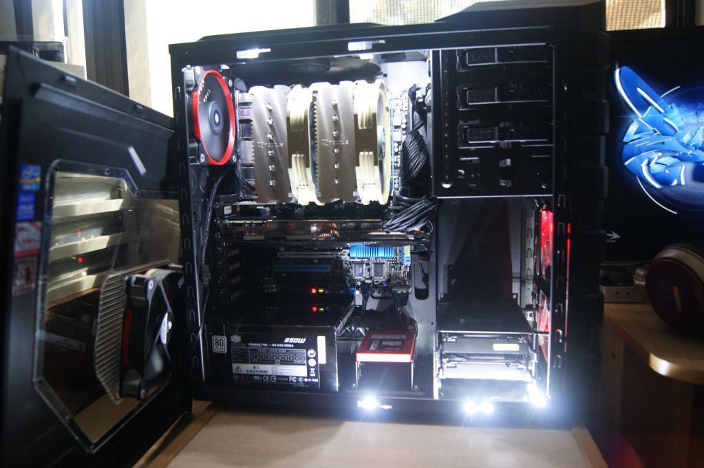

So I will try keep this short and sweet.
I have the following installed into my case.
1x Noctua NF-P12 installed in the rear of my case & 1x Noctua NF-P14 FLX in the side of my case as a intake.
I am thinking of replacing them with 1x Corsair AF120 Quiet edition & 1x Corsair AF140 Quiet edition.
So the question is does anyone have any first hand experience with these Corsair fans? Are they an equal match to the Noctua's?
Because on paper the 120mm is way behind in CFM at the same noise level & the 140mm flows a little but at 5 dB louder.
I really like the look of the Corsair's but I would rather paint the Noctua's black than put a lesser fan in to replace it. The change is due to visual's not Air flow or noise.

Ohh I never updated this I did end up getting a AF120 & AF140 Silent editions and they only flowed a tiny bit less air than the Noctua's but are quiter. Very Happy with them and they look the part
