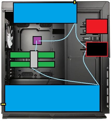

hello everyone,
i read the faq and watched the vids on the phanteks enthoo primo...and am pretty much decided on this case for this build
here's the hardware:
Case: Phanteks Enthoo Primo Aluminum ATX Full Tower Case
Motherboard: Asus Rampage V Extreme
CPU: i7-5930k
RAM: Corsair Dominator Platinum DDR4-3000 16GB (4 x 4GB)
PSU: Corsair AX1200i
GPU: x2 Asus GTX 980 (2-way SLI)
Storage: Samsung XP941 256GB M.2 SSD (boot), Samsung 850 Pro 1TB SSD
Optical: Archgon Blu-Ray/DVD/CD Writer
Case Fans: replace supplied front intake and rear exhaust 140mm with x3 BitFenix Spectre Pro 140mm Fan - Red LED (BFF-LPRO-14025R-RP)
Multi Control: Asus ROG Front Base Dual-Bay Gaming Panel
for water-cooling, these are my initial ideas:
Radiator (top exhaust): Alphacool NexXxoS XT45 Full Copper Triple 120mm
Radiator (bottom intake): Alphacool NexXxoS UT60 Full Copper Quad 120mm
Reservoir/Pump: Monsoon Series Two Premium D5 / MCP655 Dual Bay Reservoir w/Quick Change LED Control - Matte Black w/Red Trim (pump: Swiftech MCP655-PWM)
CPU Block: EK Supremacy EVO Universal CPU Liquid Cooling Block - Gold (EK-Supremacy EVO - Gold)
GPU Block(s): x2 EK Geforce GTX 980 VGA Liquid Cooling Block - Acrylic (EK-FC980 GTX) *might go evga hydro copper
Tubing: PrimoChill PrimoFlex Advanced LRT Tubing 3/8"ID x 5/8" OD - 10ft Retail Pack - Bloodshed Red (PFLEXA10-58-R) w/ Free Sys Prep
Fittings: All Bitspower Rotary Compression (wherever possible)
Fans (all in push/pull): x14 Noiseblocker NB-eLoop B12-P 120mmx25mm Ultra Silent Bionic Blade PWM Fan - 800 - 2000 RPM
Fan PWM Splitter (1 to CPU_Fan Header, 1 to CPU_OPT Header): x2 Swiftech 8-Way PWM Cable Splitter - SATA Power (8W-PWM-SPL-ST)
Misc: x3 Phobya G1/4 Inline Temp Sensor Coupler - 2-Pin - Black (2nd GPU outflow, both rads outflow), PrimoChill Anti-Kink Coils - 5/8" OD Tubing - Black, x2 XSPC 4 x 120mm Radiator Gasket - 3mm, x2 XSPC 3 x 120mm Radiator Gasket - 3mm, PrimoChill Hex 2-Layer Rad Grillz - Triple 120mm - Red / Black , PrimoChill Hex 2-Layer Rad Grillz - Quad 120mm - Red / Black, assorted LEDs in UV and red (tailed and 8" bars) for CPU/GPU block lighting and case lighting, respectively
my thinking goes like this:
1. all ssd for storage, so all drive cages removed
2. will need all 5.25" bays
3. i want both top and bottom rads' ports facing the front of the case
4. i want a minimum amount of tubing visible through side panel
5. i chose a 360mm rad for the top because i don't want any interference with the 5.25" bays and i'd like to use one of the upper ports on the end tanks to double as a fill point
6. i want the 7th port on the bottom rad to face the back of the case so that i can put a drain valve sticking through the grill of the optional psu vent
7. i realize that the rog front panel's knob sticks out ~12mm and the door clearance is less than 5mm, so i plan to drill out a recess in the back of the door panel to accommodate the knob
8. rotary compression fittings (angled, if needed) are for ease is install/dismantle and to minimize torque on components
9. rad grills are just for aesthetic reasons, as the stark white of the e-loop fans kinda throws off the red/black theme - but i'm not sure of their width...guess they need to be less than 125mm to fit past that side panel on the 480mm rad - i think the grill on the top rad should be ok
10. rad gaskets are for a better seal, some vibration dampening, and also because i've read that the e-loop's hub can press onto a rad and stop its spinning...so a little spacer should fix it
from what i've read, loop order doesn't really matter...and with that assumption, i'm planning bay res/pump > top rad > CPU > GPUs > bottom rad > bay res/pump
would really appreciate any advice, feedback, and/or criticisms

oh, just for a visual reference of my ideas...here i'll wow you with my uber paint skillz :P
http://i1279.photobucket.com/albums/y533/marketsniper88/Phanteks1_zps9c8349b2.jpg~original

so...any suggestions/critiques/fundamental problems with the cooling loop i've envisioned?
oh, and that's 10 posts! w00t
envy me my awesome paint skillz! lol
