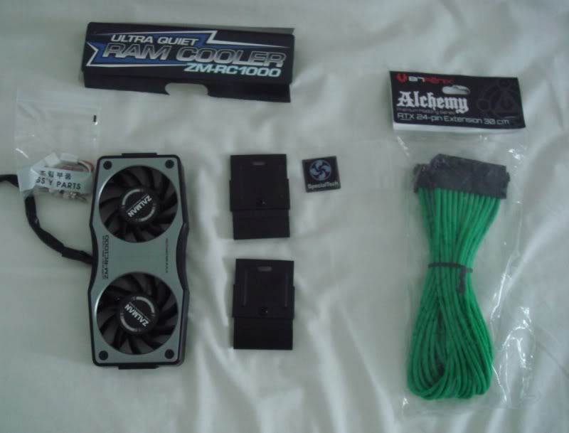

My sponsor stuff came today too. Sadly the Alchemy cables are the totally wrong green so I will use them in the forthcoming mod (will start that in about a month, I have all of the parts ready and just need paint).

Sadly the green on the Alchemy cable is totally different to the rest so I'm not going to be able to use it
and thrice
No doubt I will use it for my next mod project
Any way, see that ram cooler? well, I've always believed they don't really do much. BUT when I saw it I knew it had some scope for modding and would look sweet. So, I took it apart...
I'm sure you can see where this is going.....

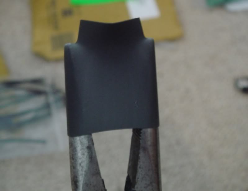

Boshty. I'll fit it in a bit. Just a bit of boring info now. A friend of mine asked me how I got the shrinks to fit so tight. Now obviously I didn't have time to order the completely perfect sizes so I came up with another method. This also helps them to grip really tight. Basically take a piece of shrink that looks close in size and then slot it onto the end of a pair of long/needle nose pliers like this, and gently stretch it (gently I add or it'll rip)
Then turn it around slotting it on the other way and stretch that side if it's too long to go over the pliers in one go. You won't get long to get it over as it starts to contract back to size pretty quickly. Get it over, heat it up. Done

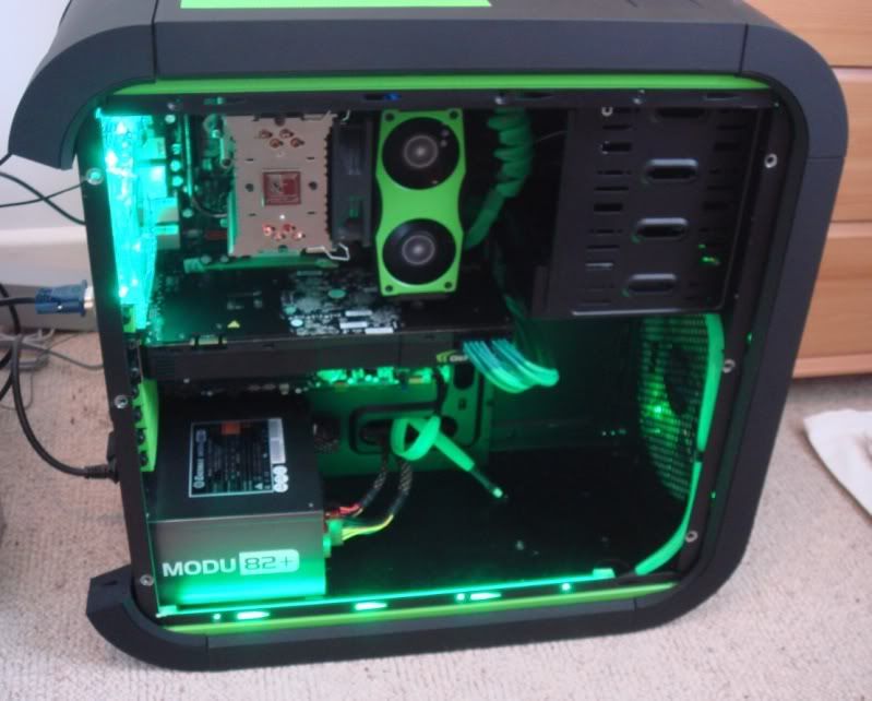

Let's wrap this up then. So the ram cooler was finished and fitted. I'll leave the fans to harden the paint
And some glory pics. Please note these were done last night without the ram cooler on and by the time it's dark I will be snoring in a dark corner somewhere, I'm absolutely exhausted and have a wicked migraine from lack of sleep
Without sounding like an Ahole it's always bothered me that people fit loads of lighting to their PC so that it looks awesome with the lights out but don't do a good job of neat inside for when it's light.

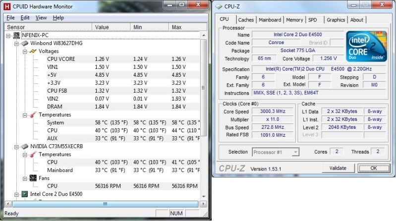

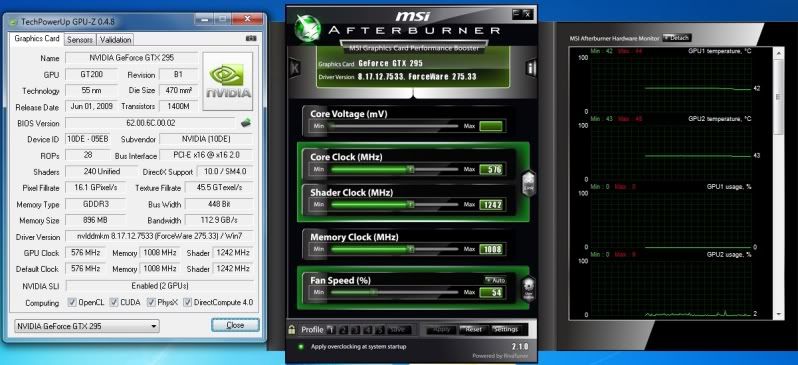

Overclocking testing and benching. First to the overclock. This is an old CPU now but 3ghz was a breeze. Temps are 42 idle and 65 under load. More than acceptable for an old CPU like this.
GPU temps. I have a very aggressive profile, but the card has never reached the 68c mark where the fan would wind up to 100%. It sits around 60% which isn't audible. All I get is a warming hum from the side fan

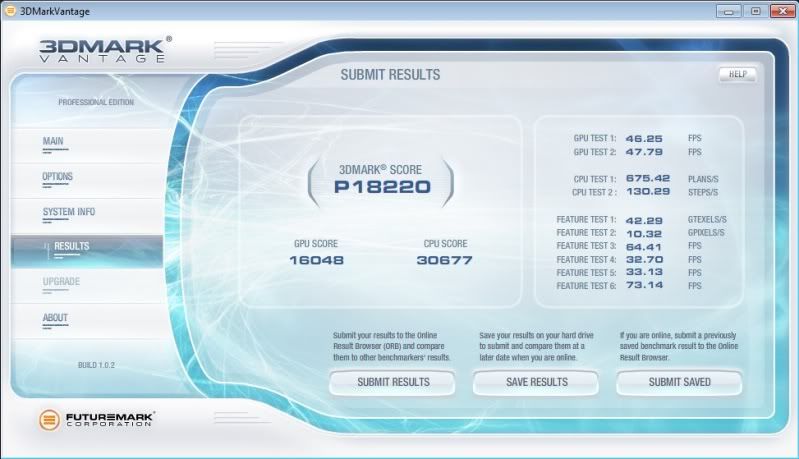

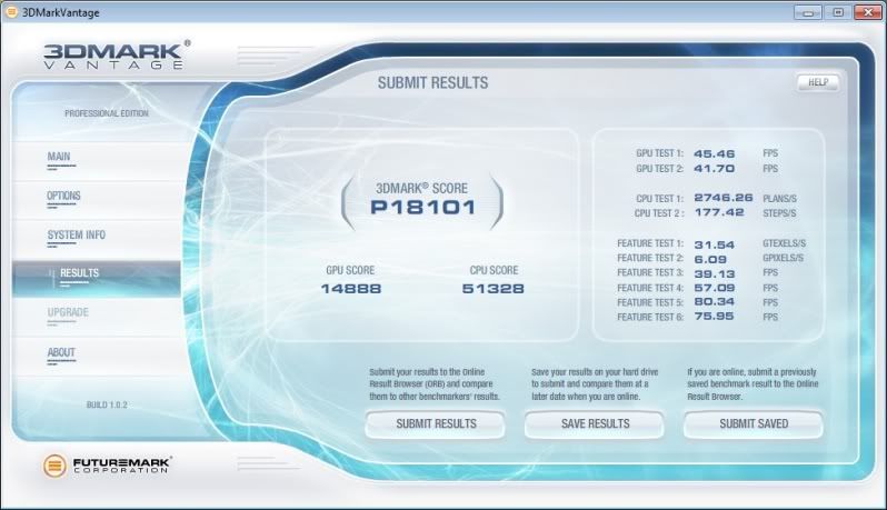

Onto the Vantage run.

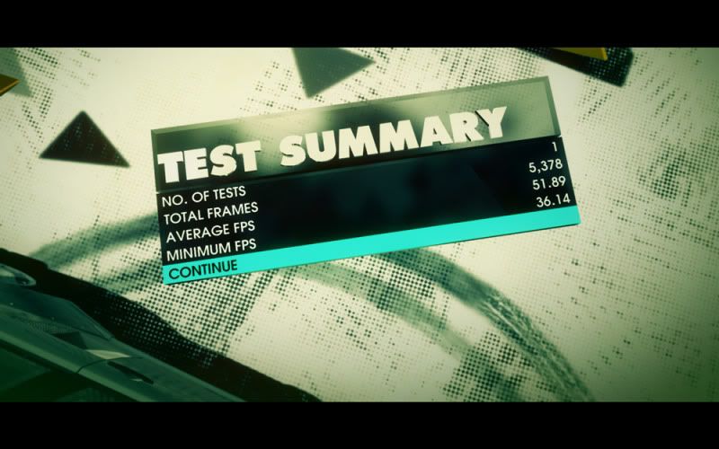

As I suspected the CPU is bottlenecking the 295 quite badly. We ran this card in Vantage with an I7 950 @ 3.8ghz and it scored nearly 23k GPU score. However, even on the core 2 it's *still* knocking out more 3dmarks than my 470 at stock. I haven't loaded on many games yet as I wanted to play through Dirt 3 and play through Duke Forever again (I'm a fan). So let's get Dirt 3 going and bench it. Settings used were -
1920x1080
Everything as high as it will go.
8x FSAA.

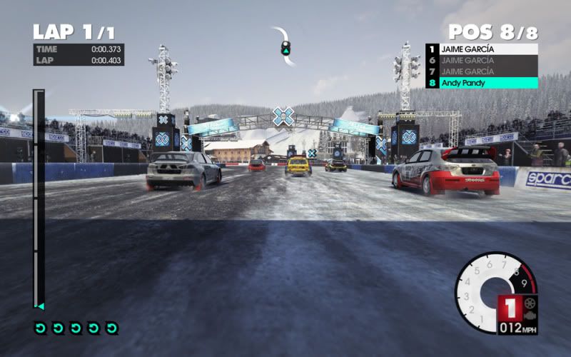

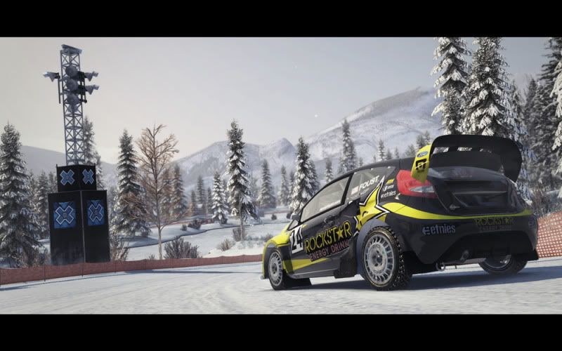

Firstly some screenshots, just to show how pointless I am convinced DX11 really is.
And the results.
