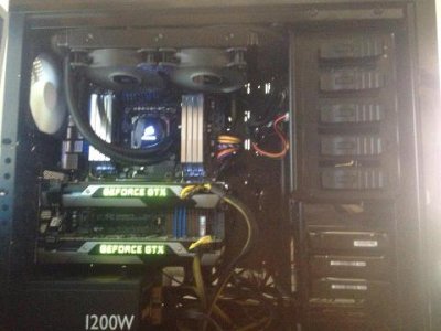

I've recently built a rig and it does everything but play games.
I7-3930K,
Corsair H100i cpu cooler
GA-X79S-UP5-WIFI mobo
32GB (8x4GB) Corsair Dominator Platinum 2133mhz
2x EVGA GTX Titan SC in SLI
Corsair 860i platinum / Coolermaster 1200w silent pro gold
1x Kingston Hyper-X 120gb SSD
1x Corsair Neutron GTX 256GB SSD
1x WD 2TB HHD (green)
1x SG 2TB HHD (barracuda)
1x WD 4TB (Black)
NZXT Phantom 810 case
Whenever i try and play a game, the screen freezes and a horrible noise comes out the speakers and i have to reset. Also, the usb keyboard and mouse lights power off.
I have noted that if i change any settings within the BIOS in regards to memory, it will fail to boot and i have to reset cmos back to default optimized settings. BIOS says memory is running at 1333mhz but if i load a XMP profile or change the timing, it fails to boot.
I thought it was possibly the 1200w PSU but when i swapped it to a 860w, the same problems occur.
Im struggling to figure out weather its something in BIOS, the memory itself or the MoBo
HEEEELP!!!!

The 7850 I used to have did the same thing. Might be one of the titans. Try running a single card, see what it does. You should try each of them, obviously. Bet it works just fine with only one of them.

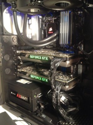

Ive been considering taking one Titan out to fault find but I keep conflicting with the idea that its supposed to work, not "not work".
Ill give it a shot and see what happens but I'm reluctant to settle for 1 titan and 16GB of memory when i got 32 ands board takes 64gb max.
I have even tried separate 12V cables for each titan power plug but according to Corsair Link, they both have plenty of power.
So...I removed 4 RAM and now its fine.
Better have 16GB instead of 32GB instead of having only one Titan, ae!
