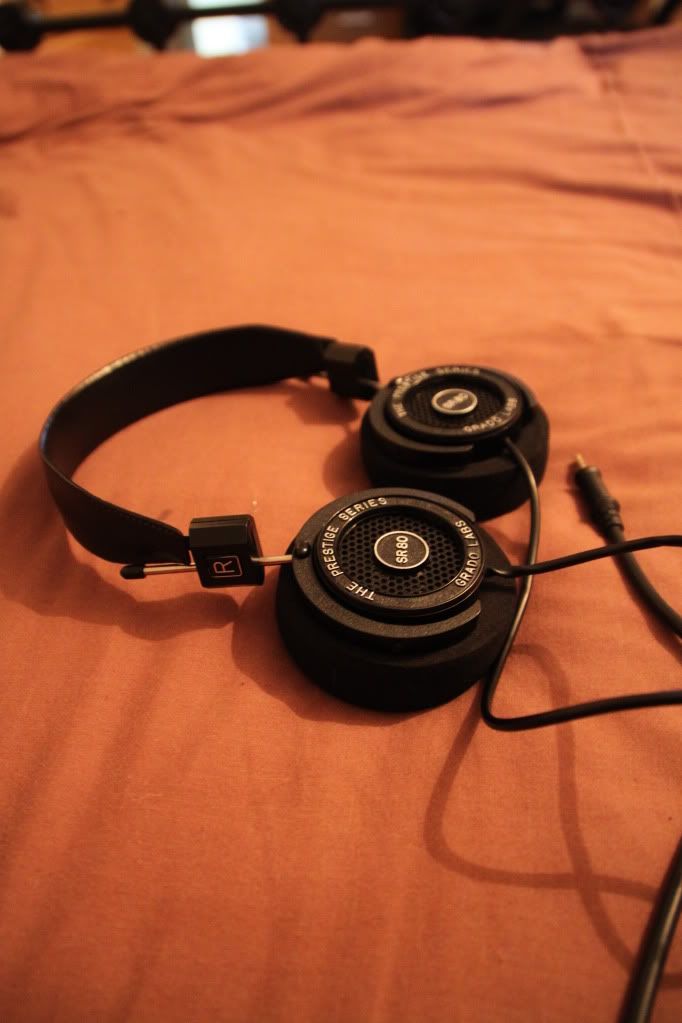

well after the seller posting my grados somewhere else, they finally arrived this morning!
when i first put them on, they felt really flimsy and no weight to them, i really do hope that they are better with the wood cups.

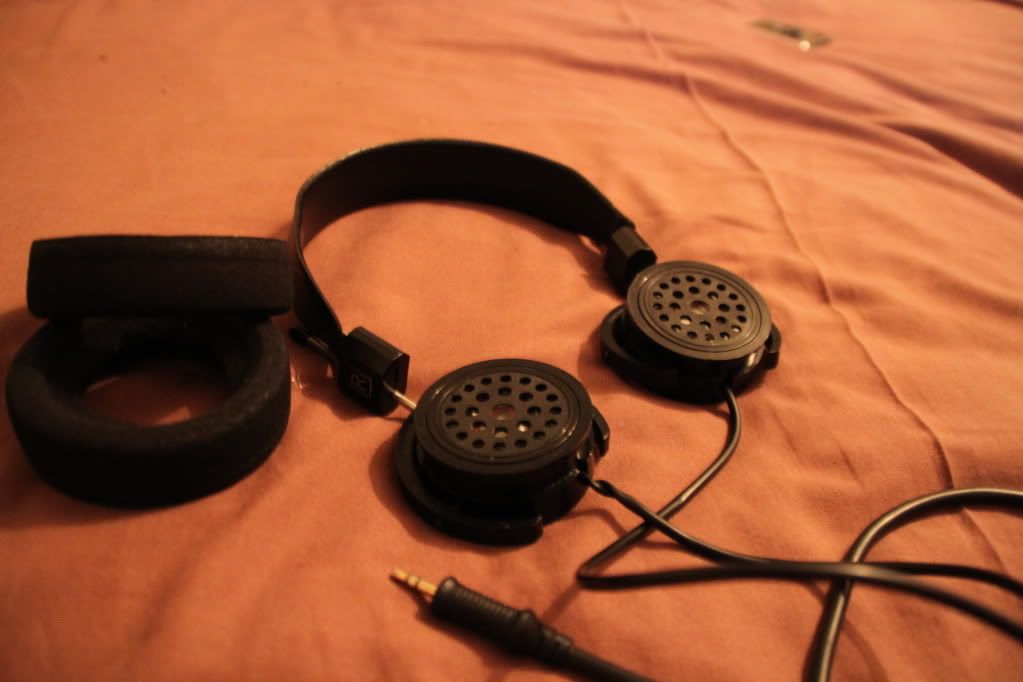

ok so heres the mods i did to them today then (nothing too drastic yet...)
i removed the rubbish protective layer of nylon that separates the drivers from my ears.
that wasn't too hard, a sharp knife did it within a minute..

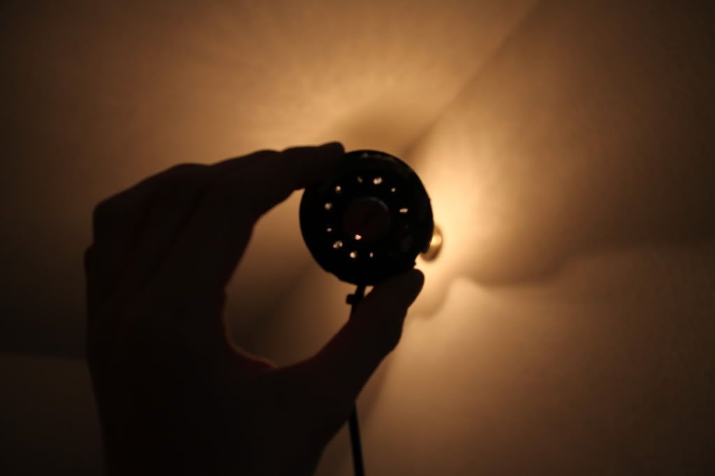

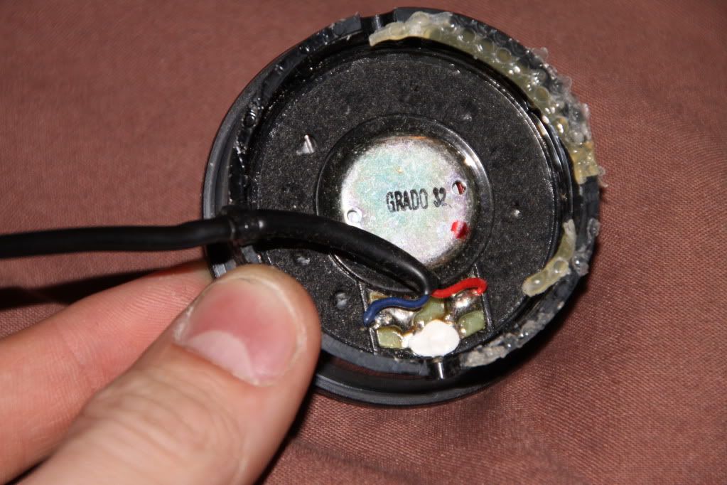

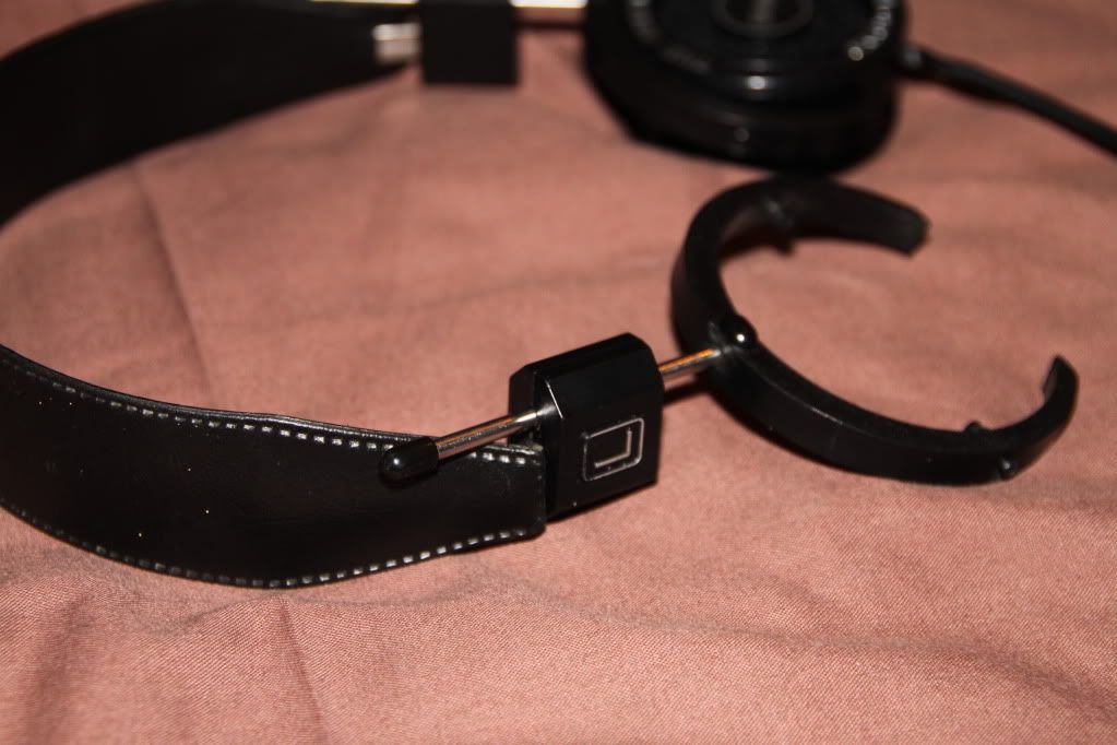

the next thing i did was liberate the drivers, i did this by removing the plastic cups of the headphones..
i tried a method of heating the glue through steam (very 19th century), it didn't work.
i then got a hairdryer and heated the glue up that way, they still needed a little bit of a push, so i used the knife from removing the nylon to separate the pieces of plastic..
the next thing i did was stab the end of the knife through the translucent holes in the driver, some people just do the 4, i decided to go with all 12.
the difference you may ask?
WAAAY MORE BASS.
