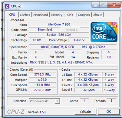

hi i just starting to get into overclocking my i7 950 cpu and below are the settings i am using specs of my pc can be found at the end i just wanted to know that in cpuz i am getting core voltage readings of 1.366v and just wanted to know if this was a safe voltage for this OC the Core speed cpuz is showing is 3718.3 Mhz also are my setting right. I have ran prime95 so far for about 1 hour and higest temp i am getting is 83oc

I have exactly the same setup as yours. I have disabled the Turbo and speedstep. That Vcore at 1.34V is very high for 3.7 Ghz OC. I would say Disable the Turbo and manually put all the values. If you disable H/T, you can shave some 10*c from your core temps.
DONT disable HT for the love of god. The 950 isnt a hot chip you just need to set it up correctly. Most will do 4ghz 200x20 at 1.25v or below. You just have to set it up properly.
DONT disable HT thats taking away the hyperthreading and means it only has 4 threads rather than 8.
Your temps are high because your Vcore is high, what CPU cooler do you have?

I am not sure about the cooling set up of the other poster but for me to run this Chip at 4 Ghz with H/T, it was pushing Core Temps to 80*c- 87*c in Prime95, and CPUTIN temps at 76*c. For some it may be within acceptable limits but i want it to run little cooler then that. I do not have the water block but running on AIR with Noctua NHp-12( should have gone with NHd-14). I had to lower the OC to 3.8 Ghz so that i can have HYPER THREADING ENABLED. Max temps i have seen on IBT is 74*c and CPUTIN at 63*c. Vcore is 1.2850 and Vtt 1.3v.Dram at 1.65. Memory running at 1605 MHz.
I am not sure if with my setup, i can run this chip at 4 Ghz with Hyper Threading enabled.
