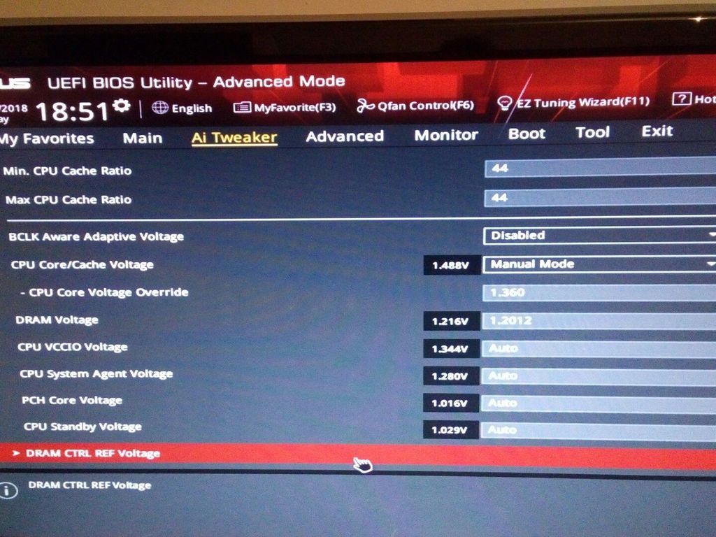

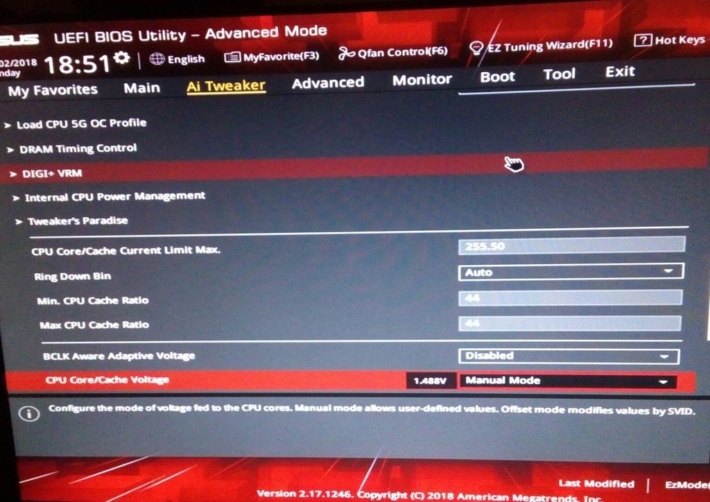

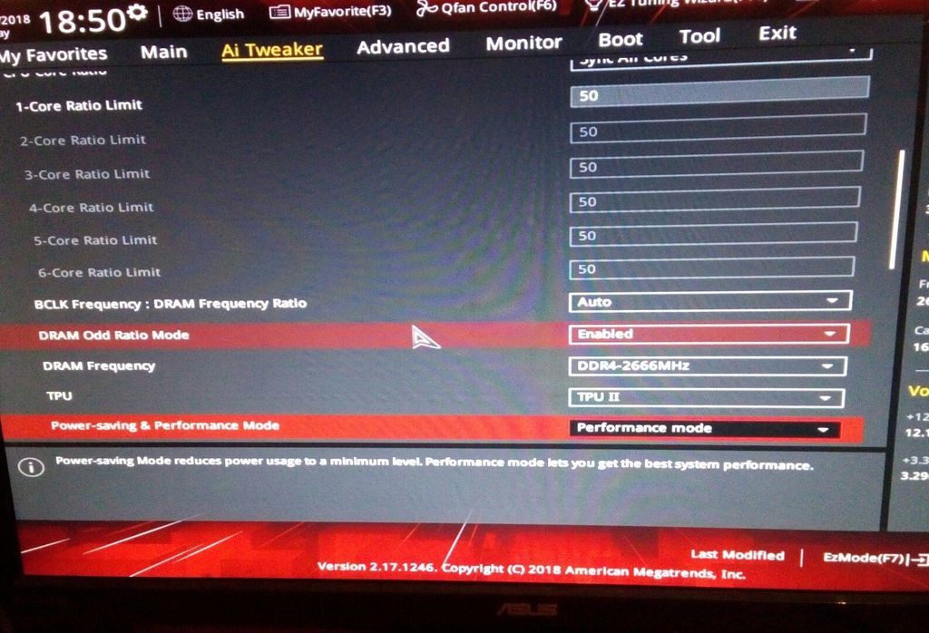

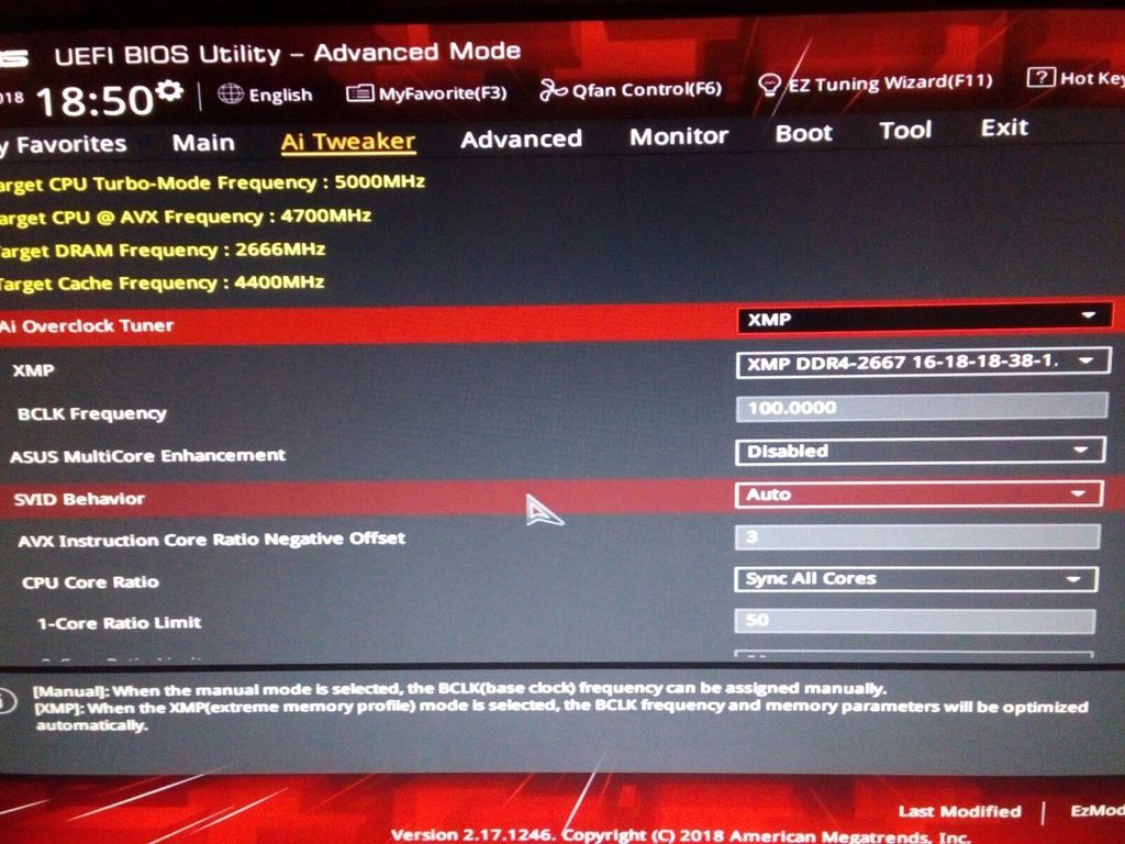

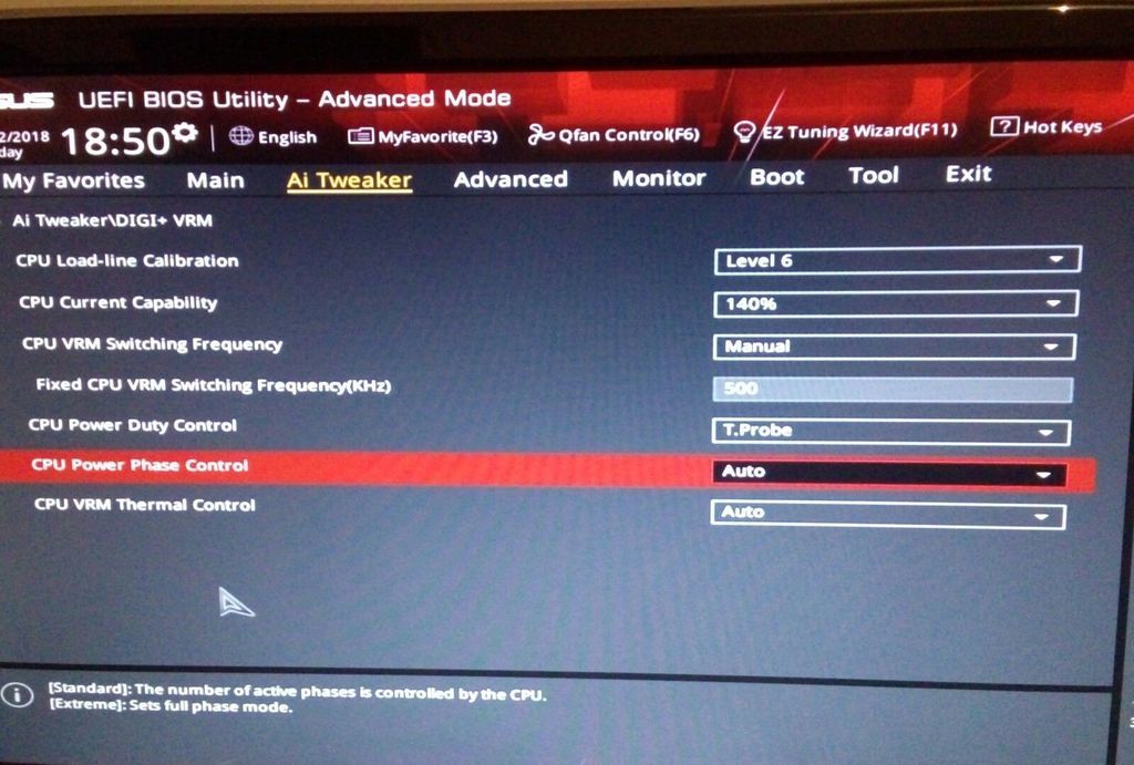

So i have a prob with my cpu or the motherboard
with this settings i can get stable with the same cpu on a Maximus X Formula
8700K 5.0Ghz 1.35v
DRAM Configuration
Load XMP........XMP 2.0 Proile 2
Bclk Frequency.........100.0000
DRAM Reference Clock........Auto
DRAM Frequency.........DDR4-?????Mhz
ASUS MultiCore Enhancement……….disabled
CPU Configuration
CPU Ratio.........All Cores
Core Ratio Limit...........5.0Ghz
Min.CPU Cache Ratio............... 44
Max.CPU Cache Ratio...............44
AVX Ratio Offset................3
Long Duration Power Limit.........................4095
ShortDuration Power Limit.........................4095
CPU Core Current Limit...........255.50
Voltage Configuration
BCLK Aware Adaptive Voltage…………………….Disabled
CPU Core/Cache Voltage.......................Manual Mode
CPU Core Voltage Override....................1.350v or 1.360v
CPU Load-Line Calibration .......................Level 5 or Level 6
CPU Current Capability…………………………………140%
CPU VRM Switching frequency…………………..Manual
Fixed CPU VRM Switching frequency(KHz)………………..500
CPU Power thermal control …………………………………….120
DRAM Current Capability………………………………………130%
DRAM Voltage...................................1.350v
For 5.1GHZ and 5.2GHZ
CPU VCCIO Voltage……………………………………………………………. 1.325v
CPU SYSTEM Agent Voltage……………………………………………. 1.250v
Boot Performance Mode……………………………………………………… Max Non-Turbo Performance
FCLK Frequency…………………………………………………………..1Ghz
CPU Core Voltage Override…………………………………… 5.1Ghz 1.45v and 5.2GHZ 1.5v
with Asus Strix Z370i i need 1.45 to get 5.0ghz
This is normal or i'm doing something wrong?
