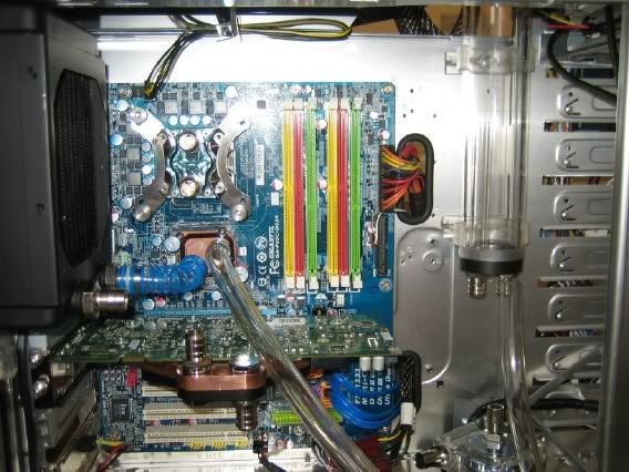

O.K. With the help of Aqua-PCs (thanks again for the vrm cooler) and members of this other forums i am ready to start my rebuild. I could do with some advice on my loop though. Should i go the shortest neatest route or put in a couple of extra feet of tube so i can get the pa120.2 in the loop before the CPU?
This is not the way i was planning of doing the loop but now i have most things in it, it is the most direct route to take. Res – pump – GPU - pa120.1 – NB - CPU - pa120.2 - res. I really wanted to go through the pa120.2 just before the CPU.
I have posted a picture below and am open to suggestions.
THE PA120.2 WILL BE IN THE FRONT.

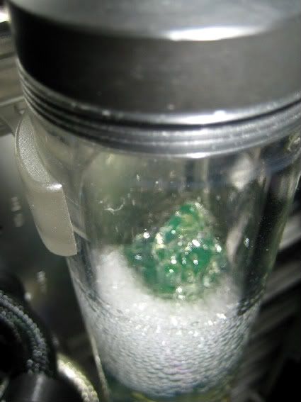

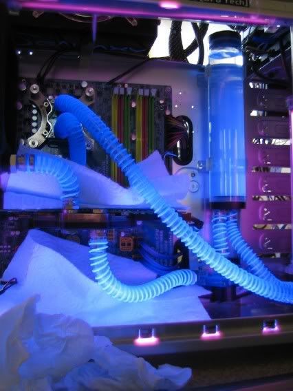

Well i got inpatient and had to give it a run. Still plenty of minute air bubbles in it though.
Q6600 1.45v @ 3.6GHz temps 43,45,39,39 idle 55/59 with prime GPU 42 idle
What do you think of the temps?

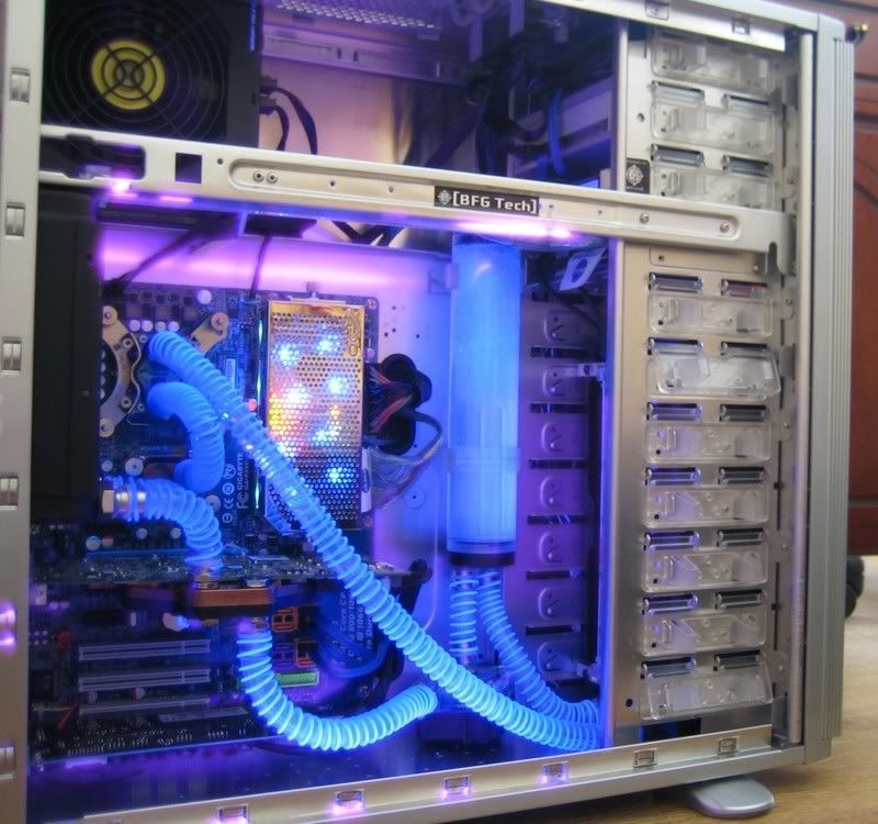

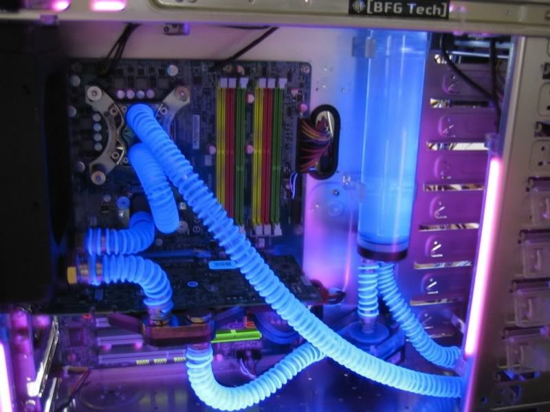

OK some photos of the finished rig Thanks to everyone who gave advice on the build.

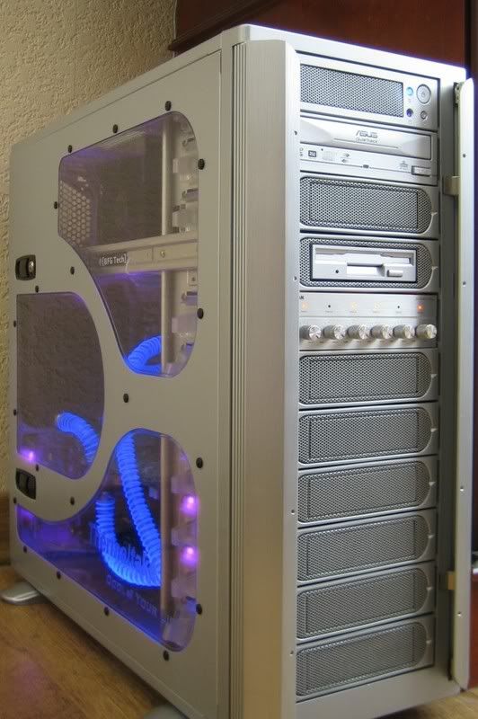

Nothing special about the case it’s an Thermaltake Kandolf with the door taken off the front.

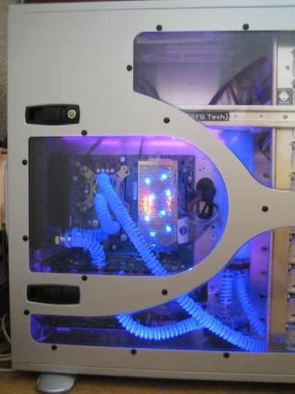

The side view (mental not to oneself must look for a nicer looking case or mod the side panel).
The side panel removed.

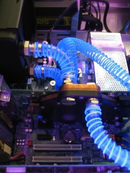

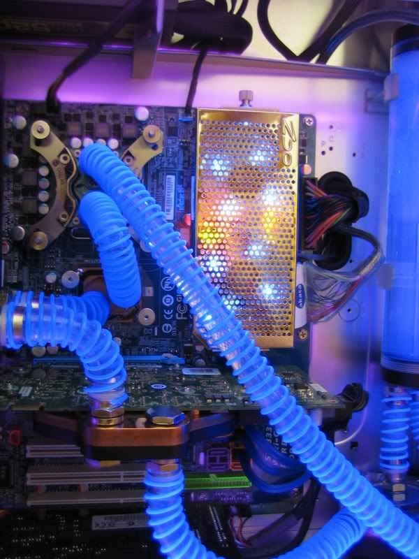

EK full cover water block for the 8800GTX with a big thank you to Aqua PC for supplying free of charge the VRM cooler.

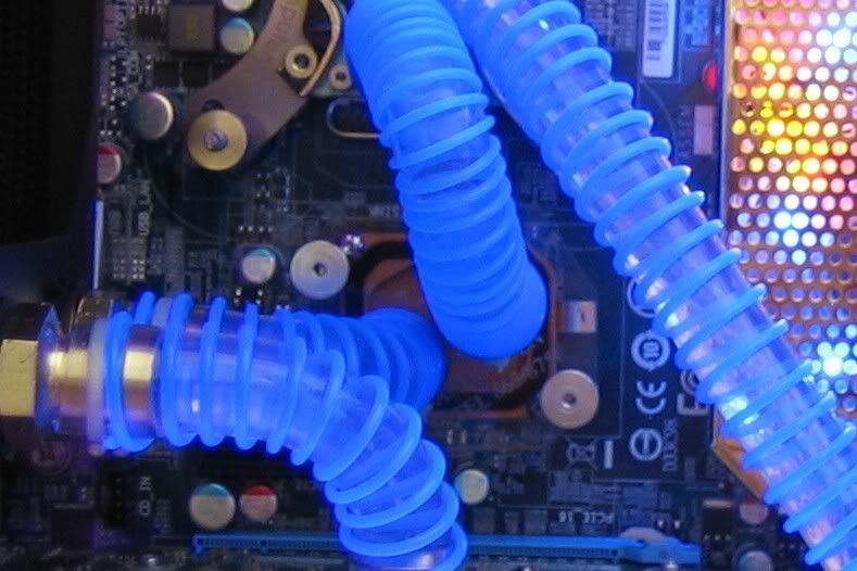

The NB block made from an old DangerDen Intel 865/875 block. I did get a twinplex XT di to match the CPU block but it turns out it had G1/8 to G1/4 adaptors for the ½” barbs and i thought the flow rate would be too restricted if i used it.

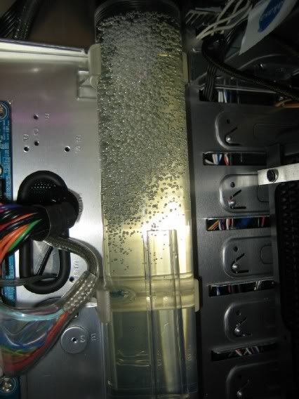

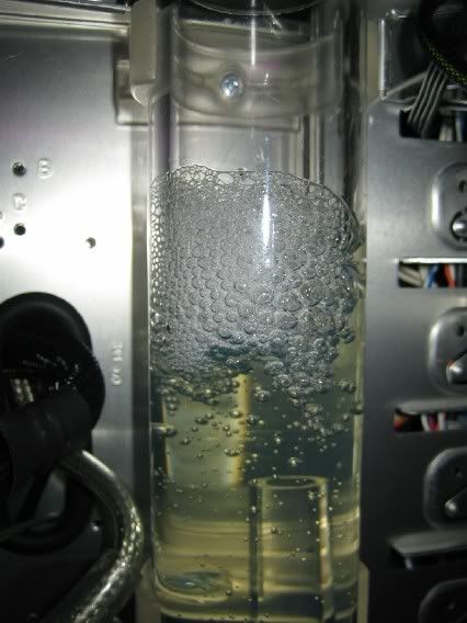

I think i may have been wrong though as look at all the bubbles/throth in the res.

Looking good ……although it might be an Idea to let some of the water out of your res..
Half full will give you room for expansion when the water warms …and will also give the air bubbles somewhere to go…..
If you have no air cushion to allow for expansion the pressure can build up and blow a pipe off a fitting….
Apart from that it`s a great setup….

Good point about leaving room for expansion. I have taken about 3" out of the res but I think I will need to do something about the temps I have a 120.2 spare or may get a 120.3 on the back if I can find one going cheep. This will also slow the flow rate down which won’t be a bad thing;
