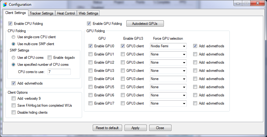

If you rather Fold with the GPUtracker and want GTX680 support , here is howto,
1. Download this modified build of FAH GPU Tracker V2 with Kepler GPU support:
Download from fahtracker.com
Download from jedi95.com
2. If you don't have the Tracker installed, you can follow the guide HERE. Otherwise just replace your existing FAH GPU Tracker V2.exe with the one in the archive.
3. Download FahCore_15.exe version 2.24:
4. Copy the downloaded FahCore_15.exe to any GPUX subfolder that corresponds to a Kepler GPU. Replace the existing FahCore_15.exe if present. The V6 clients will not automatically download the 2.24 version of Core 15 required for this to work.
5. Set Force GPU to Nvidia Fermi and enable the GPU3 client for each Kepler GPU. GPU detection will not work correctly for these cards. You also need to check the box for "enable -advmethods"
You should see this message in the log on startup .
NOTE: The modified build of the Tracker replaces -advmethods with -betateam for GPU clients configured with force GPU=Nvidia Fermi so you don't need to manually edit client.cfg. If you are NOT using the modified build you need to DISABLE -advmethods and manually add -betateam to the extra_params= section of client.cfg
Good luck and Happy Folding..!
