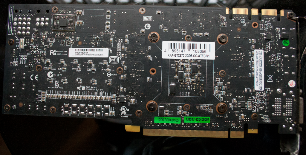

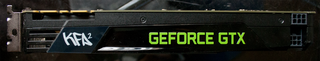

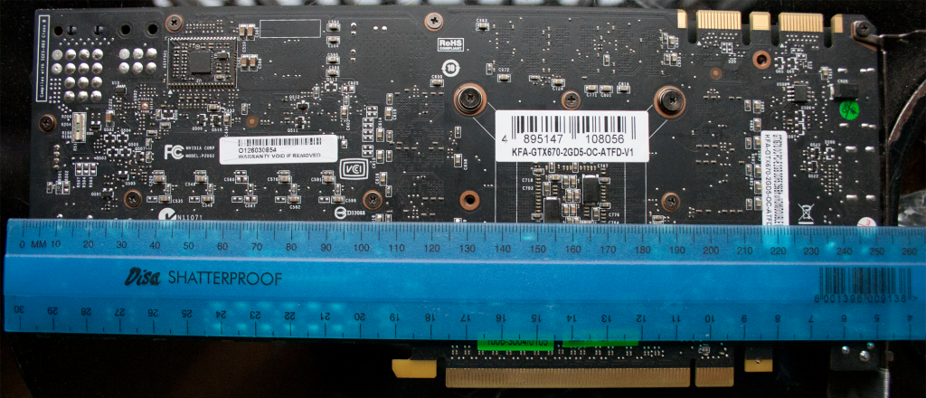

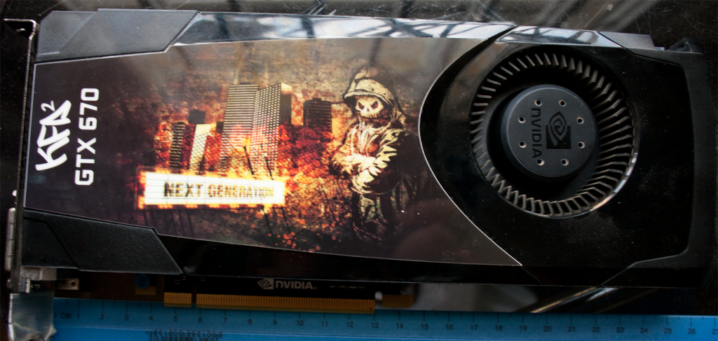

Yes, I'm trying to find out if I need the GTX 680 water block or the GTX 670 water block. Since the rep I talked to did say it has a reference design, just trying to find out which one. Sorry if I didn't phrase that right. Here are the pictures you asked for.
This is from the top view
This is the side view showing the power connectors
This is the back view with the model number
And the zoomed in shot of the small sticker
And finally the PCB size

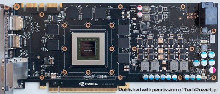

The reference 670 PCB taken from EK's website:
The power points are in different places and is clearly a lot shorter so I would suggest that yours is not reference 670.
The reference 680 PCB:
Looks very similar to yours...
Your card seems pretty similar to the 680 ref pcb (670 on 680pcb) , so i honestly think the 680 waterblock will fit......???
Some quick photoshopping..
If you ignore the distortion on your photo, it looks like they line up just fine tbh mate. Looks like a 680 reference PCB to me?
