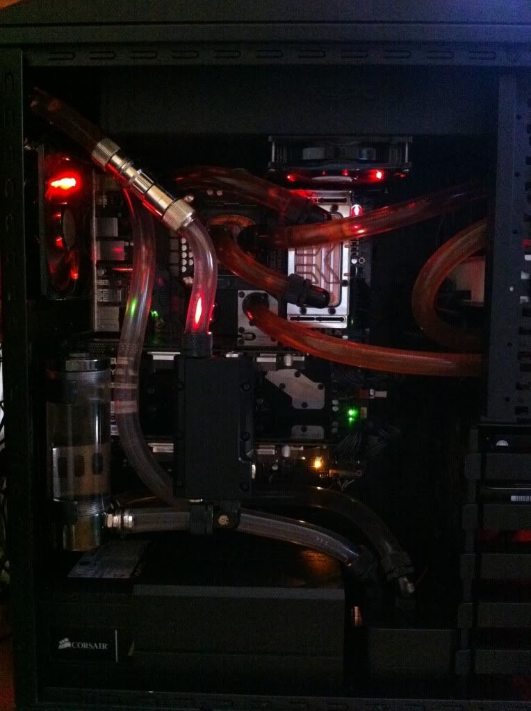

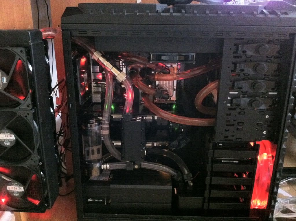

Well Problem is with going from Reservoir -> Pump -> 240mm Radiator -> CPU -> GPU -> 200mm Radiator -> Reservoir? Is if the 200mm is a intake which you really would need it's going to be the Rad which is the hottest because it's after the CPU and GPU so you'll have Way to much hot air int he case and hinder the 240 rad, You could go like this but it's messy with tubes
im in love. (lol)
All so you res is wrong and way to low it should be higher but you aint got much room in there. Really the res should be at the highest point in the case how ever not many people do that any more hence they all end up with in ineffective systems as air is trapped in the Rad.
