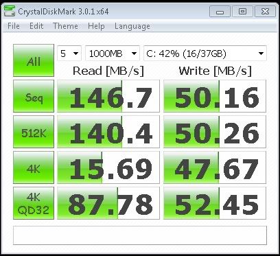

Bit late but i had the same problem with my F60 on my UD3R, i had my one on the Sata3 ports which were dead slow then changing to Intel ones described above all that changed, so now i get top speed of 200mb there a bouts but still bit slow for what the drive can do.

I am just surprised that on the Corsair site it says "You don't need to do anything to our drives other than set to AHCI mode for good performance" I have done this and yet, performance is crap.
I am in the process of doing an RMA. The most ironic thing is, i have always doubted OCZ, so i went for corsair; my brother just bought an OCZ drive for £60 and it is better performance than mine.
Reason for the RMA, i tried Crystal Disk while the drive was plugged into my main rig, which is running sweet off my Intel 510, and the performance is exactly the same as it was on my HTPC. So it cant be any of the hardware in my HTPC. So it will be going back to Corsair and hopefully a nice replacement should be sorted.
