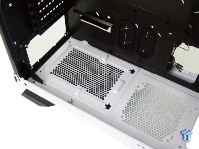

Hello, I was looking for some advice about the airflow in the Corsair 760T. Under the second removable drive cage there is a 140mm fan mount, that mounting has no dust filter so I was thinking it might be useful as an exhaust.
My graphics card (Asus 780 with the DirectCU II cooler) circulates most of the air into the case instead of having a vent that blows it out the case, would installing a fan on that mount remove the air the GPU blows out or would having it so close to the front intakes disrupt the air flow? I will install the PSU upside down to take advantage of the dust filter, I do not want the GPU blasting air into the PSU anyway.
The rest of the cooling will be fairly basic, the two intake fans and a Corsair H90 on the rear as exhaust and CPU cooling. My system is all at stock settings with no overclock so temperatures elsewhere are not a worry, I would like to remove the hot air from that GPU though.
I included a pic for anyone that hasn't seen the case, there will a drive cage in between the front intake and that exhaust if I fit it.
