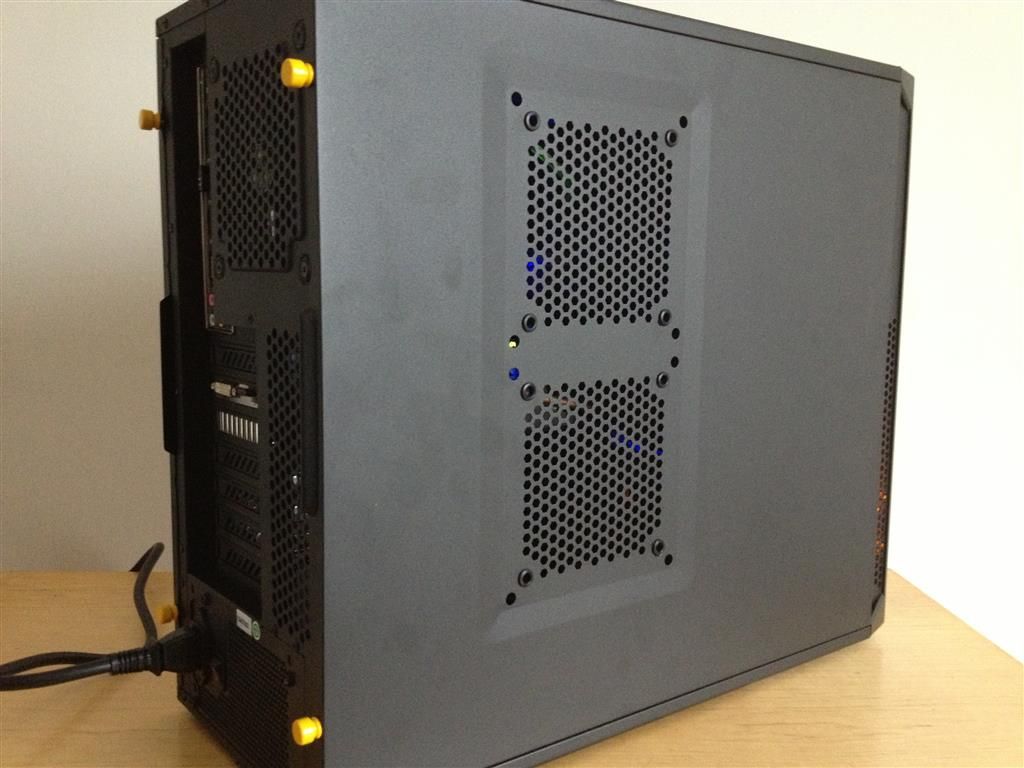

Hi, this is a rig i just finished for a friend.
Corsair 200R
Corsair H100 with Yate Loon 1650rpm fans
Corsair CX750 modular PSU
i5 3570K OC 4.4GHz
MSI MPower Z77 motherboard
16gb Avexir Core Series (MPower) RAM
Powercolor 7870 Tahiti LE Myst+ Graphics Card OC 1180 Clock 1600 mem
64gb Crucial M4
500gb WD Blue
I sheathed the fan cables in yellow and black, put leds behind the front grill and painted the case screws yellow.
I had a budget to stick to but the main goal was to make i quiet and it is.
Let me know what you think.

Did you have to do any modifying to the case to get the H100 in there? I was under the impression it wouldn't fit.

Yeah the heatsinks and RAM were in the way. If you look at the picture at the top you can see that the H100 isnt screwed through the holes that Corsair intended. I had to drill 4 new holes on the other side aw well just where the crease in the top is, i fitted the spare grommets that Corsair kindly include and its fits lovely.
I couldnt get the cables any more tidy, theres just no where to hide them. Thats why i used yellow cable ties and some yellow sheathing, along with some black to try and accent the cables that couldnt be hidded.

a pic of the cabling on the back please? else it looks nice.
ive given it to its new owner now. i can ask, but you can rest assured that everything is sleaved and is as tidy and cable tied as it can be

I just thought if im going to use zip ties i may as well colour code them. i couldnt buy yellow case screws anywhere, so popped out, bought some automotive clear coat and some bright yellow nail varnish(polish)! they didnt have bright yellow car paint in the shop.
Maybe i need to look at my cable management skills, i thought that was OK. Whatever i couldnt hide i tried to make a feature out of.

i see a front panel audio cable if i'm not mistaking. i usually remove it, i mean who the hell uses front panel audio and it just looks like hell in the rig because the cable goes right above the PSU.
I don't personally use the front panel audio because my computer is part of my bedroom studio setup, but if I didn't have a sound card I would. While testing the rig I used it because headphone cars aren't that long. If the owner wants it taken out he can, but I can't start disabling features jus for aesthetics.

But maybe I can be a bit more specific: There are two areas that I would try to rearrange a bit if it was my rig: I would try to line up the two flat cables coming to the graphics card which are now coming in at different angles. Maybe zip tie them together with multiple zip ties so that they're lying above each other in parallel.
Secondly, I'd reduce the criss-crossing of cables down in the PSU area.
To me, the optical objectives of cable management are minimizing crossing cables as much as possible and not having too much excess cables visible, with the first one being more important. But that's just personal preference, others might of course have different priorities. And not hindering airflow is the primary goal naturally, which I think you have achieved here.
Again, despite best intentions, my suggestions might simply not be feasible. But I hope it's helpful for future builds at least ;).
