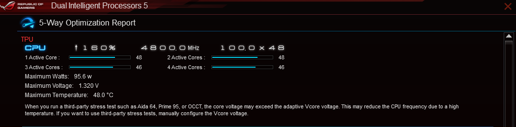

The memory is on asus QVL. The pc was working fine with the xmp set at 3200 18.18.18.38 at 1.35v
In till I messed with the asus ai suite, then from here its been all down hill. The matrix has it load indicator and even playing games after the ai3 done its thing the Gfx card was not under full load for the whole time I was gaming.
Then it crashed and well the problems have been ever since.
