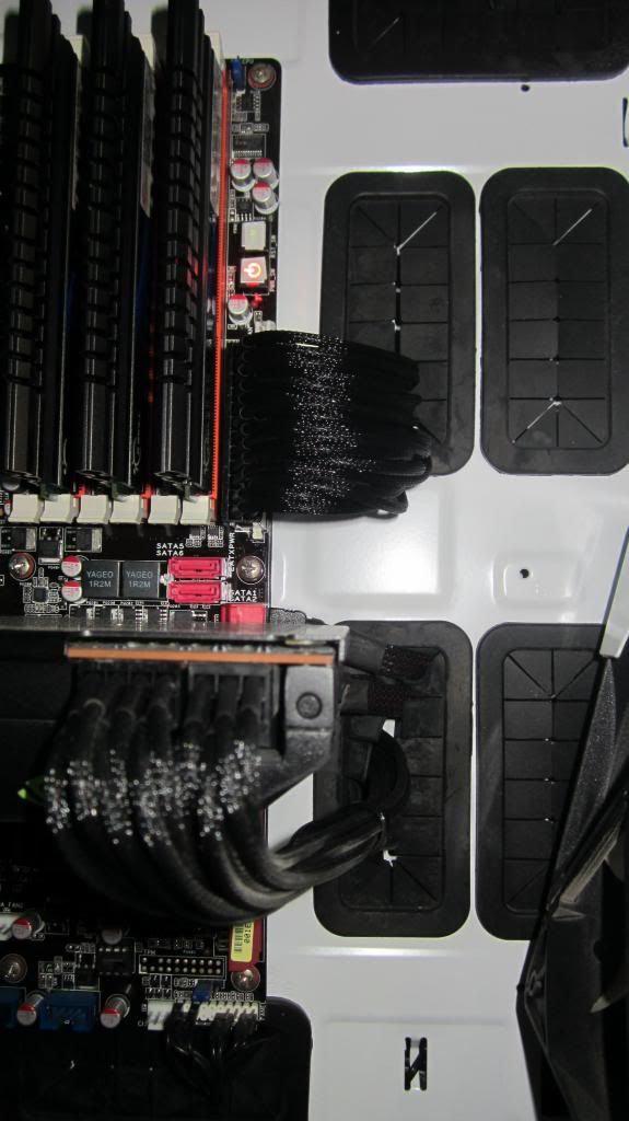

Laced my main rig today, this is a before:

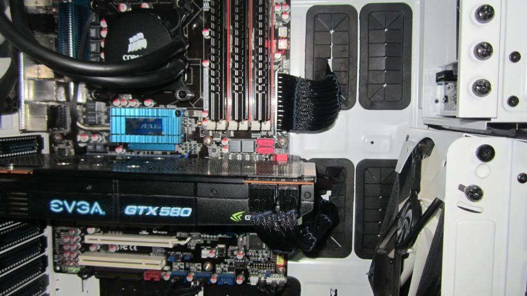

And here is the after, I'm not totally happy with them especially with the pci power cables but I will get them fixed eventually. I just got a job in IT and I need to settle down before doing some more work, started on Monday :P
Oh, that was already pretty tidy before. :)
About the PCI-E cables: You could try lacing them in one package of 14 wires to get it
into a more ordered state, that's what I do. Makes for one clean flat bundle.
And congratz on the job! :rock:

Yep I know it was pretty clean and I must admit I was pretty happy about it, but I think you'll understand me for wanting to change something, in fact, I needed to change something lol. I can't believe the pci idea didn't come to me before, I guess I was in a hurry to do them I skipped the thinking part haha, but anyways thanks for the heads up :)
