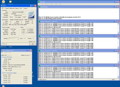

i only had a short time with a friends blitz formula board, but managed to get his Q6600 fairly stable at 3.7GHz (passed all benchmarks and occt'd for an hour)
since then he's pushed to 3.8GHz and has been stable while gaming for hours (s'all he needs/wants it for).
when i was speaking to him yesterday he told me that he had been running prime on it for nearly 4 hrs *shrug*
i did witness the restart bug, but apart from that, i had no major probs

lol, that's the system i was setting up - day187's in that thread
he came up from stoke so i could retube his watercooling and set things up
