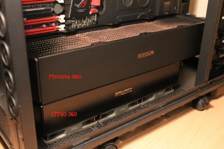

I did buy this Monsta 480. Its waiting installation to be completed on Elysium.
Here is little side by side comparison, with UT60 360 that is also in the same setup as i finish it (hopefully).
