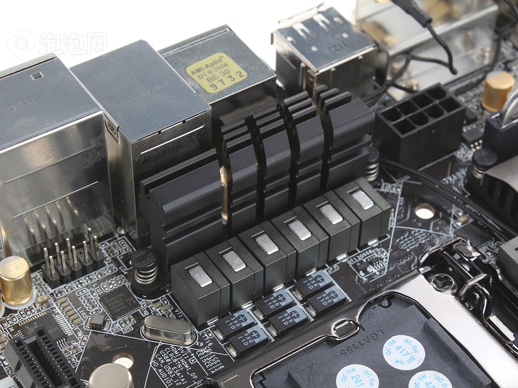

I've just finished testing with different psu and with everything outside the case, with and without graphics card but still nothing. First i tought the 8pin eps connector is wrong because it looks like [this] but still (its 4pin+4pin) and insert on motherboard has 4 square holes [pic]. Second psu (XFX 450W) had mathing pins but cmos is still reseting. [This] connector is the right one? I got bit dizzy and don't know what is right or wrong anymore.

If that battery socket is moving like you said it was, and you did not check out if it is infact connected to the board and providing power, you are wasting your time with trying anything else because without battery power every time you unplug the system from a/c power the bios will not save and revert to default settings..
I draw a picture showing how my battery holder moves, maby not as much as shown but i had to make it clear
The battery on your board stands vertically, so if you put your finger on the battery, it will likely move a little, but should not flop around just by picking up the board to a vertical posistion.
