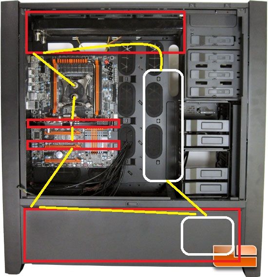

no point going from Rad to Res bro.
Nothing wrong with it. I used to do it.
Besides the diagram shows a good loop. Personally I hid both rads in the lower compartment. 2 rads with one pulling in air and the other in pull/push has some very nice flow going through it.
Your loop is fine. Please get rid of the HDD cages though

You need a plan, a proper one
Your latest plan of the tubing going seems pretty good,same way as i would do

My advice would be not to obsess about it. The order of the components makes little if any difference. You want short tube runs and a clean look. I would use Radeon HDX's mockup. And try to rout as much tubing out of sight as possible. More importantly if you are using flexible tubbing, make sure you have any angled fittings you plan on using. They add little restriction and can clean up the design.
Ok thanks I'll stick with my first setup, how are the temps on your pc? Is is efficient enough. And I am getting rid of thoes hard drive bay as soon as I get the case, also I wanted a 360mm rad at the top and a because I am spray paintitng my fans gold do I want to show them off.
