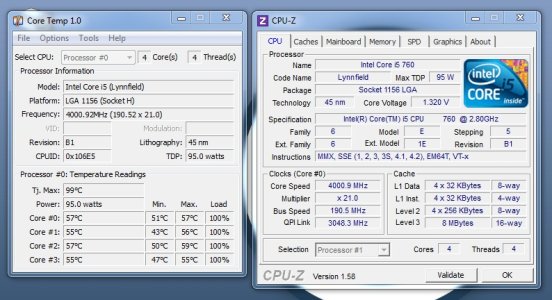

Hey I am trying to get as much PPD as possible in folding. The temps are low as the room was 27 digrees when the screenshot is taken. Can I overclock further yet?
If so can you suggest overclock settings?
Thanks!
I5 760 @4GHZ
P55-GD65.
You can definitely go higher, I need 1.4V on my 750 for 4GHz and then i get max of 70-75 when folding in similar temps.
Try getting 4GHz with 200 BCLK first, once that's done keep stepping up the multi/voltage to an absolute maximum of 1.45V, I personally wouldn't go above 1.4 though to be absolutely safe.
