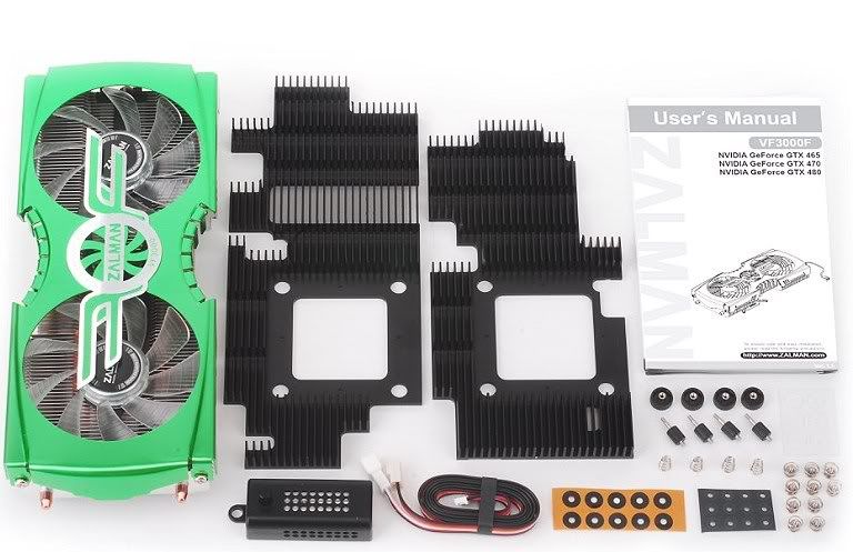

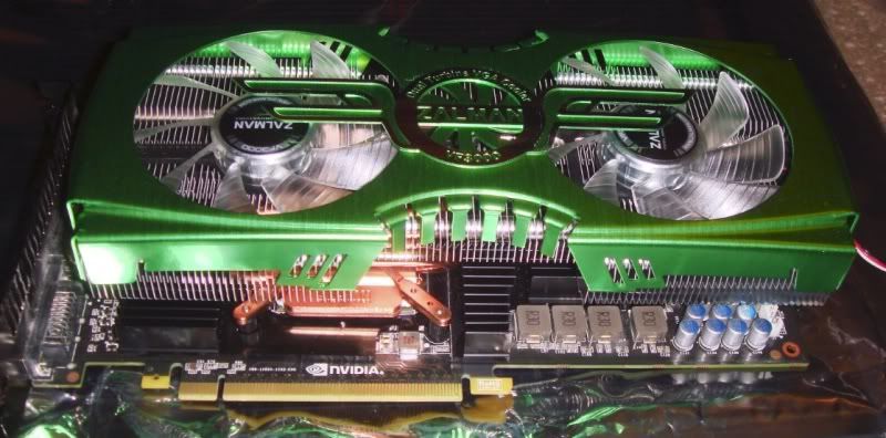

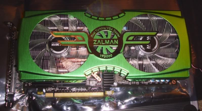

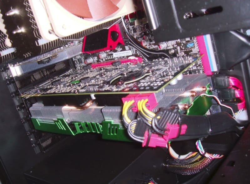

I am a man. However, I am not a manual and thus there is no point in me giving you step by step fitting instructions as that's Zalman's job. Thankfully though they do a great job of it, so making your Geforce 465/70/80 is quite easy (though a little time consuming) and you should end up with something that looks a little bit like this.​
If we look underneath we can see how the VRM/RAM plate looks and the depth of this cooler​
It's big and it eats three slots. I don't know what else to say really. So, if you are or intend to run SLI then I would check your motherboard's slot spacing. Cool doesn't come without a cost, we all know that. Sadly (as I mentioned in my Bitfenix review) there is always a downside to pretty much every product you can buy. And, I will find it. So, it came as no surprise that I absolutely hate what Zalman make you go through to get the fan working and, how you control it. Basically you can not just plug the fan into your card and then load up Afterburner. You must wire up a silly little fan controller unit and stick it somewhere in your case. Now you can imagine how annoyed I was at this after spending days making my case as clean as possible, only to find I have to fit a stupid lump to the inside of my case with wires hanging out of it. Thankfully after a lot of thought I got the card in and managed to do a decent job of making it tidy.​
And a close up of the fitted card.​

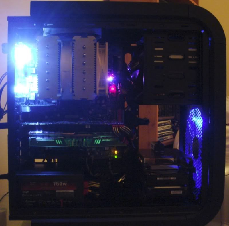

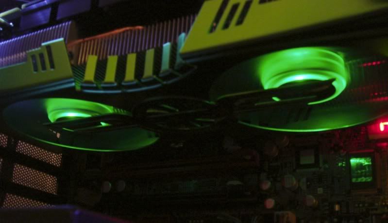

The fans are fitted with green LEDs and when in action they look like this. Bear in mind however that this is with the fan on full blast.​
If the fan is not on full blast then sadly they are not as bright. But, this isn't a look good competition and cooling talks and BS walks, right? Just incase you had a tear running down your cheek over the LEDs becoming dimmer here, look at this one.​

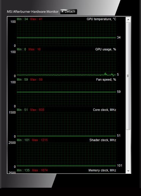

Which is quite loud really. This worried me, because when I started up the PC and heard how loud it was and then saw the idle temps I was a little bit dissapointed. Infact for a moment I actually thought I had made a mistake fitting it. You see, with the stock cooler on my card I got an idle, adaptive performance temperature of 39c. With this one on with the fans on high making all that noise I got 34c. Which is OK, but not what I was expecting. So, I decided to lower the fan to the medium setting (video one) and the temps didn't change. That was nice then
Firstly here are our idle temps with the new cooler fitted and the fans on medium​

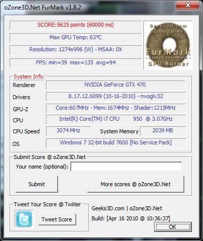

Test one - Furmark Benchmark - Medium fan speed

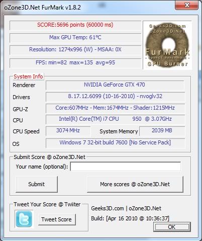

Test two - Furmark Benchmark - High fan speed
A 2c difference. All that noise for a 2c difference. Thus as you can probably imagine I turned the fan straight back down to medium (inaudible) and was amazed at how well this cooler works. I had read that it didn't make idle temps much better, but full load temps were just incredible compared to before.​

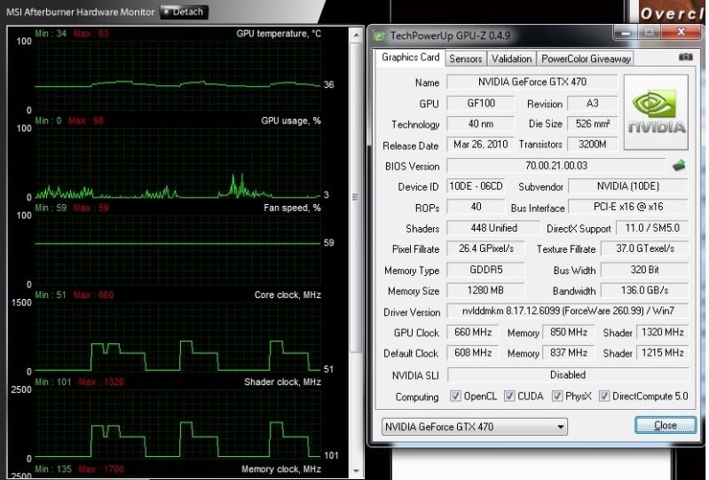

The test circumstances used for this are basically the stock settings from a Zotac 470 Amp ! If you take a look at this picture you can see the differences by looking over GPUZ​
You can also see that with the fan on medium the idle temps have only risen by 2c for a 10% overclock. None too shabby, let's torture our newly overclocked card with Furmark shall we?​

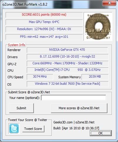

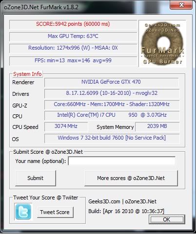

1c. One centrigrade lower for all that noise. By this time I was convinced that I would never need to torture my ears with all that racket and that this cooler was actually dropping my temps by 20c under load without making a sound ! I was happy. I was very happy ! So happy was I that I decided to see just what this overclock would equate to with 3DMark Vantage.​

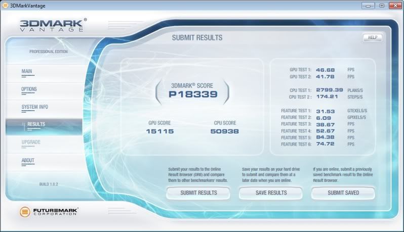

Test one - 3Dmark Vantage - Stock GPU
Test two - 3Dmark Vantage - Overclocked GPU

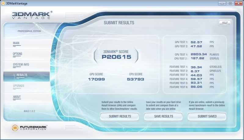

Killa.. I did not overclock it before I got the cooler. It was hot and loud enough as it was. Last night I reached 710mhz on the core with a slight memory overclock. TBH? I'm not about to push the ram any harder as if I was to damage the card then that would certainly be the way to go about it. What has been quite an eye opener is just how well this card responds to overclocking in benchmarks. When I overclocked both of my Radeons by a huge margin I got an extra 500 points in Vantage. With this thing? well, take a look at the Vantage scores progressively. First one is stock 604. Second one is 660 and this one is 710.
Even after three rounds of Vantage, two lots of 3DM11 and a run in Heaven it still refused to top 66c. Just noticed a pattern as it goes. Each 50mhz increment scores me an extra 1000 marks. That's pretty impressive !
