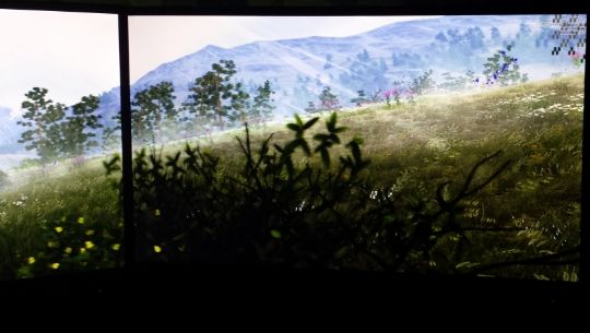

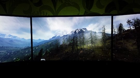

I settled down for a blast on Titanfall, and after about 5 hours, I started to get weird squares of colour, at first it was it was just around the outer edge, and within seconds it was appearing all over.
I'm running a pair of 7950's @ 1100/ 1250 under water ( I tried stock after the problem started ) It happens overclocked or not, and with +fire enabled and not.
The temps were all fine they didn't go over 40, and the VRm temps hover around the 31 mark, so I can't see it being temp related, then again I have no clue.
I thought it might have been artifacting, but the vids I've looked at, loo nothing like that. Any ideas guys ? Pics are from Valley, it does when any game or graphical things are on the screen, It has started to happen when I open a program like GPUZ, around the outer box it almost looks like black, and yellow chefrons instead of a solid colour.
