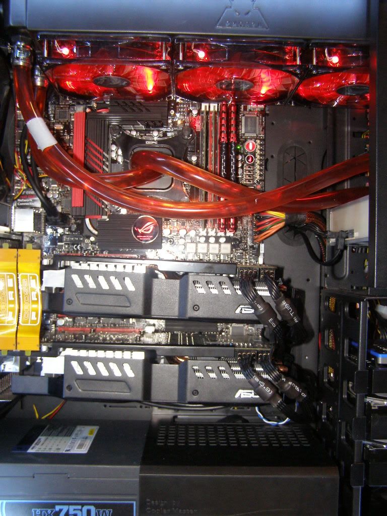

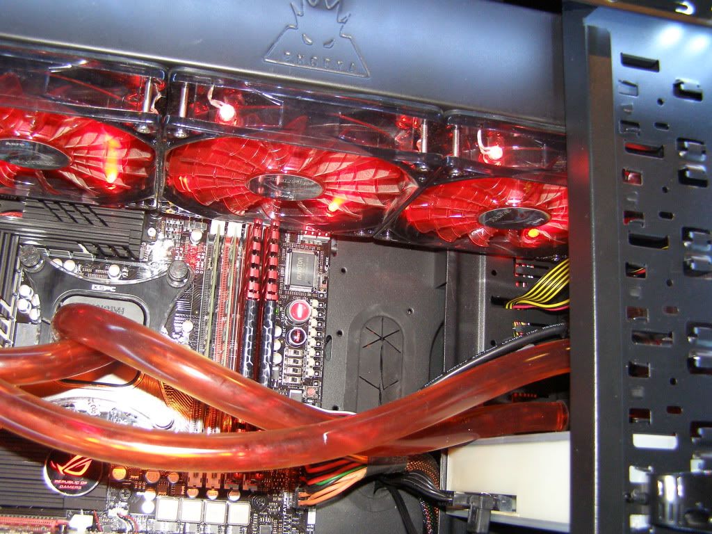

I've got mine push/pull and it's very very tight as you can tell from the pictures looking at the 932 seems you can only locate fans push, but my 8pin ATX connector is completely obscured by the fan, it fits and there's not a massive amount of stress on the cable but something to think about.

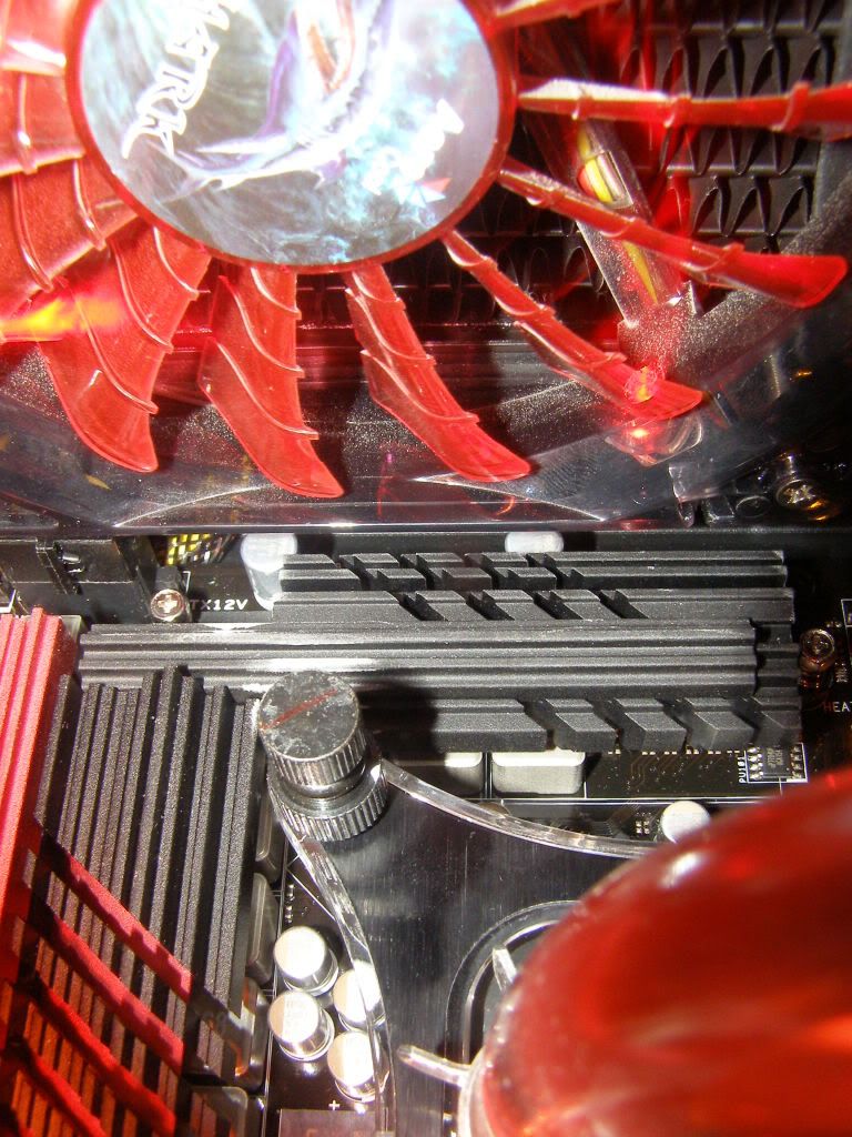

The block itself isn't overly complicated to fit, I got no instructions but I was already using a RASA block so it was pretty straight forward, I did have an issue (I think) with the back plate, on the Maximus Extreme there are a few SM resistors and Probe points on the back of the board which sit perfectly inline with the edge of the plate, it was causing my pc to stop immediately (fortunately not damaged anything) took me a while to find it having the board out on an air cooler fired up, put it back in failed. I covered the concerned parts with insulating tape and it's now not a problem.
A couple of photos of my rig installed.
Check out the droop on the 6950's.....................
Ignore the self amalg tape it's covering some weakness in the hose where a faulty exhaust fan decided to turn into a massive fuse. The resulting melting of insulation/hot wire has surface marked the tubing, I will replace it when I've got the hose i'm after.

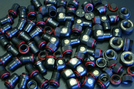

as i said not made my mind about barbs i was think these but cant seem to find them .

They're bitspower aren't they?
There are a couple of stockists, I think Tom did a build quite recently using those and he generally mentions suppliers.
Don't know why but I get the impression the o-rings are interchangeable.
OCUK carry them I think among others.

all i can find are the black and green o rings did't no they were changable
The red orings are the 'carbon coloured' ones the green orings are just satin black, once fitted you can not see it anyways.
