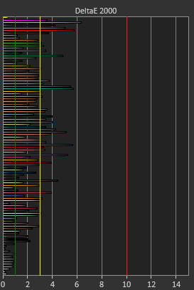

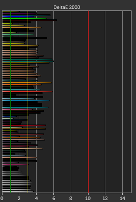

Ok, yes I agree that E30 is crap out of the box, but after turning off all img. processing and switching to true cinema mode (not gaming for some reason) lag drops from 55ms to 30ms, and ghosting gets better as well, color is bad out of the box as well and requires calibration (way too much blue), but after that I managed to get 97% of accuracy in ycbcr444 colour space which is about 96 in sRGB I'll attach my measurements, also on my tv there is pixel bleeding if sharpness isn't set to 0. Keep in mind that every screen is different even 2 screen of same make/model will require slightly different settings to produce accurate picture that's why use colorimeters, instead of copying settings from forums.
