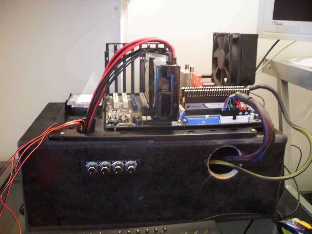

So I wanted a test bench to go with the new setup, But Didnt want to spend £100 plus on one SO i made one. Basic it is, But It works

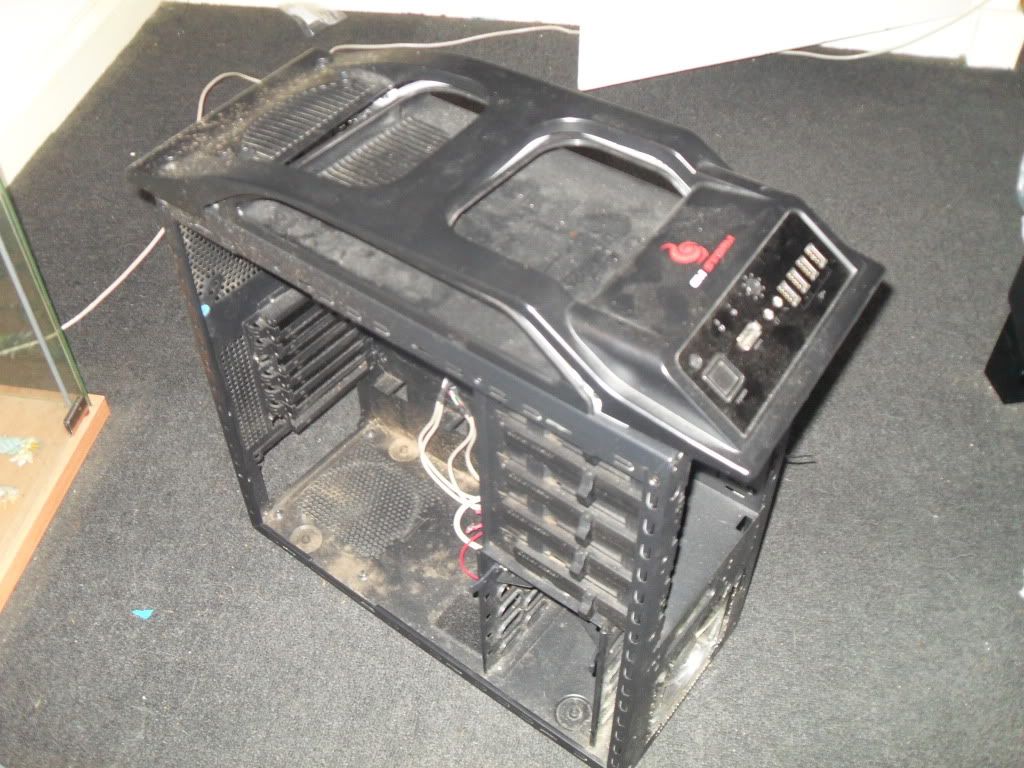

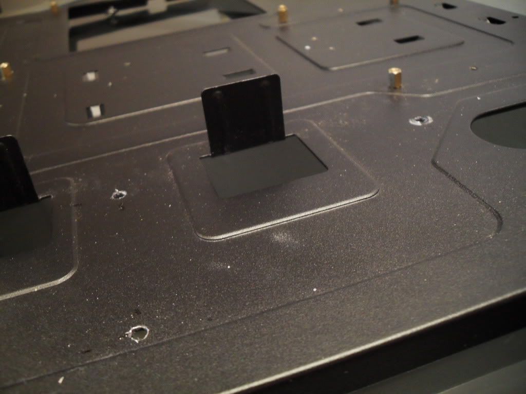

To make the benchtable I started out with an old case that had been chucked in the garage ontop of a pile of bumpers engines and and general other automobile rubbish lol.

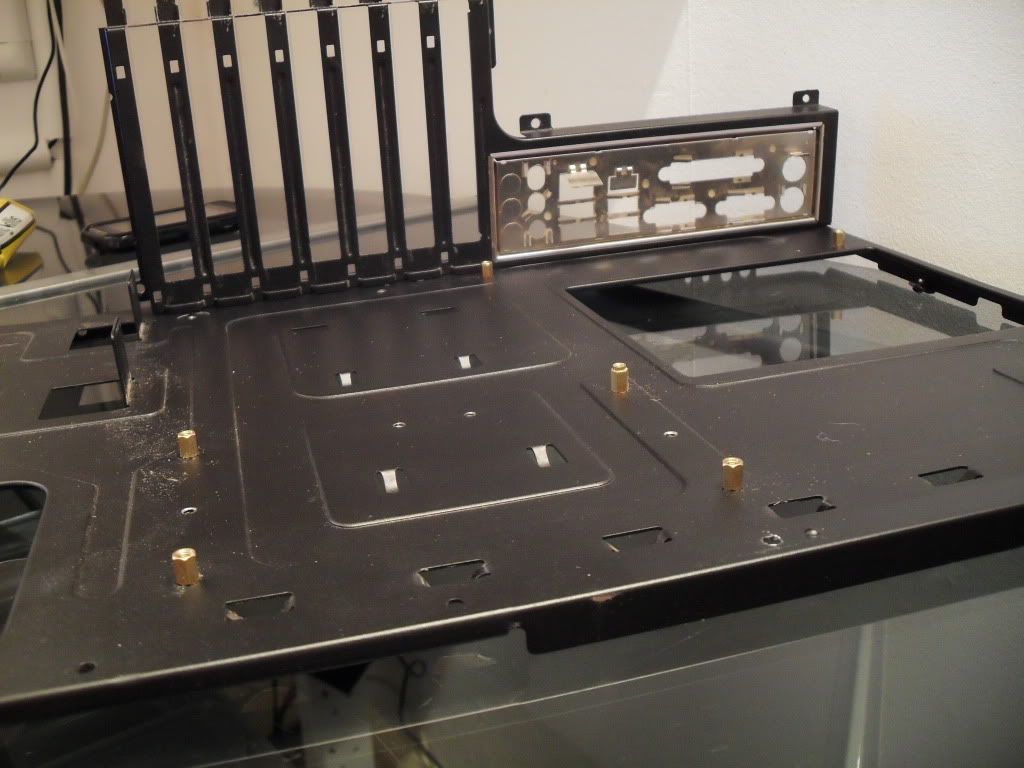

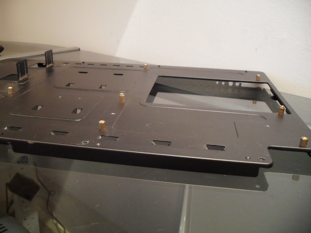

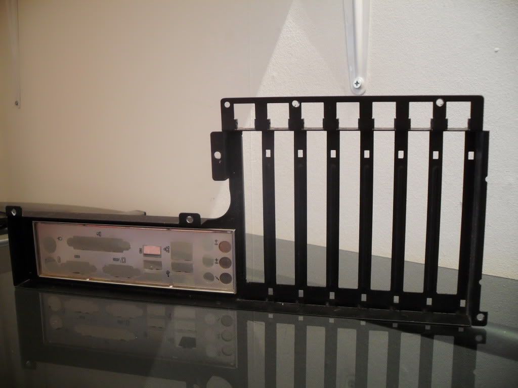

Next i took the drill to it and removed all rivets, After siffing the wheat fromt he chaff, I was left with a back plate and a motherboard tray.
so i riveted the too back togeather. to for a motherboard tray of sorts.

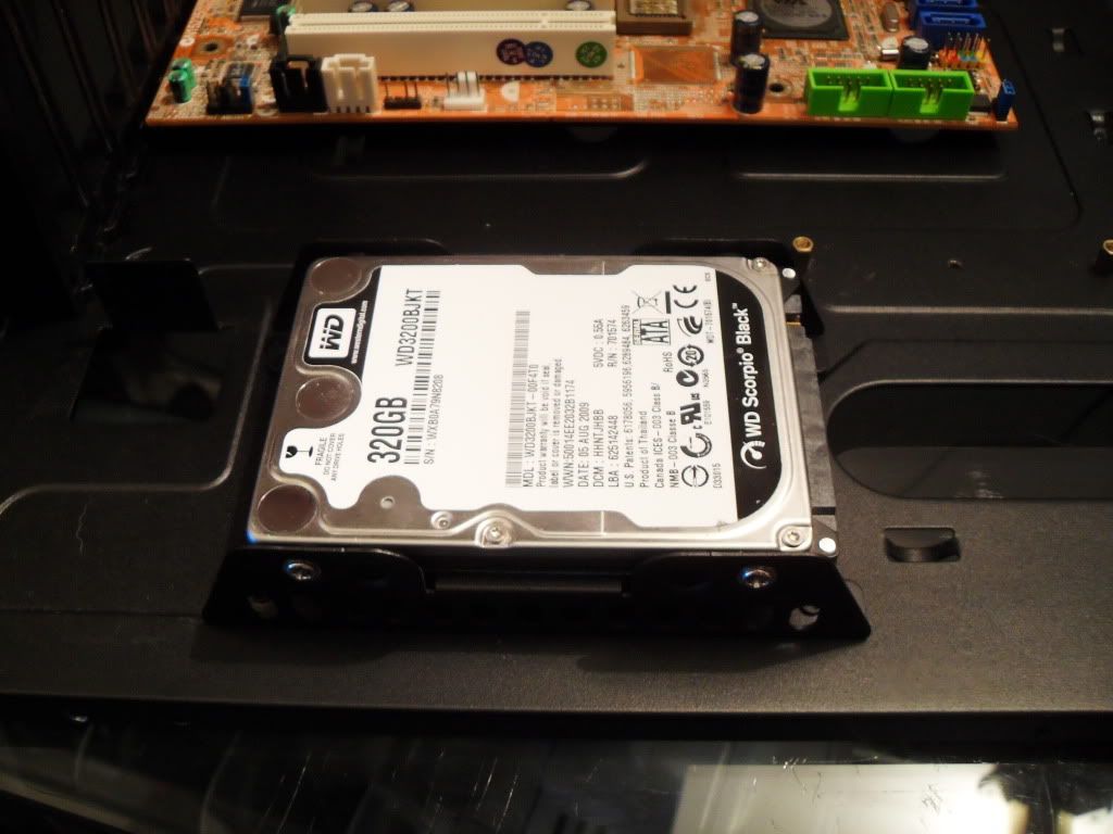

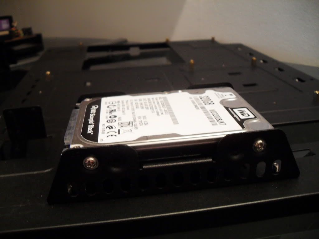

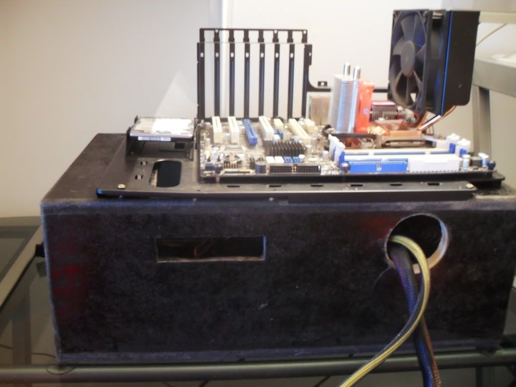

Next thing was to mount a HDD to the tray for easy access. So I used the 2" brackets from the case and marked some holes in witch to drill.
The I mounted the HDD brackets and HDD. Because the brackets are already threaded I just needed to screw through the underneath of the MB tray to get a nice secure fixing.

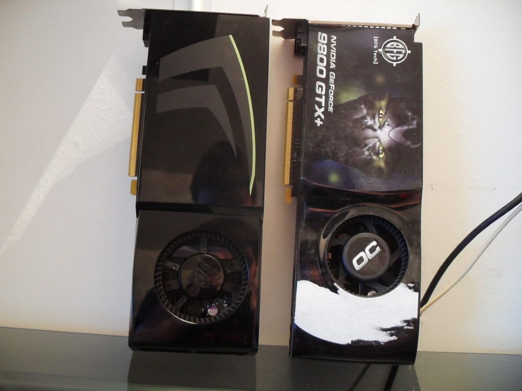

Next i needed a few random GFX cards. And to be honest after searching ebay I could not belive how cheap some of this hardware has become. For instance.
On the left A GTX 280 Cost me £25 works perfectly well in games, But for some reason wont fold
. And on the right is a 9800GTX + Cost me £15 posted off of ebay, And it works great and even folds nice too.

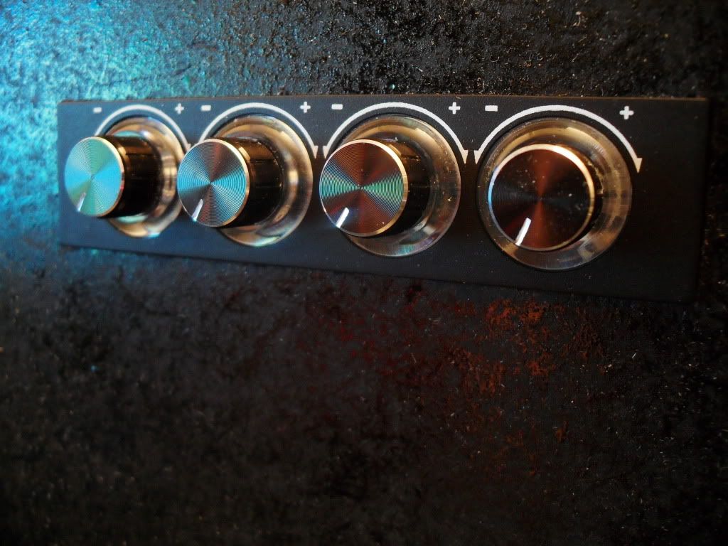

I then decided to beuil a stand as such for my MB tray so I could house the PSU and other gubbins. Also Got a Cheap as chips Fan controller so I can hook up more fans to the rig.
I Through some paint at the MDF tabe. And cut a slot on the top for wires a whole in the front for the MB powerconnections, And Also made a slot that will take the fan controller.

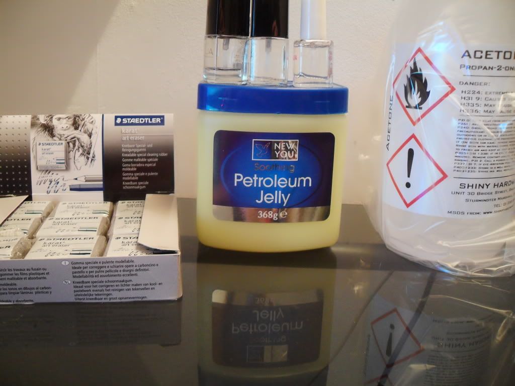

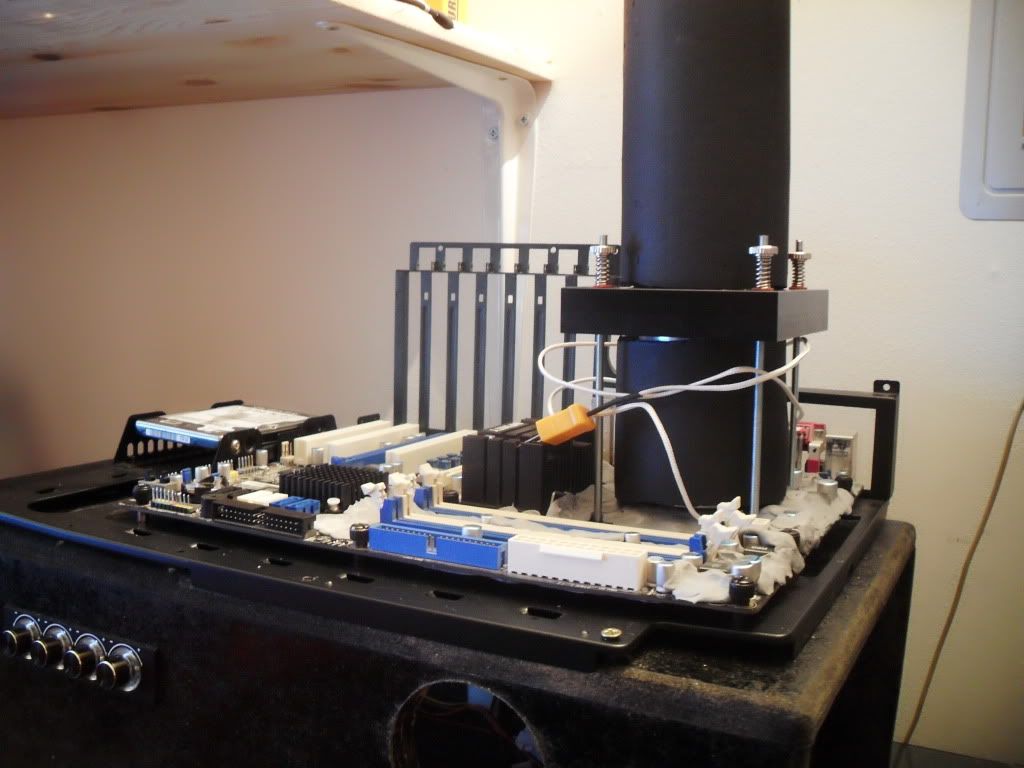

I also decided to get the MB prept for DICE cooling. So I got the misses to get me 3 pots of clear nailvarnish, and some petrolium jelly. Their was no way I was going into a shop to buy those items togeather thats for sure. I could just see the look on the face of the cashier as she is ringing that lot through. A big hairy Builder buying nail varnish and petrolium jelly......................Suits you sir.
Also grabbed some 100% pure acetone and a Large box of moldable Artist rubbers.

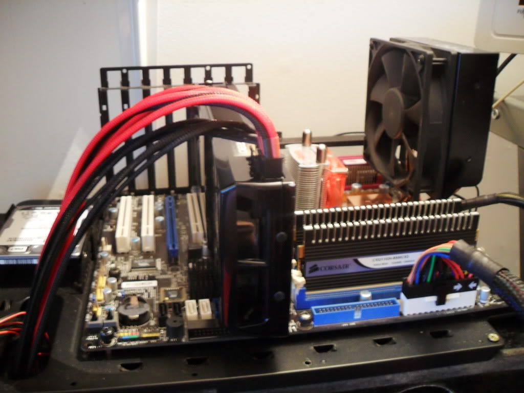

I had a quick go at some overclocking. On the stock ram I was only able to get 3.8GHz out of the chip. So I got anougher absolute bargain off of ebay.
2GB of Corsair Dominator Brand spankers in the packet. For £13 posted
I thought this would help with it being 1066MHz as I thought it was the cheapo 667MHz Kingston ram that was making me hit a wall. But I now think it is the terrible PC world esk AKASA cpu heat sink. And it is stopping me from raising the voltage And increase of .2v is too much for the heatsink to take.

The motherboard is also concerning. I have The latest bios waiting to be installed that unlocks the ability to use 45nm chips ont he boared. and also unlocks it so you can select more than 800MHZ for the ram, Not realy a big issue but could be handy. I am trying to use WINFLASH but when I select the bios to install it just says the bios size doesnt match. So I might have to purchase a USB Flobby drive from the bay of E.

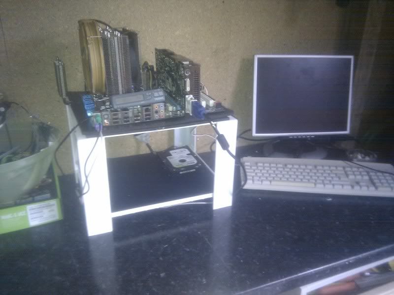

i didnt do many pics so i wont start my own thread (might do for the next one i build as i kinda want to change how i did it now xD) so i figured i would bump your thread cerb and share my new bench top thingymabob.
not the best looking in the world but its the right height for the head on this vapochill unit to touch the cpu, which is why i built it.
got my kit on it atm as i am going to have one last blast on air before i get chilly
thats a p45 ud3r, 2x2gb kingston t1 that are good for 1180 ish mhz and a 5ghz+ e8400
bench top just needs a colour now as thats only undercoated but idk what colour to go :|
