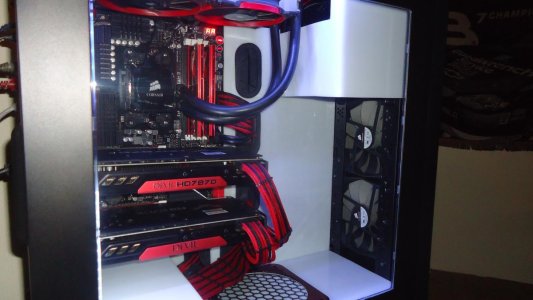

Looking Very awesome. How is the pump/res combo held in? Just fitted into the plexi bottom shield?
Love the plexi work you do. Do you have a pointer to some instructions or a tutorial?
--Rick__
I bolted it to the back through 2 layers of Plexi-glass.

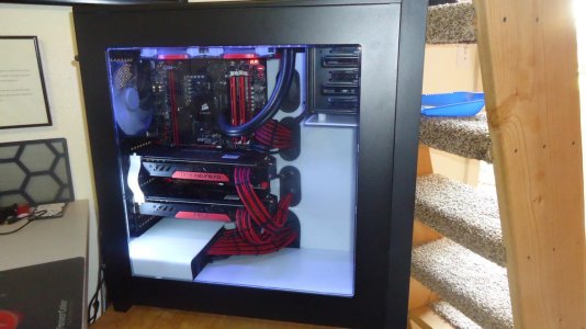

Updated/Rebuilt
I rebuilt the system and changed colors. almost done. Need a GPU block and a few minor touch's plus better pics.
he motherboard has changed to an Asus Z97 Pro with a 4670K.
Liking the gold that comes out of it it :) ... should be worth more than the components and the PC itself ^_^
I finished the back-plate and next is the block and into the loop. Maybe a second GPU? :D
