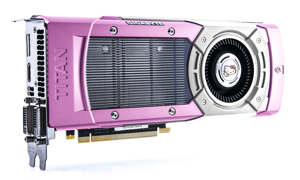

A blower card is able to exhaust its heat out of the case as opposed to slowly heating itself up because it isn't able to expel enough of it's heat (as non ref cards don't push heat out of the case).
A 980Ti with a reference cooler ( a proper cooler, not one of those s**t tier plastic blowers) at 60% fan speed is quieter than a non reference card running at 70-90%.
As previously mentioned as well your card won't fit that case anyway.
So you mean those titanium looking coolers I assume?...
