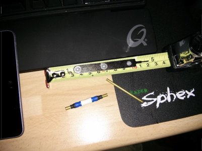

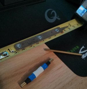

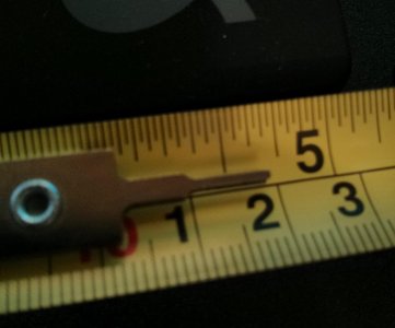

Could someone that has one please take a pic and add some dimensions to it?

Took some pictures for you, i don't have anything to hand for accurate measurements.

Thank you very much SuB!

How thin is the metal on the real deal? I was using 1mm stainless but found it too thick to go either side of the pins. Perhaps the cheapo power supply i was testing on is different than most? I cant imagine they'll be any strength left in the tool if the barbs are less than 1mm thick?
Chris.
its ALOT thinner than 1mm, i don't have the necessary tool, but it's extremely thin, like maybe as thin as an exacto knife's none sharp edge ?
Honestly it's fine for purpose but it won't last long if you try and apply force in any other direction than straight down into a socket.
Your psu isn't the problem buddy, you need the proper tool ;) These really are as good as it gets, and I believe come from 'molex' themselves
The metal seems strengthened at least a little, i really would save yourself the trouble, swallow the bill and get a proper tool if you're serious about it mate
