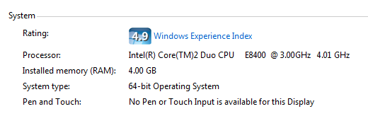

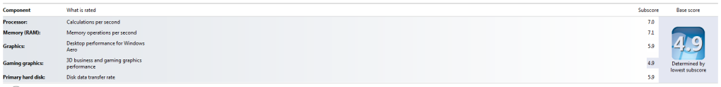

Hi, I seem to have a problem with my motherboard. It seems as if the PCI-E 2.0 slot has been throttled down to x1 instead of x16. I first noticed this by poor Windows Experience Index scores and slow FPS.

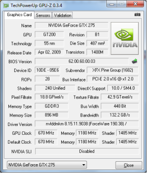

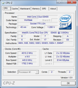

I am running Windows 7 RC1, which could be an issue. I can supply a link to my thread on the bit-tech forms so that may be some use. I have also attached a GPU-Z screenshot of my current graphics card, but I don't have one for the 8800GT, sorry. Other screenshots of Windows Experience Index scores and CPU-Z screens can been seen below as well. But please be aware that I'm not longer overclocked to 4GHz due to a CMOS clear.
Also both GPU-Z and Nvidia control panel says the card is functioning at 1x, but I don't have a screen shot of the latter. So any suggestions?
