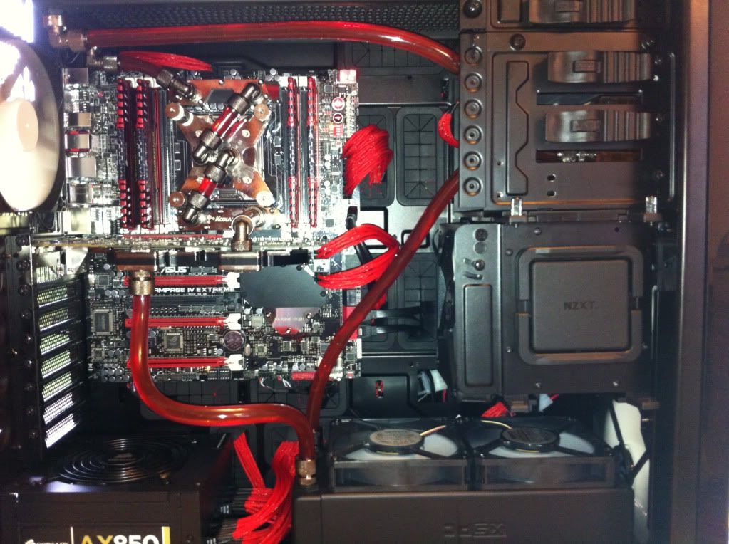

I just built a rig with a NZXT Switch 810 and Rampage IV Extreme. I put a 60mm rad in the bottom with push pull and and there is room. An 80mm should fit fine I reckon. Here is a photo to show the room you will have

Liking the looks, but that tube going diagonal up from the rad to the res keeps drawing my eye.
Any way to route it so it turns a 90 degree as per your other tubes?

Possible to use a 45 degree on the underside of the GPU and bottom rad? Also, how about a spacer on the bottom rad then a 45 degree off the port going to the res? CPU block going into motherboard blocks looks awesome.
