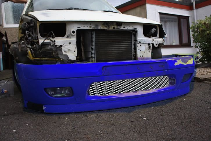

My VTR Project Log... yes, it's yellow!
Quick photoshop with white mesh:
I'd go for black mesh..or white because white will end up black with dirt anyway :)
I was meaning about the wheels being white btw, not the car...
Gonna go chav and do it white first, if it stands out too much I'll just spray it black instead!
*waits for insults to start* :D

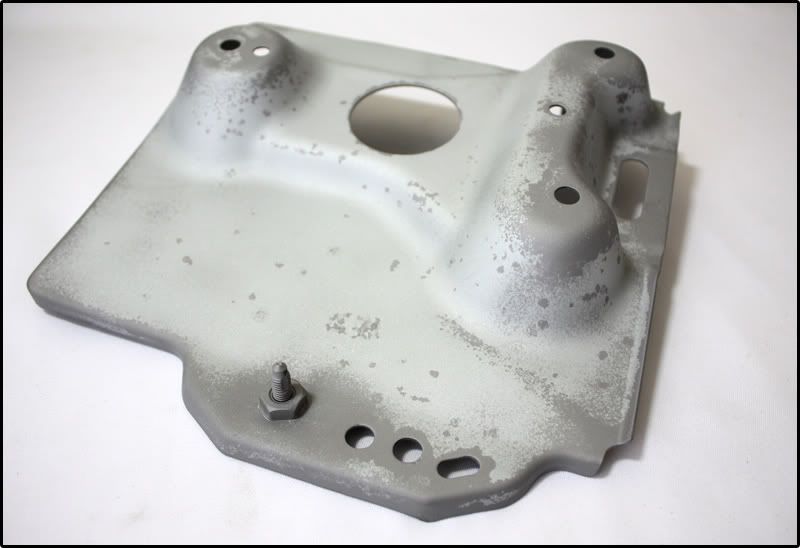

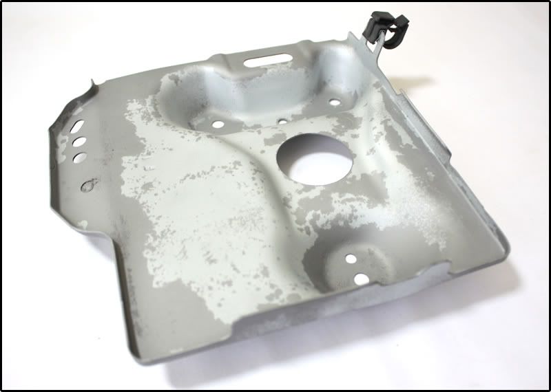

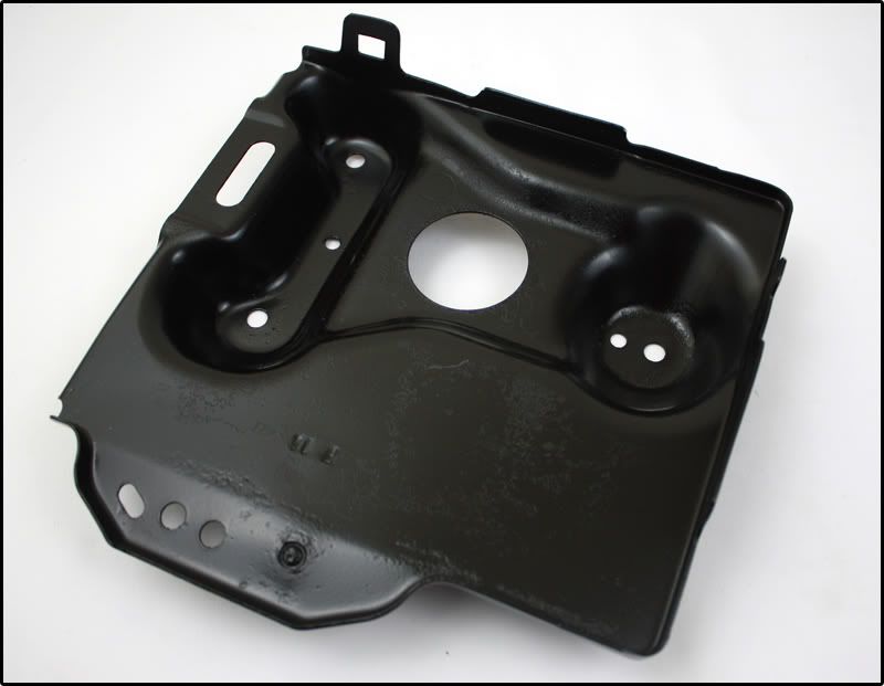

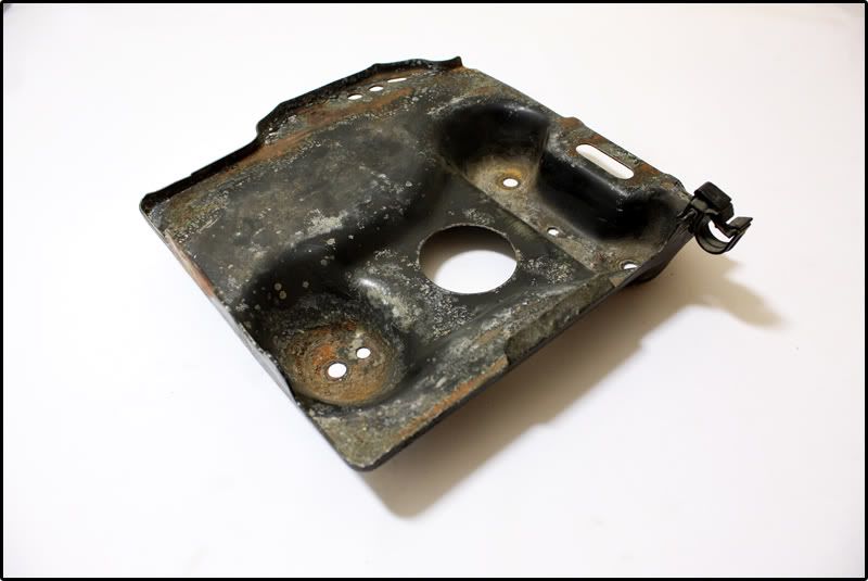

Next, removed the battery and battery tray, gonna blast/coat the tray and then i'm getting a battery box/cover fabricated to cover it all up and keep it out of harms way.
After vapour blasting
Thats gone off to be coated glossy black.

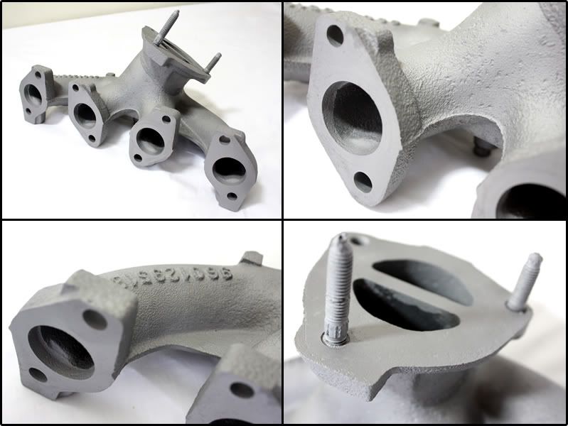

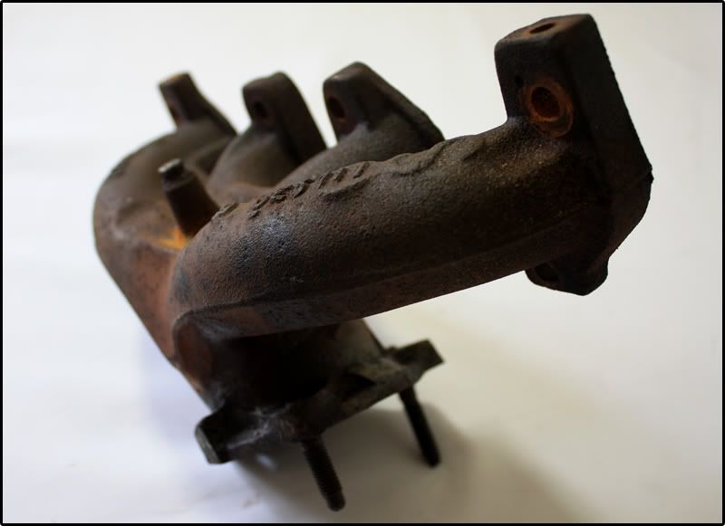

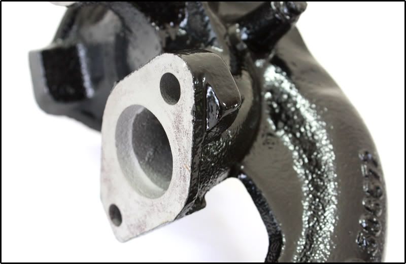

Whilst I've got the exhaust off i'm in 2 minds about blasting / high temp. coating the manifold in gloss black, any thoughts? :p

Having the manifold painted black will result in it radiating a fair bit of heat, although it will get up to temp faster. If you do it make sure you have a CAI or heat shield for the air intake. Personally I would find someone to do a ceramic coating in black, will keep heat in and get the exhaust up to temp pretty fast. Also worth giving the inside a good polish while its off to increase escape speed.

I had a look at getting it done in ceramic paint but I can get it done in normal high temp. gloss black for free so it's easier this way.
I'll give the inside a rub down once it's been vapour blasted, hopefully tomorrow evening.
The manifold heatshield has already been blasted and thats already at the coaters waiting to be done in the same powder.

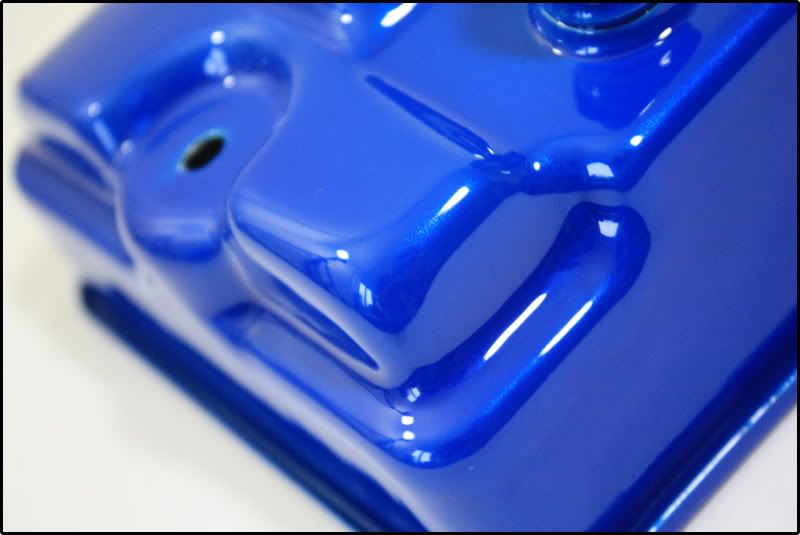

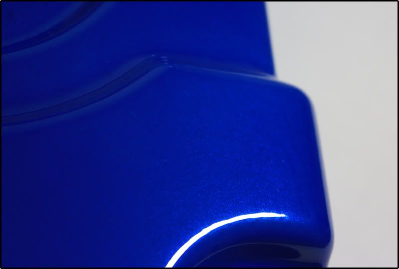

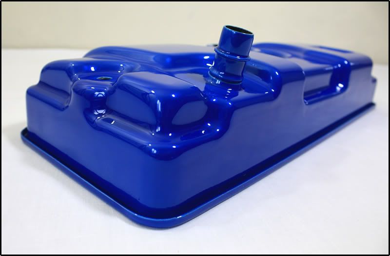

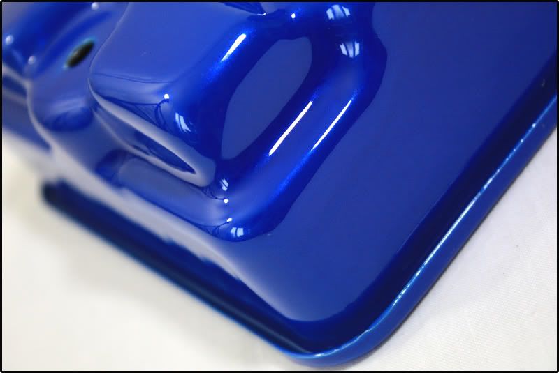

Ready for some money shots of the rocker cover...? :D:D:D
Silver base coat with Blue Candy shot over the top of it.
WOOOOOT! :D

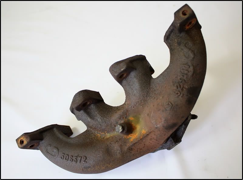

Manifold removed
Manifold back from being vapour blasted, came out really well! :D
Also got the ECU tray and a few other misc. pieces done at the same time:

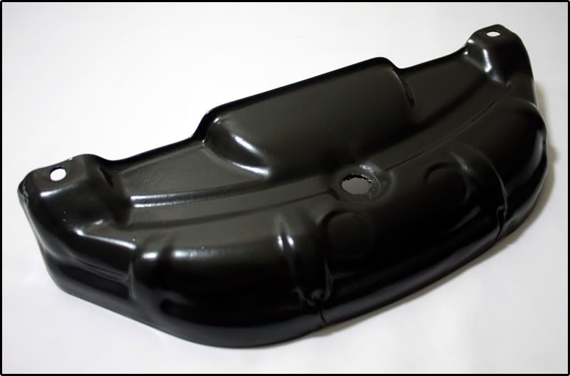

High Temperature Gloss Black Powder... DONE!
Got the heatshield / ECU cover etc all back as well but pics to follow. :)

Something reacted with the powder, possibly silicone by the looks of it, not to worry the battery sits on top of it anyway, it stills looks a damn sight better than it did previously.

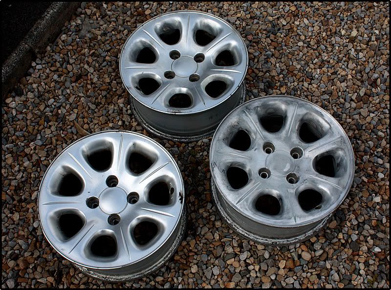

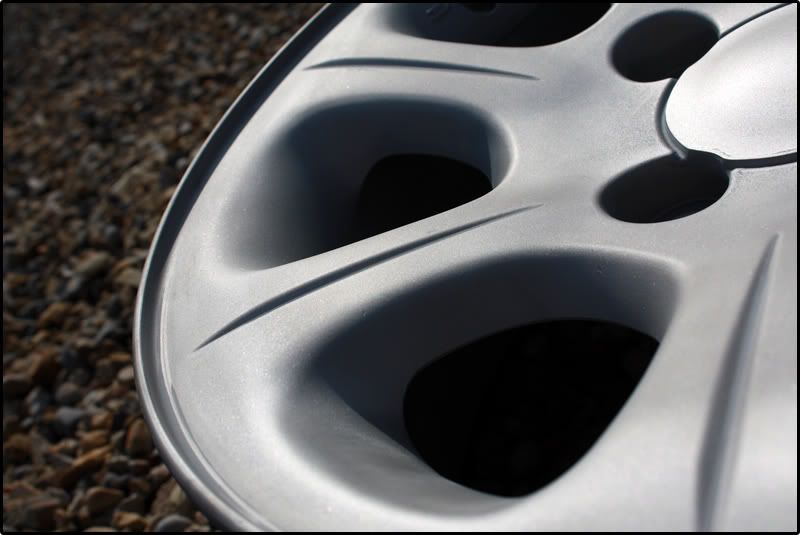

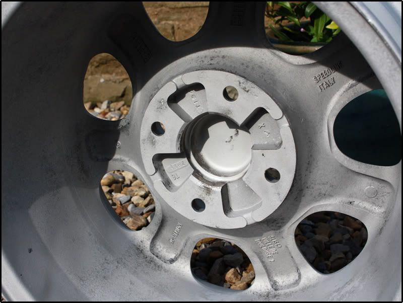

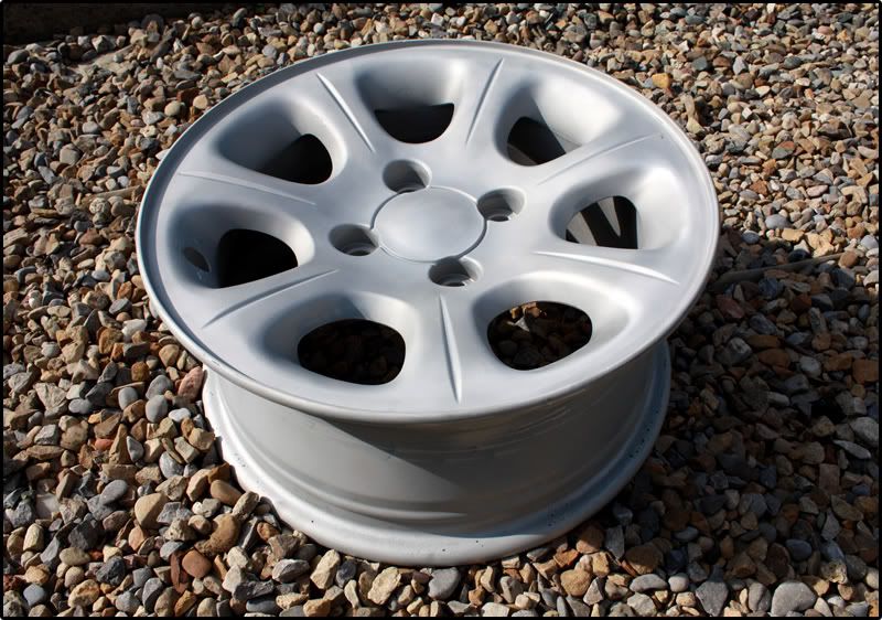

Took the rears & spare to Kwik Fit and got them to remove the tyres, so this is the alloys prior to any refurb work.

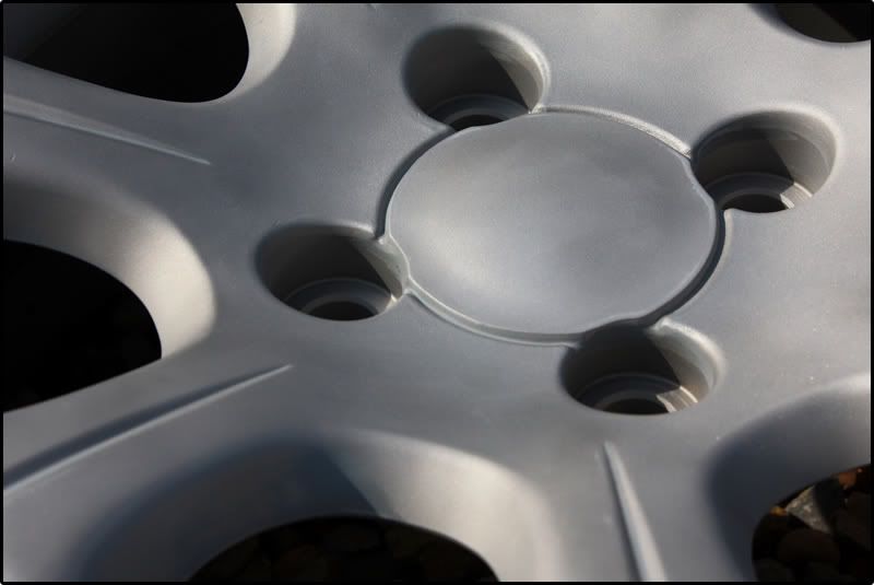

Back from being vapour blasted...

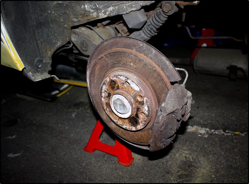

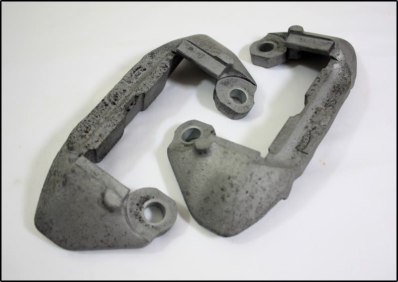

Whilst the rears are off we made a start on the brakes.
Check the discs & pads, remove the calipers & swap over the brake hoses.
Calipers are being done in Candy Blue like the rocker cover, need to order in some powder and get a few bits together to do at once though.

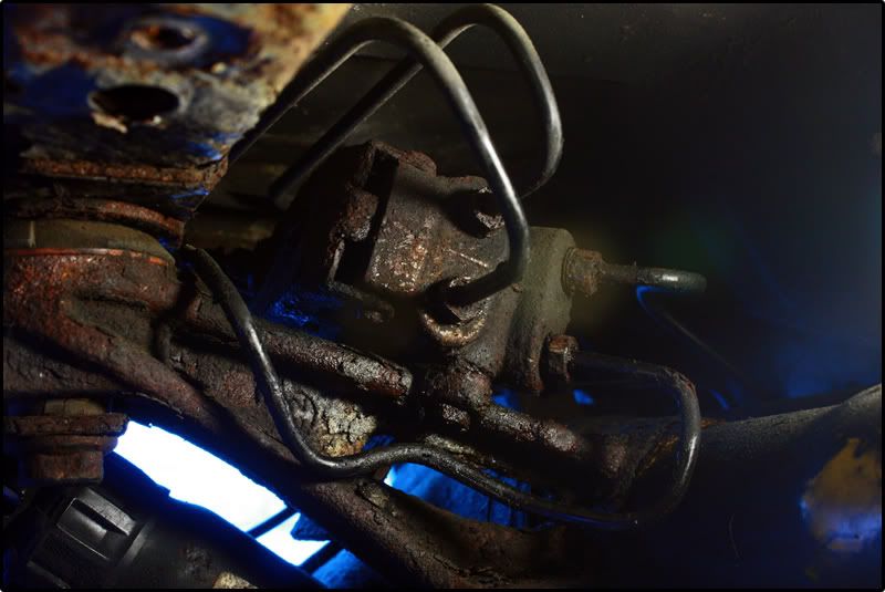

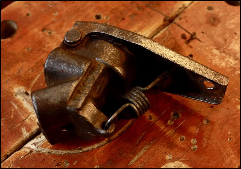

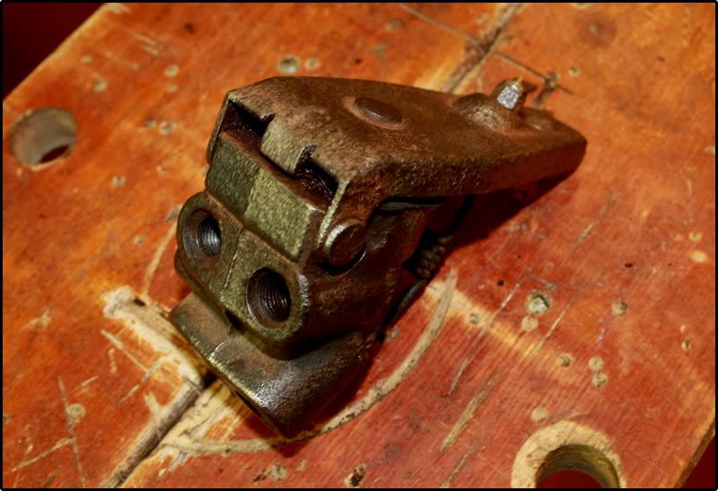

Finally, this has been a massive ball ache... it's the load compensator for the rear brakes, it had siezed up & as a result there was no power going to the brakes.
Absoulte mare to remove, was close to rounding off the nut heads! :(
Finally got it off & used a BFH to free it up and then wire brush attachment to remove surface rust.

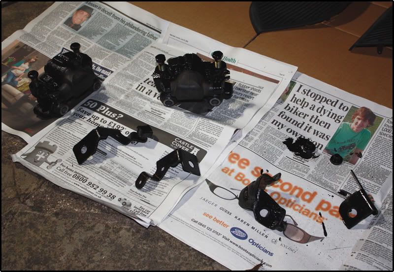

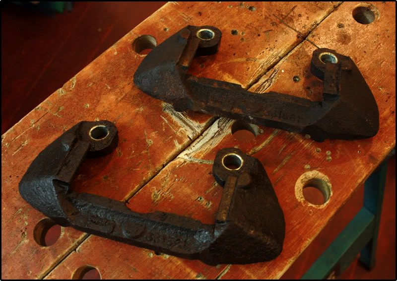

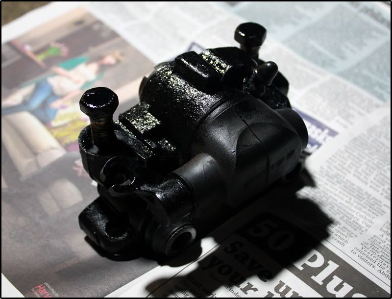

Last nights job, cleaning the rest of the calipers & changing the brake hoses.
After much ****** about trying to get the hard brake lines off, we finally managed it and removed the brackets which hold them as well.
Left it all in diesel to degrease them then painted them in some Satin high temp. paint, looks tons better now!!

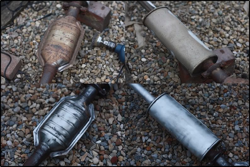

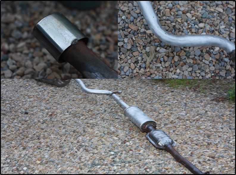

Lastly thing, removed the exhaust to find where it's blowing & cleaned it up with the wire brush, think I'll throw some high temp. black paint on whilst it's off.

Have also decided what colour to do my wheels, Sparkle Silver base coat then a Black Chrome shot over the top.

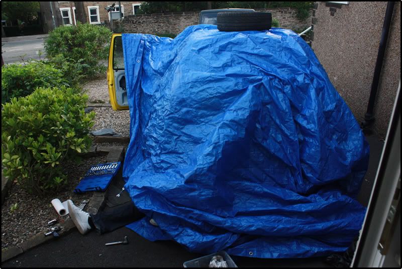

and for novelty purposes...me dead under the car it seems! :o:o:o
