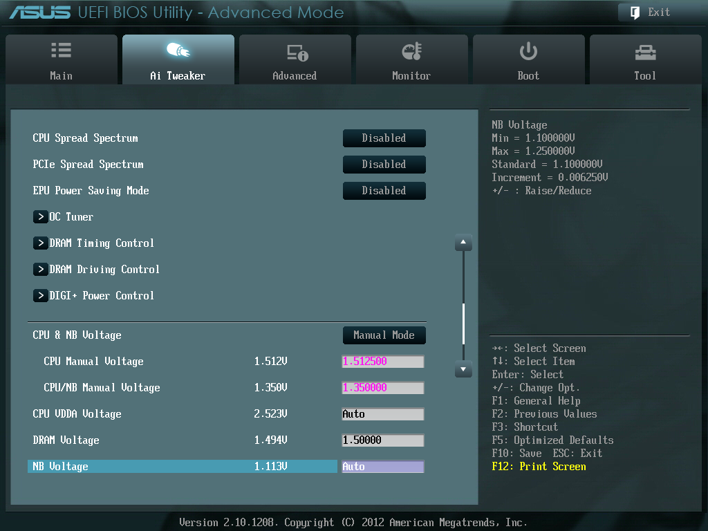

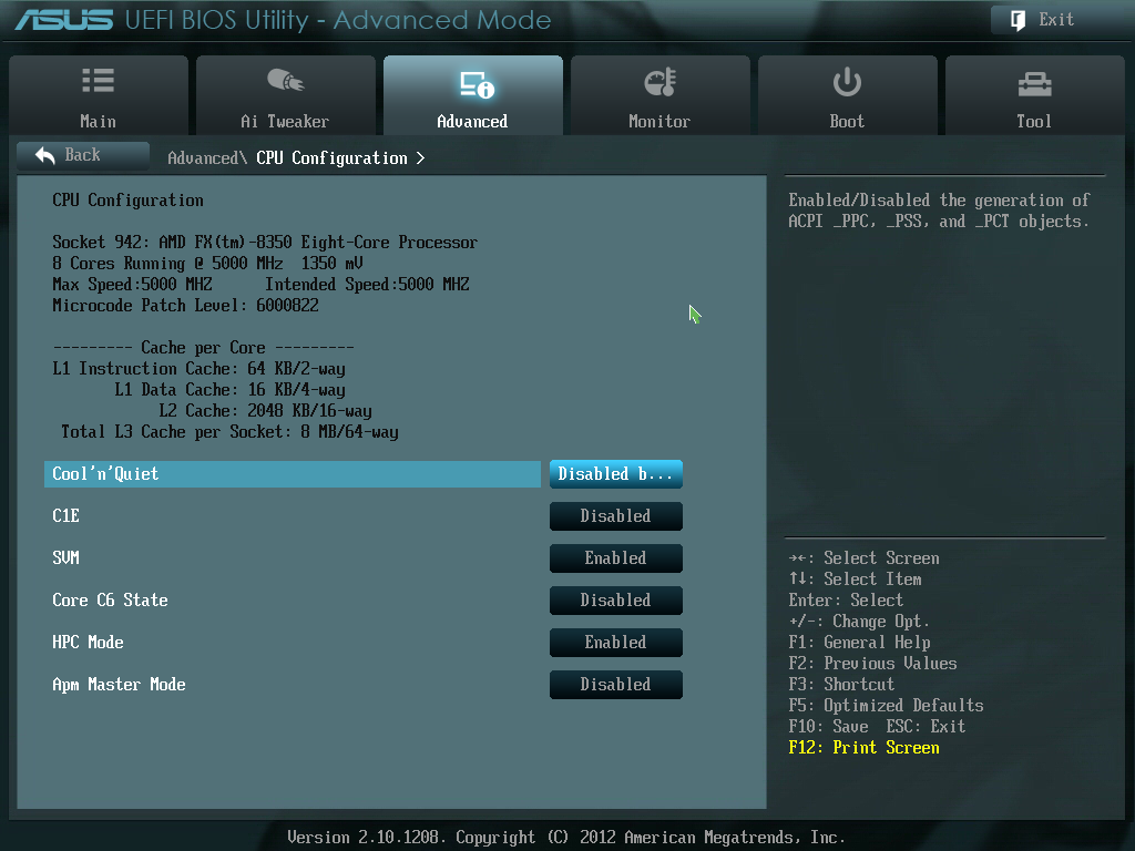

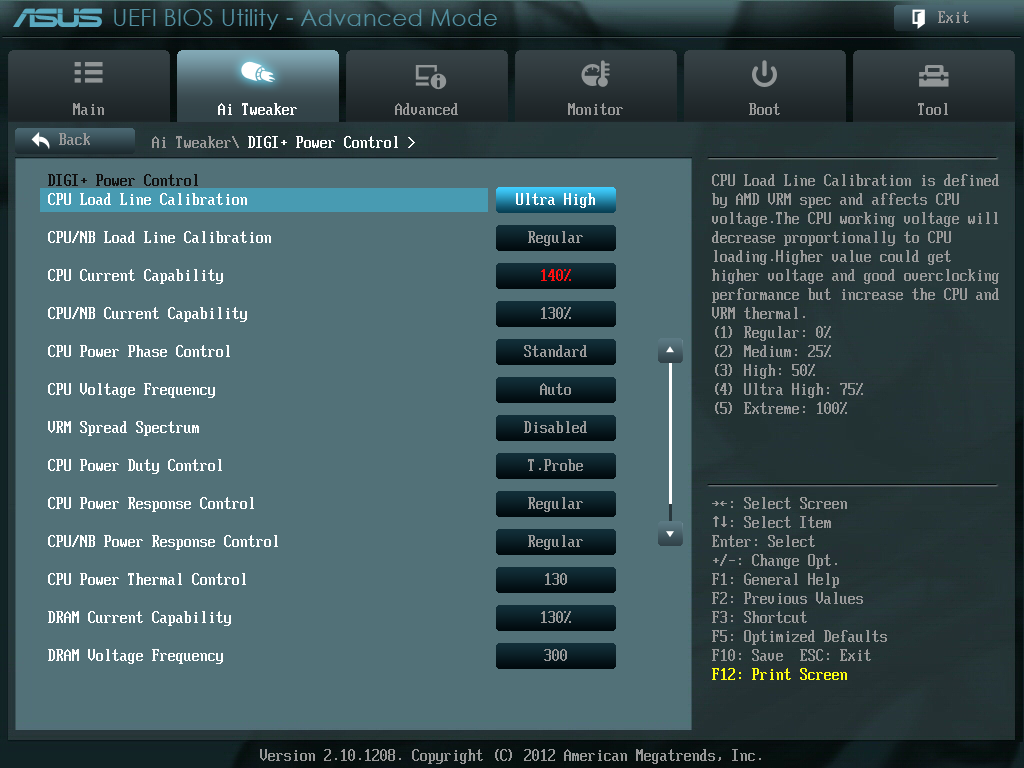

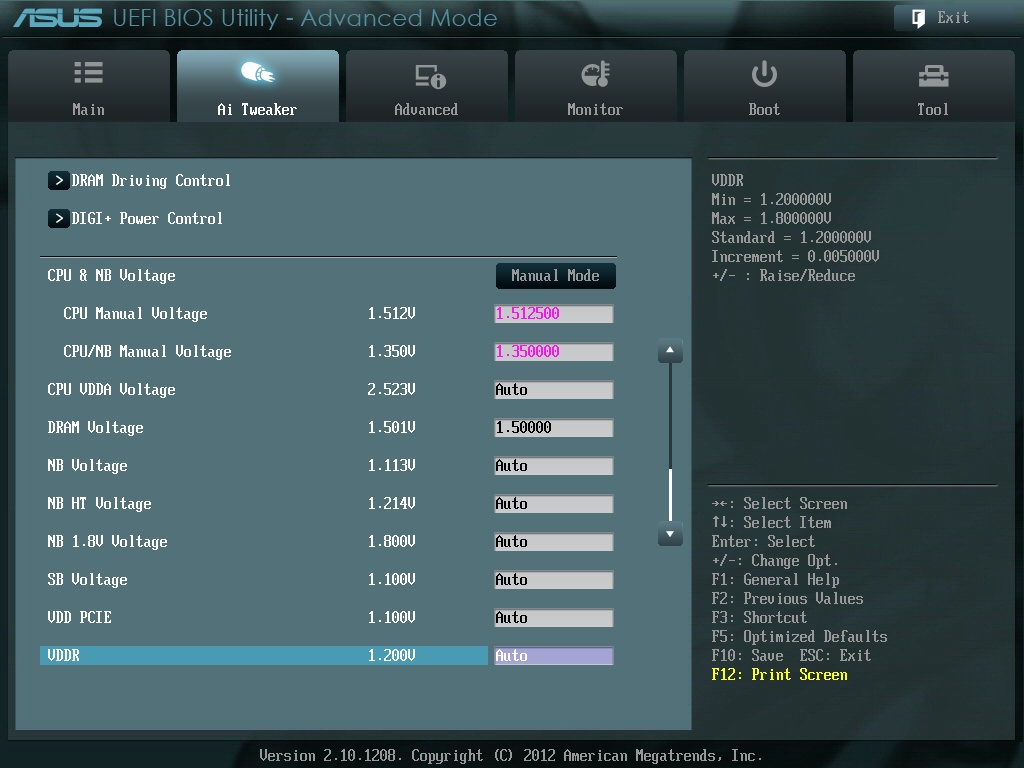

Heya everyone,
Figured I'd post my UEFI Screenshots below in an effort to help those on the road to 5Ghz with their AMD FX 8350:
My system specs as follow:
AMD FX 8350 @ 5Ghz
Asus Sabertooth R2.0
8GB RipJaws X 1600Mhz
MSI 280x
Toughpower 1200Watt
Custom Watercooling Loop
My settings:

1.51v on the CPU you really are on the ragged edge of that chip, what's your temps like? does she run nice and stable under stress?
Seems you got your self a lotto winner if its stable.
Great job :)
Somewhat ragged, Had 1.6v @ 5.4Ghz trough it a few weeks back but didn't dare do anything stressful on the chip.
Depending on ambient and fan speed I get about 54 to 55c (Under stress testing) So under the 61c max safe limit. Yes, all running stable here! To be fair, I could probably do with some better RAM. I may go down the 1 DIMM route that should hopefully be less stressful on the IMC and thus allow lower vCore.
