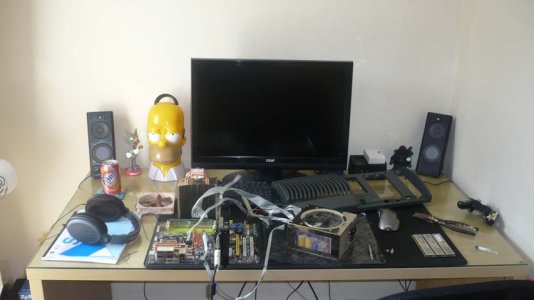

Well it would seem that while moving my setup from my old case to my new Coolermaster Dominator that i've somewhere along the way killed the mobo.
My guess is that something shorted it as it was quite a tight fit into the case - i've since done a bench test and the board still wont post, just powers on all fans and gfx card fan then cuts out - so looks fryed :(

Also on a side note any thing i should try with this dead board to really confirm its dead? I've try'd another CPU in it and it does not do anything i've also tryd to differnt PSU, one brand new that i also swapped at same time as the case (Hiper 680w Type-R II 8xUSB Jobby)

Edit: Add picture of the zombie board, had to rip front of old case off so i could have a speaker to check for POSTing as new case dont have one :S also never like using screwdriver to start systems up!

you sure, you have tried resetting the bios, take battery out for a few mins just in case, well the usual...
Yep been though all that and it does not post at all, just power cycles then restarts.
