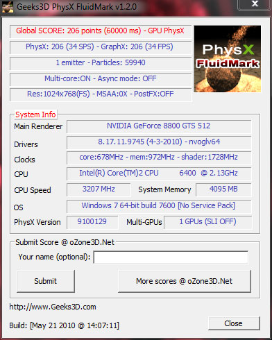

Now for the acid test. It's now time to see if Physx is actually working and making a difference. In order to do this you need Fluidmark. It is similar looking to Furmark in ways, but tests the Physx capabilities of your card. Please remember we are not doing this for bragging rights or high scores, merely to see if Physx is alive and well. Apparently when you run Fluidmark with a Hybrid Physx setup the scores are all out of whack, so as I say, don't do this for bragging rights !
Load Fluidmark up and run it. A screen similar to Furmarks will open and look like this.
TAKE NOTE OF THE GPU IT IS USING IN THE MIDDLE OF THE SCREEN - It will be your Nvidia one
It should also say "GPU2" Your results will look like this, which can be confusing. Note the only card mentioned is my Radeon 3870x2 yet, all of a sudden I have a Physx score and results
If you like you can also take heed of the score my 8800 Ultra is whacking out from the FRAPS FPS counter. 35 FPS is just about scraping on the kind of onions we like to peel. This is why I totally agree with Nvidia when they say it's not really worth using less than a 9800GTX or 260 series GPU for Physx.
