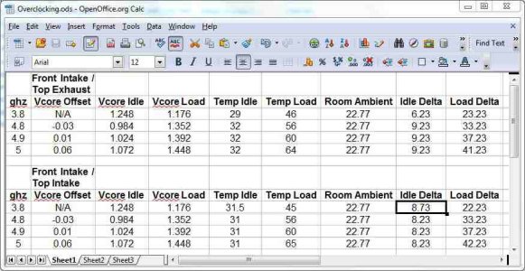

The second question is not quite as easy to answer. First let me show you the comparative numbers at 3.8ghz, 4.8ghz, 4.9ghz and 5.0ghz.
The tests were run with all fans and the pump churning full speed. The first thing that surprised me was how for the most part, temperature deltas between the two fan mountings were small or non-existent. The idle deltas with intake when overclocked were 1C lower for all three multipliers. On optimized default stock speed the default was actually 2.5 degrees higher on intake. On load (prime95 blend) the stock clock ran one degree cooler on intake, 4.8ghz and 4.9ghz were unchanged, and 5ghz was one degree higher.

It's probably invalid to generalize the data to other setups with different cases, fans, radiators etc. For those using the same or very similar setups, intake or exhaust on that top radiator will make minimal difference in cooling performance. I'd speculate that in this case there is some offset from the theoretical gain of passing colder outside air through the radiator rather than case air. By having positive pressure in the case there is probably some resistance created that decreases what might have been a gain. Also, an additional air filter adds resistance. The net is pretty much a tie as to either method.
