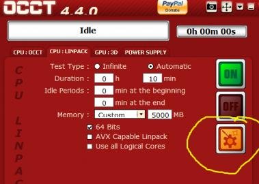

I allowed the heatsink to lift slightly while i was awkwardly trying to get the screws back on, i suspect this made bubbles. corsair link tells me the h80i isnt going over 24 degrees while the cpu is at 50 deg
(edit- this is a big improvement over failing the occt tests before)
should i try again? tips? (eg if i should wait before trying again or whatever, if i should do it differently?)
