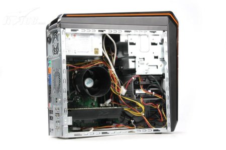

Fan at the front should work, yes. Do you happen to have any internal pics? :)
"internal" ;) from google i can see two types 1. that is mostly black and a bit of orange 2. front panel just an orange cover that you have to slide up.
only inside picture i can find is attached.
i hope inside is nothing like this one lol

The 'grill' sort of thing at the front makes it look like it could fit a fan, but looking at the front panel, I have no idea where the airflow would come from:
I don't think it's too bad though. You do have slightly positive air pressure which is a plus. With pre-build machines the chassis may look all flashy and cool but the truth is that none of them are going to be great cases (for airflow or expansion).
If you really want to fix your temps you'll have to either mod your Acer case or buy a new one and throw your hardware in that.
it looked like that before i fixed it now it's more tidy:)
PS: +1 For Adept (As long as you mean the Adept I'm thinking of ;))
well the airflow from the front would come from the bottom and i don't really like the ide cause of dust maybe should find some kind of filter or maybe do like you said buy a new case maybe a lot better:)

I suggest upgrading the case. Not only will it look and be much higher quiality, it will also allow you to upgrade in the future.

Idk man, even the bottom looks pretty closed to me. Not a lot of air that would even get through there. A new case would be best.

They ship it out like that? Damn lol
You'd be surprised of how most manufacturers ship out their pre-built systems :s Acer definitely deserves Tom's n00b badge :lol:
