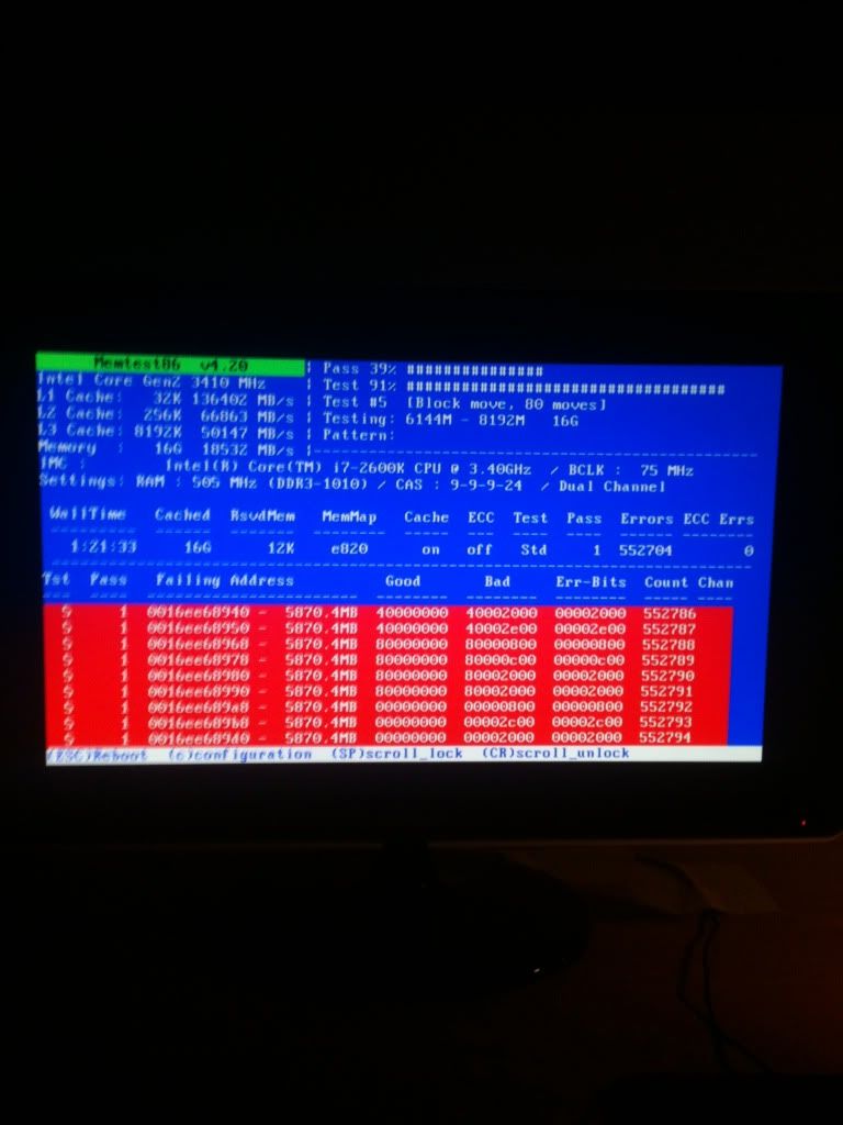

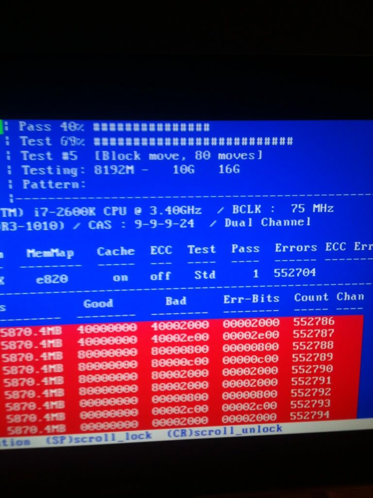

Got a bit of a update after running memtest. It's the first time I'm using the program so I have a few questions about it.
Does this program have a end time or does it just keep running and testing? (I had it on test for close to 1h 30 mins).
It looks like the cause of my instability is the memory from the pics. Surely I should have no errors.. right?
Seeing as my motherboard is dual channel memory I should of only had 2 sticks from day one? correct? Is it normal for memory to not be stable from filling all the bays on the motherboard with memory?
Should the memory be placed in the 1st and 3rd bay (starting from left going to right)?.. to have it running properly
Cheers
No, the board should be able to have all 4 DIMM slots filled, but Sandy Bridge's Memory Controller was never all that good at having 4 sticks of RAM.
Try running memtest for 30 minutes at a time, with only one of your DIMMs installed - try and see if there's a faulty RAM stick running aloof.

Ok, I've checked the bays I'm meant to be in. As far as running memtest I should be coming up with 0 errors right?
Update.. It seems like there was a fault in the memory, I now have 2X4gig put in and it passed memtest. I then ran intel burn on maximum and it passed aswell!. I tried to run intel burn on maximum and then it's extreme setting (right clicking on start) but it froze up. Could this be because I only have 8gig of memory on the computer? or because I have air cooling with a 4.5ghz @ 1.4V overclock? when passed my maximum intel burn test the temps got as high as 75deg.
