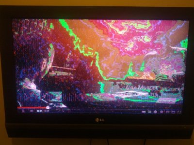

Okay, I am kind of worried right now my PC has done this 3 time now I'm not sure what is happening
Once randomly at the desktop while browsing youtube ( Colours went all crazy but after 3 seconds my computer went back to normal and startred responding again )
Twice while full screen watching youtube ( Crashed my entire PC )
All happened within the past 5 days
My temps are all fine and dandy, I have a 600Watt PSU Bronze 80+, so not a power issue ( From my knowledge anyway )
Help I think it may be my GPU dying?
Or flash just crashing?
NVIDIA 296.1 Drivers
The uploader wont allow me to post a picture
Ill resize the pic
might sounds stupid but did you check all the cables are fine?
such temporary artifacts cant really be a gpu dying issue
Try wiggling the cable connected into the back of your GPU / monitor, whiles looking at your screen. If it flickers then it's either the GPU port / cable. (unlikely to be monitor port)
The 6 Pin cable was very stretched, it's not long enough. I'm Going to buy a new PSU that will have adequate cable length for my NZXT phantom
Thanks for help!
