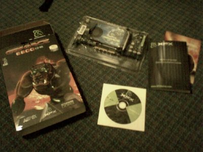

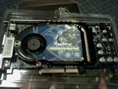

Just bought this card, heres a few piccies(sorry about the low quality, was taken on my phone.) Was bigger than i thought it would be, only just fit in my pc!
Havn't really had much chance to test it out but for some reason since installing it my pc seems like its running slower.
