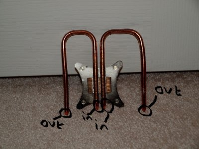

I chiseled the block to lose the heatpipes soldered on there.
I sanded the heat-transfer surface with my belt sander, I'll probably add some more solder and make an even surface.
I re-used the heatpipes and made two inlets and outlets, I will probably need to cut them even more though.
The diameter of the heatpipes, hopefully it provides enough flow.

could you not of suse the block as it was without the fins,so goin in from the bottom pipes and out from the side pipes?
but this looks ok man waiting with antisipation
There would have been nowhere for the water to exit and complete the loop.
it could of exeted out the sides

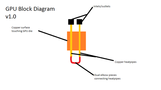

Elaborate, please.
This is not a conventional block, seeing as I do not have the proper tools to cut a piece of copper to size. Basically the water will be passing through the heatpipes to transfer the heat from the block directly soldered to the piece of copper touching the dye.
Here is a diagram. (attached)

shame cos that would of worked quite well i think,but yes they pipes have gone now.
but i would use the same kinda idea
The main problem is that the copper heatpipes bend with little force, and I feel like they would kink in that fashion. It also doesn't look as refined as what I plan to do.
Thanks for bouncing some ideas off of me though, please proceed doing so!
Actually, I may change those heatpipes out for something meatier, seeing as tubing that small will not transfer heat all too well.
I may have to make something, or I will look around in the hardware store/house for usable pieces.
Theres not going to be a large enough contact surface with the actual block matey, just a pipe wont cut it with the heat a GPU produces.
